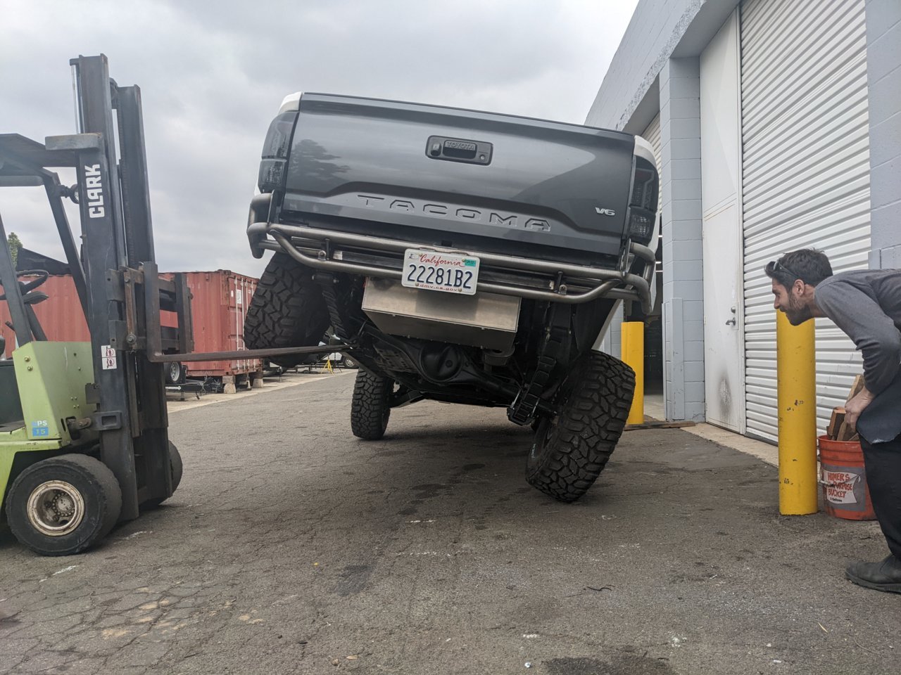

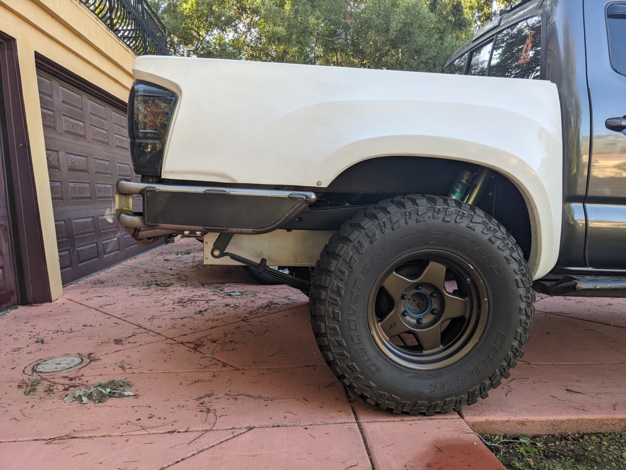

    @herrindude I've got a 25gal aux tank that sits where the spare tire would go. It's a solution that boxes the frame in to create mounting holes for the tank. It pumps directly into the main tank with a switch. It's balanced since it sits in between the frame rails.

    zcweisman
    zcweisman Well-Known Member
    Aug 7, 2016
    #193999
    654
    Zach
    San Diego
    2016 TRD Off-Road 4x4 MGM, 1993 FZJ80 Land Cruiser
    TRD CAI Magnaflow Catback Exhaust - Chopped OVTune 2.0 Beta 25600 91 Nitro 5.29 Gears TRD Pro Grill Raptor Lights Mod Hondo Vent Mount Hondo Radio Knobs Cobra 75 CB Radio Firestik 3' Antenna Gobi Ranger Rack Leitner Designs ACS Classic SwitchPro 9100 Baja Designs S8 30" Baja Designs Squadron Sport Amber Driving/Combo x2 Baja Designs Squadron Sport Amber Wide Cornering x2 (fogs) Baja Designs Squadron Sport Spot Ditch Lights x2 Baja Designs S2 in backup light positions (scene) x2 Baja Designs S1 (scene) x2 KC Hilites Chase Bar SCS F5 Matte Bronze 17x8.5 Nitto Ridge Grapplers 285/70r17 LR E Tepui Autana 3 FOX 2.5 RR Front and Rear 700lb, 14" Eibach Springs Dakar leaf springs + 2 AAL C4 Hybrid Bumper C4 Sliders C4 HC Rear Bumper w/Swingout RCI Full Steel Skid Plates Recovery: VIAIR 400P Compressor Smittybilt 9K Gen3 Winch Maxtrax 48" Hilift Shovel Assorted straps

    It looks like you're configured for driving at 40-60mph across roads and flatter stuff, do you have any clearance concerns? Did you think about a skid plate of some sort?

    Don't let how much it hangs down deceive you, the bumper is super high clearance. I also have a shitload of travel on the rear end. The tank is also wrapped in a stainless steel case so it's good to party.

    So they sell the mounting hardware and plate and have sourced the tanks that fit. Then the plumbing is on you, right?
    How did you set yours up? I was thinking an auxiliary pump on a switch in the cab that backfills the OEM tank would be slick.
    I'd be really curious to see how the clearance looks with a stock bumper. But I get what you're saying about the high clearance bumper gives the illusion that it's lower than it really is.
