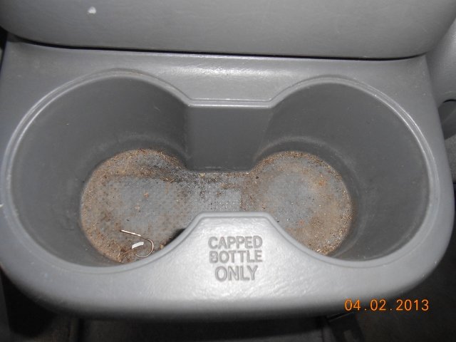

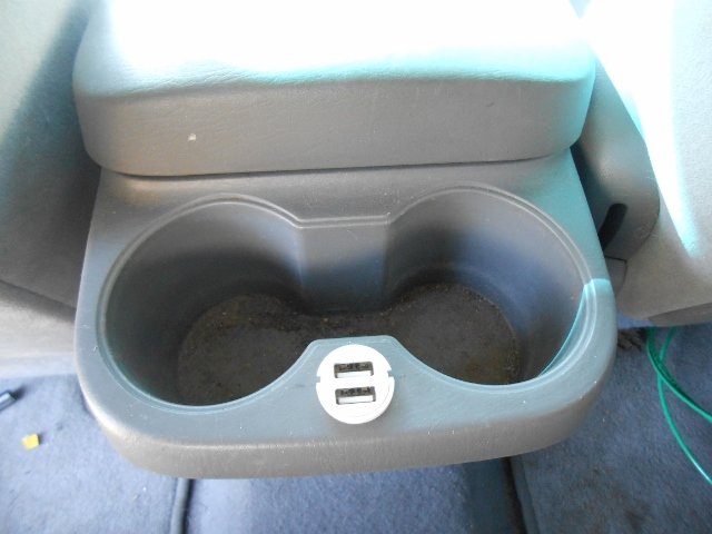

    I installed a Duel USB port in the back of the center console.
    This was worth it so I don't have to unplug my crapp for there crapp!
    I know there are only two ports and Truck has room for three, let them fight it out!
    Before :
    After :

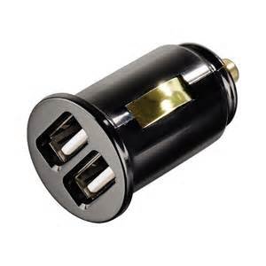

    Unit was $5 @ " 5 below "
    Unit will only be on when truck is running so they don't kill batt!

    Nice, I want to do this as well, for the front and the back...
    Have any install pics? tips, tricks, advice?

    Nice work on the install though. Wiring pics?

    Looks cool OP. I might have chose the waterproof USB port that have the cover that snaps on, but the location is probably better than underneath the cupholder area if you have a passenger in the middle.

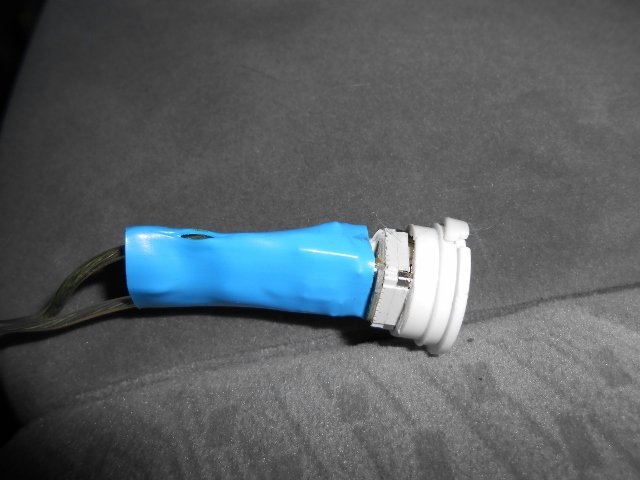

    Simple !
    Took unit!
    Cut just above metal grounding tabs, split unit soldered wire to pos and neg.
    Shrink rapped it.
    Drilled hole in console @ this location.
    Glued unit in place!
    Ran wires to fuse box found power only when on,tapped into, installed a 1 amp inline fuse, the ground wire, I grounded!
    Good to go!!:D
