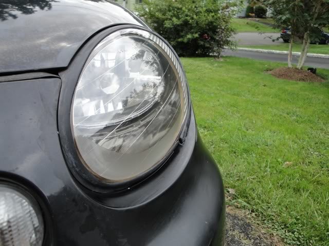

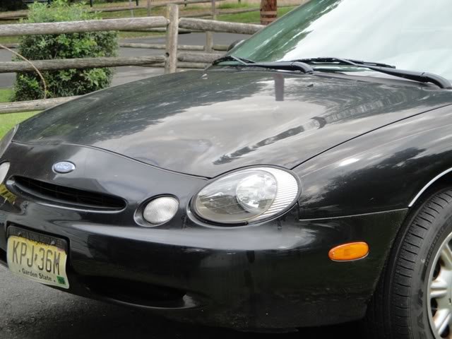

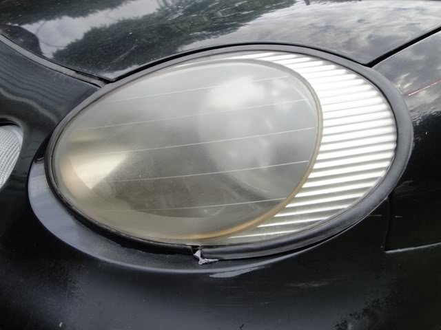

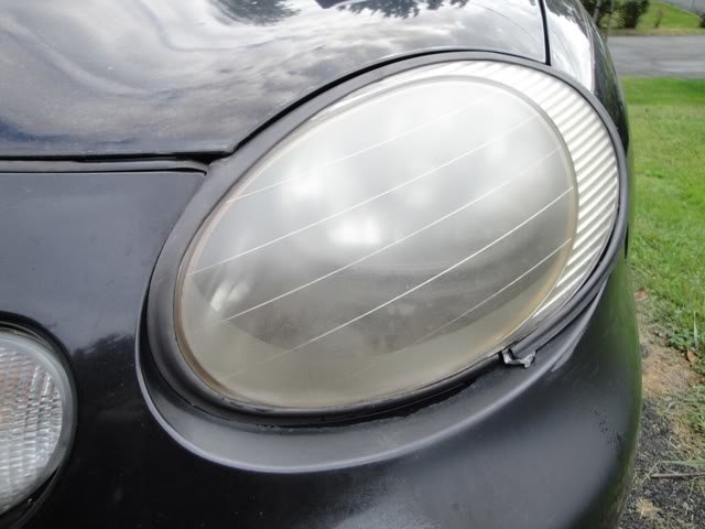

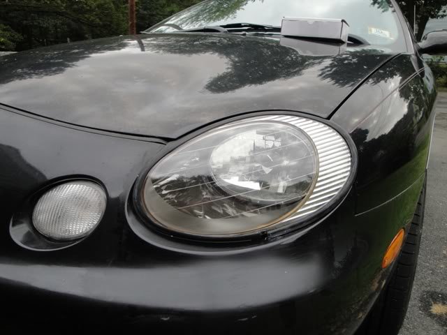

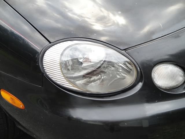

    Now, heres the same lens after its been cleaned up
    My neighbor has a very neglected Taurus. I cornered him when he came home and asked if he was willing to donate his vehicle for product testing purposes. He had no problems. Said it was mine for whatever I needed. Sweet.
    BEFORE:
    AFTERS:

    I used the kit from uglyheadlights on the above^. Its around 30-40 bux I think. Fwiw, those headlights lasted about 2 years, and they're starting to fade again. Imo, our headlights are relatively inexpensive. Unless you have a retro fit kit in them or some personal attachment, I would probably just suggest new(er) headlights for 100 bux.

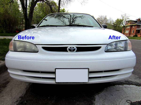

    Yes toothpaste does work, depending on the severity though. Its worth giving it a try. Took me less than 5 mins to do both headlights to get these results. Probably could get a little better with more time. Here is my wife's old corolla that I did a few months ago.

    took your advice and it worked like a charm man Thanks a alot!!! you saved me some $$$
