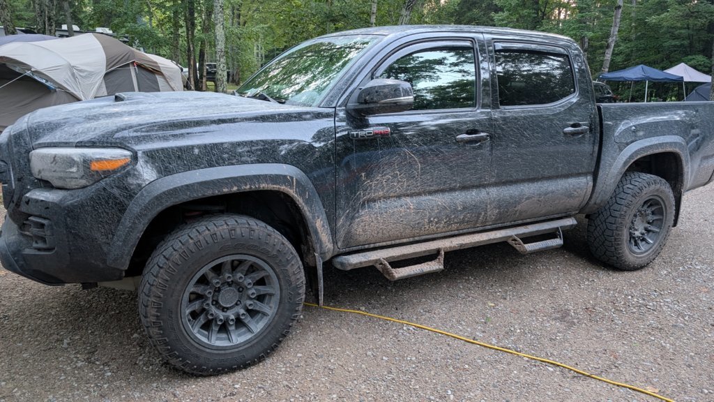

    Also got into some serious offroading for the first time with this truck. I know lots of guys have better setups but I was super impressed with the OEM Fox Suspension :thumbsup:
