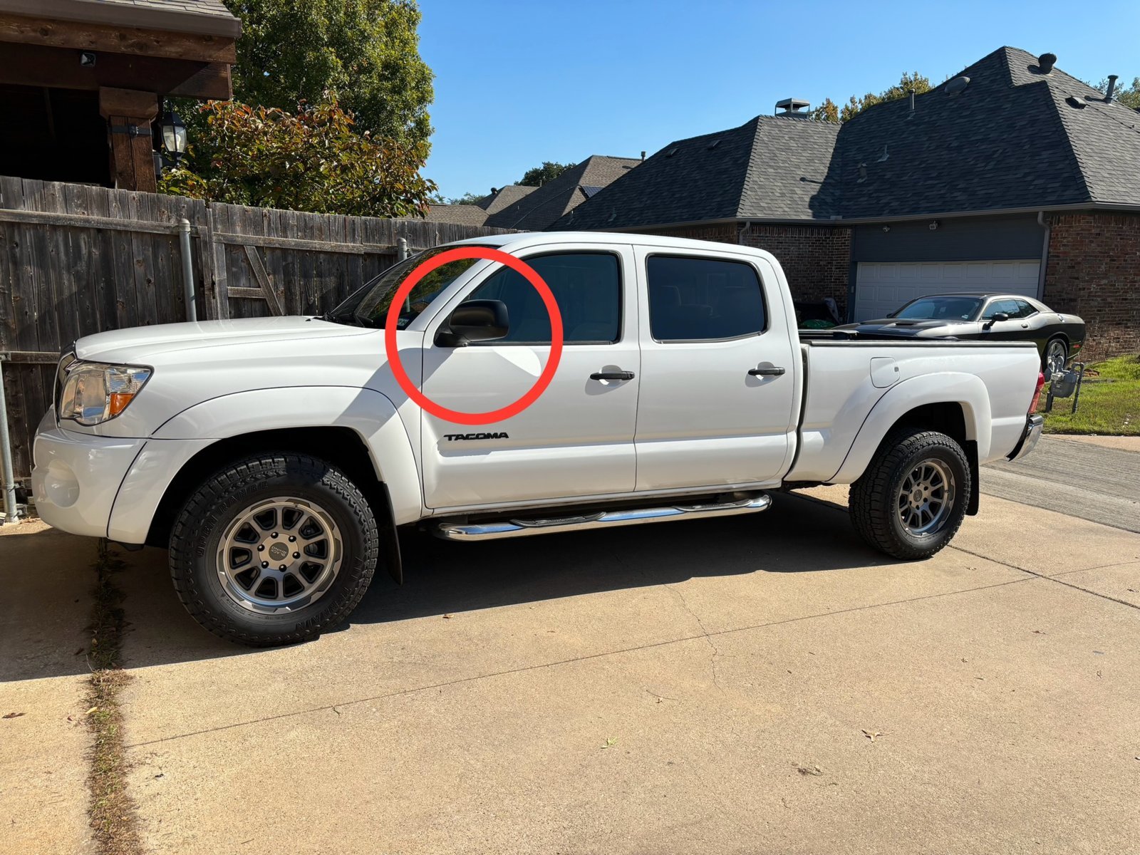

    I tried folding the side mirrors but they aren’t moving easily and didn’t want to brake them. So are they manually foldable?

    At the bottom of the pivot area are a couple fasteners. I wanna say one is 10mm socket and one is torx, I don’t remember the size. I had to tighten mine because they folded too easily and started moving around.
    I think the torx is the pivot. You could try loosening it a bit to see if it folds easier.

    Thanks all. I got them to fold by loosening to torx screws slightly.
