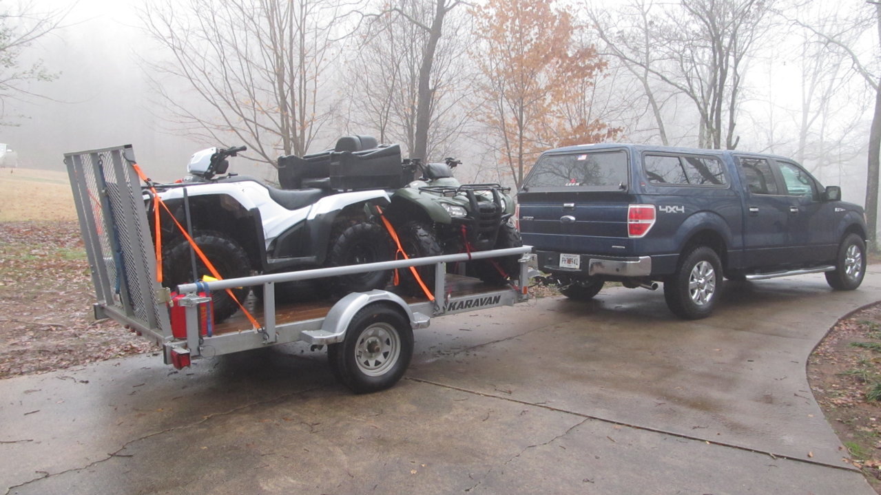

    Sams Club sells these. I've had mine 5 years now and have pulled it from GA to as far north as Kokomo Indiana and as far south as Miami. Multiple trips to the Charleston SC area. I paid $1300, but I think they are closer to $1400 now. It has been great
    6 x 10 ft. Steel Utility Trailer | Karavan Trailers
    It is very versatile. The sides and front fold down to load from the sides, or you can even remove them to have a flat bed. Mine weighs about 900 lbs with a 2000 lb payload. I'm know for a fact it will easily carry more weight, but that is to keep GVWR below 3000 lbs so it doesn't need trailer brakes.
    I volunteer with a group that searches for missing people. Several times a year my wife and participate in a search using out ATV's I can load one from the side and the other from the back.
