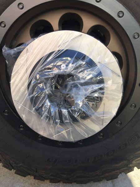

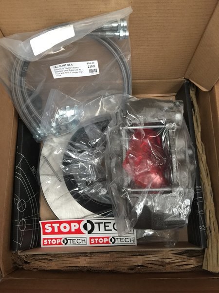

    Another option that will be available or can be sourced:
    I will be test fitting 2010 4Runner brakes Calipers on my Tacoma shortly for @Low Range Off-Road paired w/ Stoptech Slotted 4runner replacements (348mm Rotors) and steel lines on all 4. Will flush and replace with
    ATE 706202 Original TYP 200 DOT (essentially super blue without the dye as its illegal in the US now). Everything should bolt up fine. We had questioned the backing plates which will be replaced with 4Runner version. You also need to have a 17" rim for this to work. Bigger Pistons/Calipers and Bigger Rotors. Hope is for a 20-25% improvement. Similar was seen using Tundra setups on 1st gens.
    I will be documenting and posting up the differences. Should be a nice BBK upgrade without going with $2k BBK kits.

    Some photos of what is going on.

    Not sure what the cost would be they would or what they would sell it for but I would think way cheaper than $2k which is the idea of putting the kit together or you would just go with the full Stoptech or other BBK. At a minimum upgrading pads, steel lines and a fluid flush would generate improved results. My brakes feel like crap even more after a lift and bigger tires. The lines alone will help with pedal feel.
    I too was thinking of the rear conversion but as most have pointed out, we may actually lose braking in the rear compared to the stock setup.
