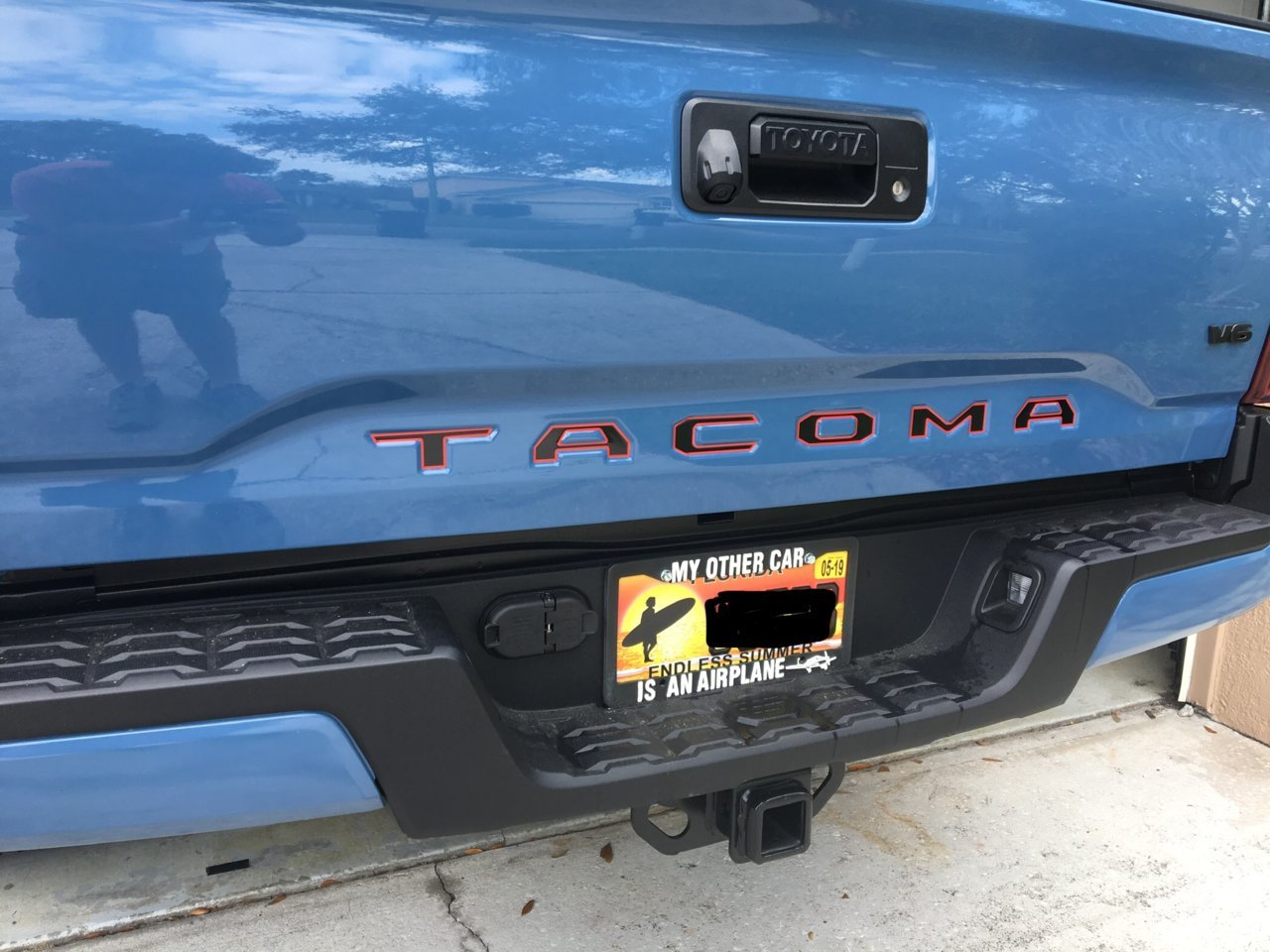

    NM
    2020 Jeep Gladaitor - Formerly 2019 Tacoma OR SB
    I did mine too. It’s pretty easy. If I can do it anybody can:
