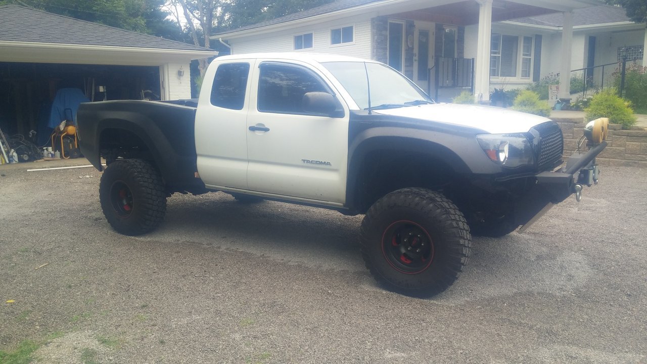

    Oh my! That looks sick man. Keep up the good work! Any idea how long it took to install?

    Sick man!!! What bumper is that??

    Subd, they look awesome.​
    How's the fit?​

    (Rear fenders) bout 4 days, so far on the install...."The fit" takes a lot of cutt'n, die grind-en...bracket make'n & parts off of the old fenders. The front fenders about 1 1/2 days....There's still a whoooole lot of finish work ahead. I've installed a lot of fiberglass parts over the past 3 or 4 decades, so on a scale from 1 to 10 I'll give'um a 6 on the fit.
    The bumpers are Jeep CJ (eBay) units, still have a lot to do on them too!

    Thanks for the report, they look good.

    Hey man! What did you do for your fuel Fill? There is not a fuel door on the duraflex bedsides. I am currently installing mine and I have a plan, but i would like to know what you did.
