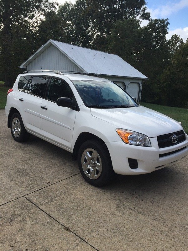

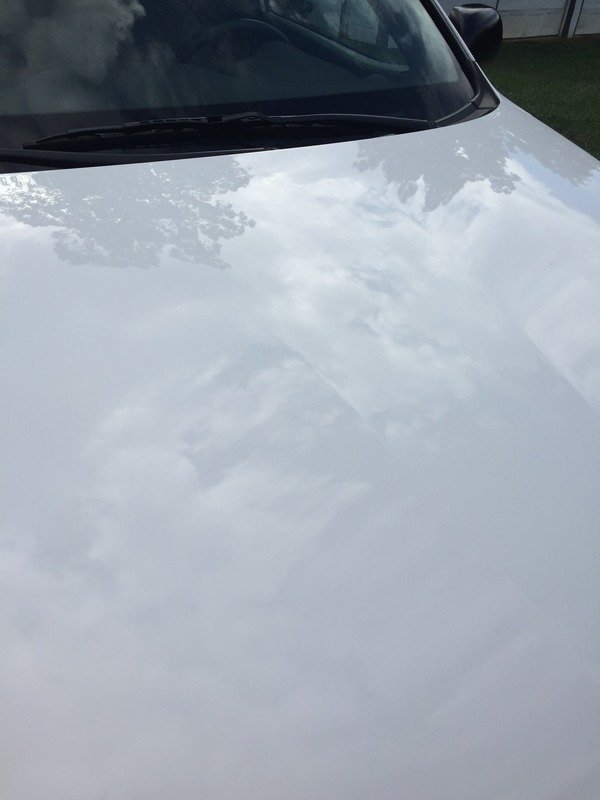

    Put Duragloss on my wife's Rav4 and had about 2 ounces left. I mixed it 4 to 1 but forgot you stated I wouldn't need that much. So I went back out and put another coat on. I still have about an ounce left in screw top bottle. Wonder how long it would last?
    The sun wasn't shining so can't see its beauty
    Mush Mouse and NMTrailRider like this.

    Looks good! Still need to do mine sometime this month between the doctors appointments. :thumbsup:

    That Rav4 needs a flat black racing stripe running down the center

    looks good that's as best a shine you will ever get with the super white color looks like a mirror shine:thumbsup:
