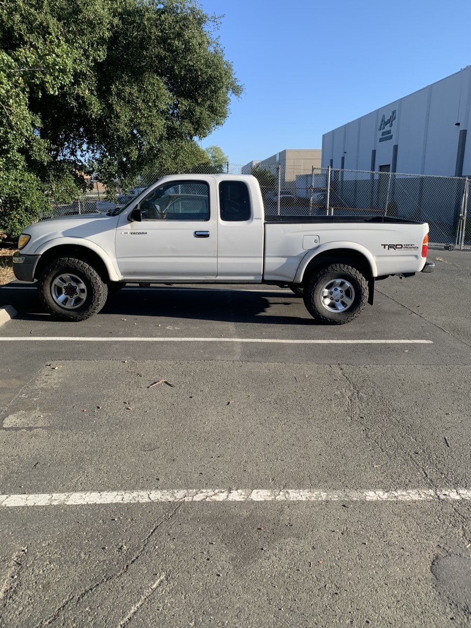

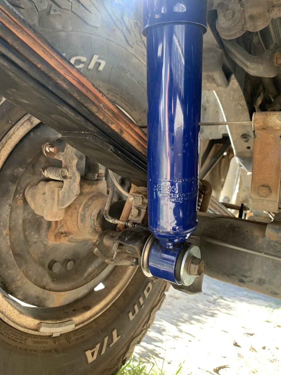

    I vote 5100’s on stock or close to stock rate springs in front. My truck currently on 5100’s with stock springs and set on the second notch. I have the 3 notch 5100. The rear is a stock leaf pack with wheelers progressive 3 leaf AAL and the overload removed. This lifted the truck approximately 1 1/2 at both ends. I never carry more than a couple of dirt bikes so if ya need more capacity this may not be the way to go in the back but 500 lbs drops it less than a inch. Relatively inexpensive lift and rides pretty good. I did try the Monroe’s quick struts first about 2 years ago and they were terrible, floaty and bottomed a lot. I’m waiting on Kings and plan on lifting the front another half inch or so 699A45CF-E06F-4DBB-9A99-728B95FBC5A0.jpg 98DDCC75-1DF1-46BE-A1DC-0961396DB901.jpg
