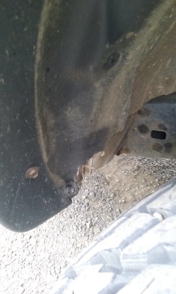

    I can speak from experience 265/75r16 wont rub with stock rims lifted or not 285/75r16 wil rub the living fuck out of your upper contr arms in 2 different spots on stock wheels or any wheel with 4.5 backspace. 1st pic is 3in lift with 265/75r16 stock wheels 2nd pic is 285/75r16 and 1/4 in wheel spacers and it rubbed the upper control arm bad but it didnt rub the pinch weld 3rd pic is 285/75r16 with SCS wheels that have 3.5 back space no more rub on upper control arm but now it rubs on the pinch weld when it flexs and is turned just right which is much more tolerable

    I think if you went with a wheel that has 4.0 backspace it would be better but it wouldnt stick out as far as a 3.5 backspace wheel if thays what matters to you

    I have hammered in the pinch weld and trimmed the fender liner it still manages to rub when turned and flexing, as for the ST MAXX theyre actually very quiet and didnt add to the stiffness of the truck pretty much the only thing I noticed with these tires is I dont get stuck they chuck rocks everywhere and im a little bit higher off the ground
