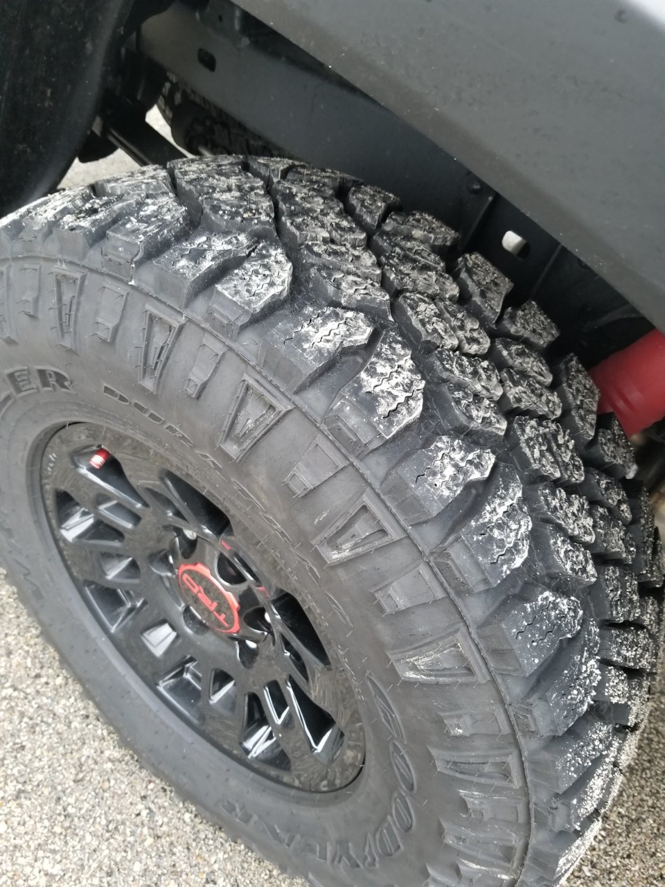

    Duratrac LT265/75/16, E's. Fronts cold at 36, rears cold at 31. TRD Pro wheels, I don't carry any extra weight. After 19 miles at 63 degrees this morning, fronts at 37, rears 32. 21.6 MPG, 2nd tank, same mileage.

    I find the LT, E load tires need a little more air than the D load tires do. I added just 1 psi to each tire cold, and I went from 19.5 mpg to 21.6 mpg. Makes sense to me, but I'm not an expert by any means. At 33 rear, I'd be too bouncy, I dont carry any weight, so I drop it down a bit for the patch.

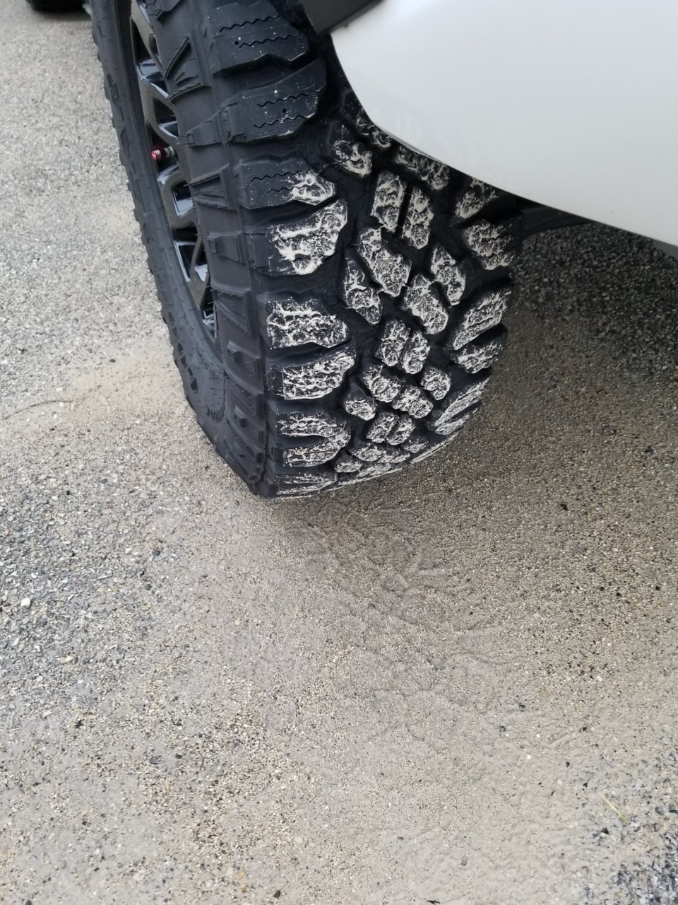

    My rears this morrning, at 31 cold setting
