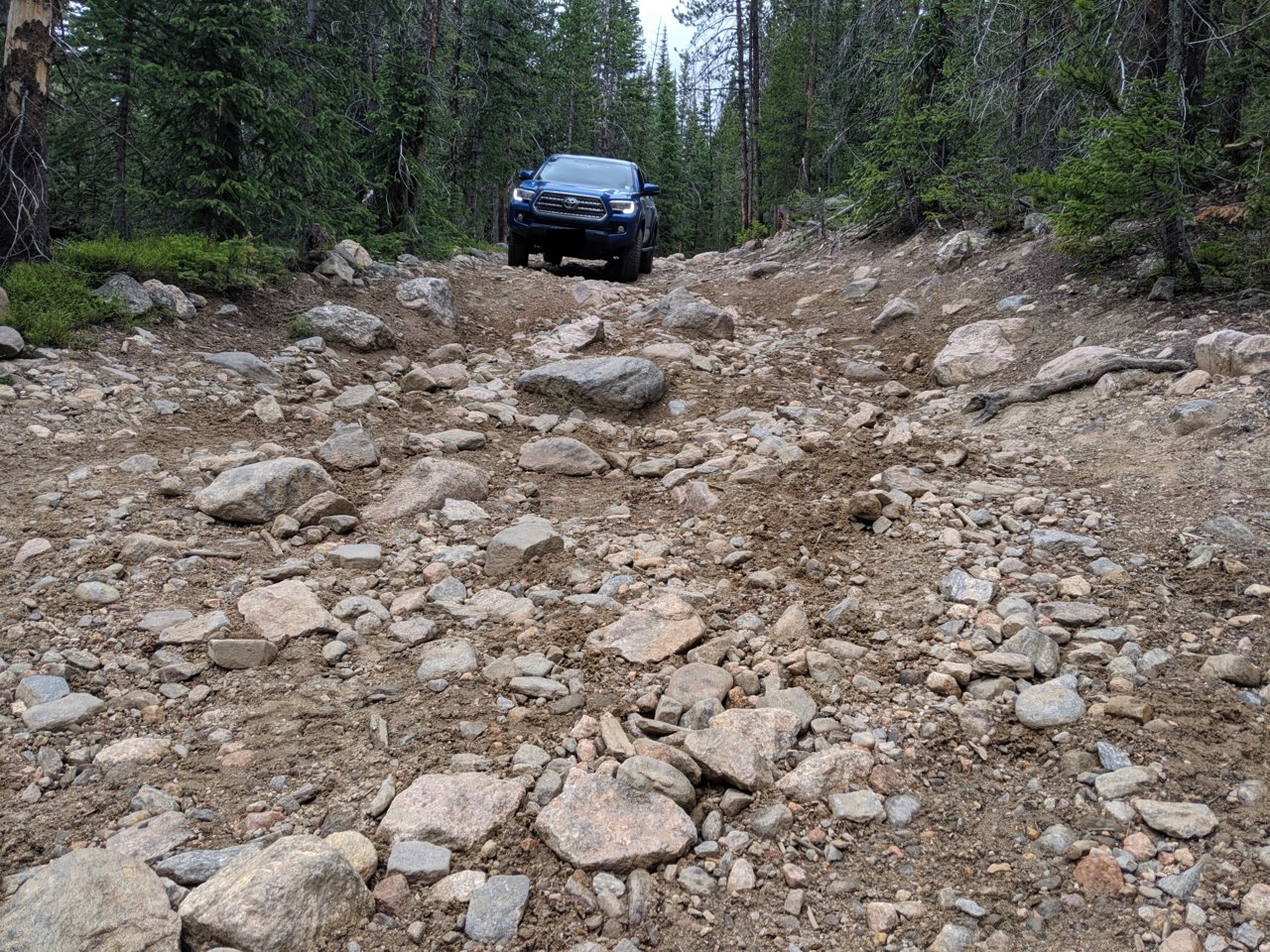

    I'm currently running Falken Wildpeaks for most of the year and dedicated snow tires in the main winter months.
    My wildpeaks have worn out a bit fast and in the interest of trying something different I'm leaning toward the Ultraterrain. However, I'm curious about the Duratrac. In the info I can find so far they sound very similar to the UT but each has slightly different strengths/weaknesses.
    I'm also curious about airing either down. I currently don't bother airing down as I haven't really had much need and I don't have a compressor yet anyway. Are these generally durable when not aired down on trails like in the pic below? Or should I plan to start airing down?
    If you have used both or know more about them, any reason to go with the DT over the UT? I do drive in the snow but won't be getting either studded or siped. I may leave these on year round. Not sure yet. Kind of getting tired of the annual swap.
    Also, regarding size, my snow tires are stock size and my Wildpeaks 265/75/16. When I put the snow tires on last winter I noticed a bit more power that I didn't realize the larger Wildpeaks were sapping. I think it might be weight - at least in part. For some reason, the 265/75/16 Ultraterrain is listed as lighter than stock size on Discount Tire's website. Is that just an error or is there some reason these would weight less than stock size?
