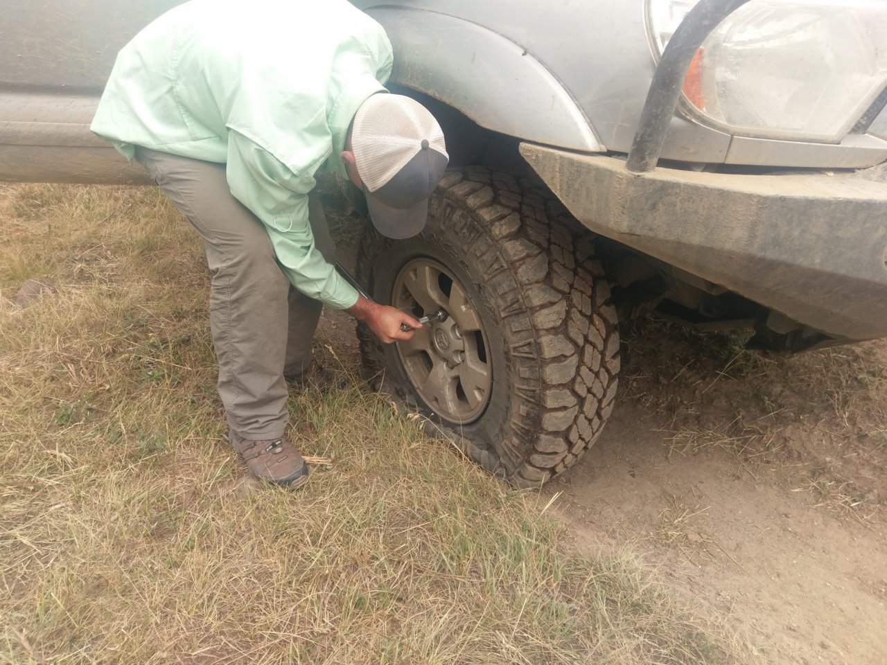

    I keep hearing people say Duratrac side walls are weak. I’ve heard a number of anecdotes but I’ve never seen someone show exactly how much weaker they are. I want to know if I buy this tire for DD and weekender off roaring (on possibly rocky/overgrown trails) will I just be constantly replacing them?

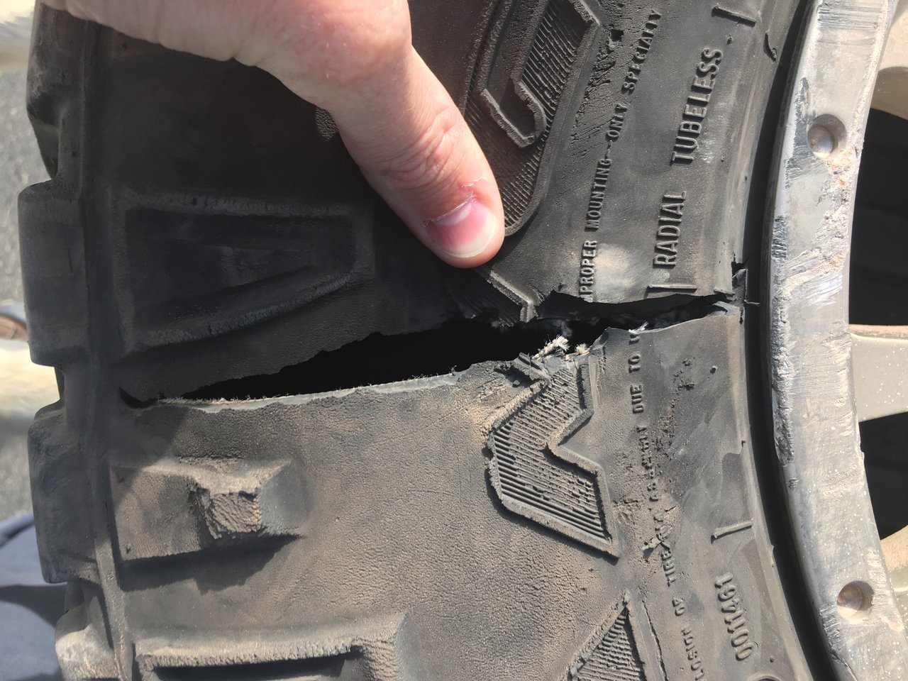

    Just a couple of my buddies tires. Even in load range E, they have 2 ply sidwalls IIRC.

    In fairness, that tire looks cooked...

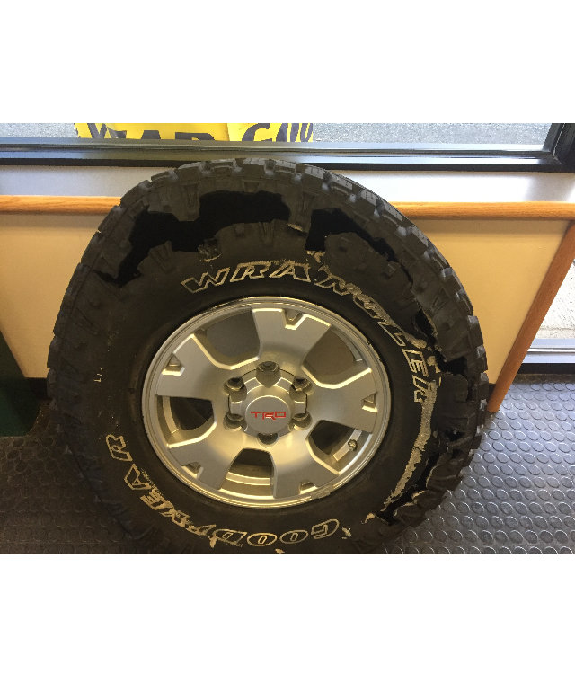

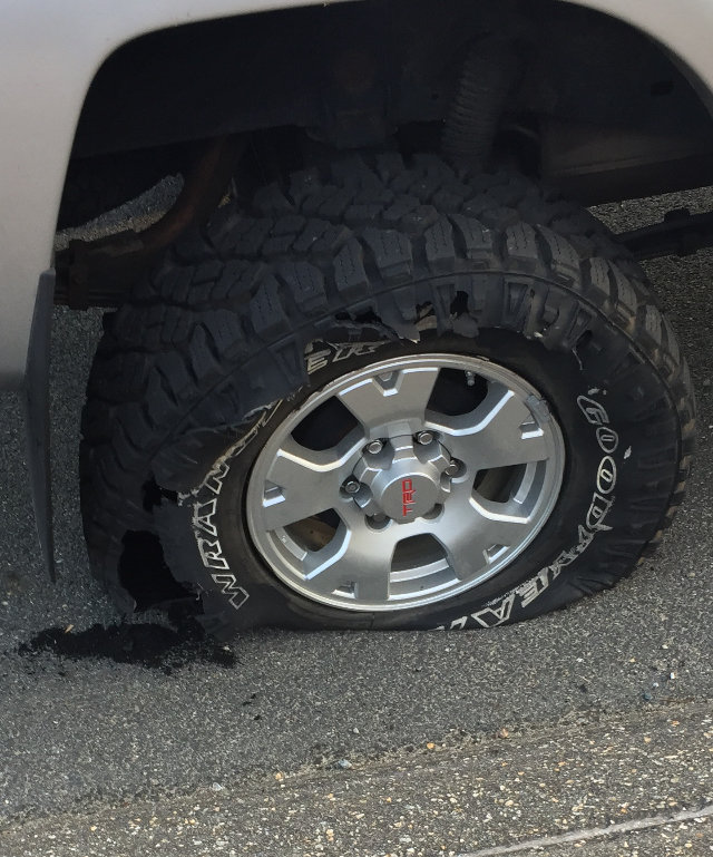

    I know a lot of people had good luck with them and I will say they are great in the snow but I will never buy them again. Less than 2k on the highway doing about 65.

    WOW. That is insane!
    Its strange that it only seems to happen to the DuraTrac model. You don't see similar complaints about the other Goodyear products as far as I can tell. Makes me think its a problem with the design - the tread, sidewall or interface area between the two.

    The rubber dust pile indicates the tire has been shedding rubber internally for some time. Wonder if it had been driven grossly underinflated for a while:
    That said I've done 60 mph on dirt roads at 15 psi with no issues. The pressure had gone up to 18 psi right after the run from the heating.

    That's an interesting observation. I have to say those images are compelling so it is nice to see a rational explanation for it. Still... I have seen some decent evidence in this thread, enough to make me consider the Cooper AT3s. I _really_ want the Duratracs for their look.
