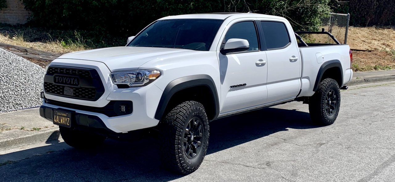

    5100’s 1.5” front lift / 1.5” rear aal 265/75/16 Yokohama X-AT they measure out 32”

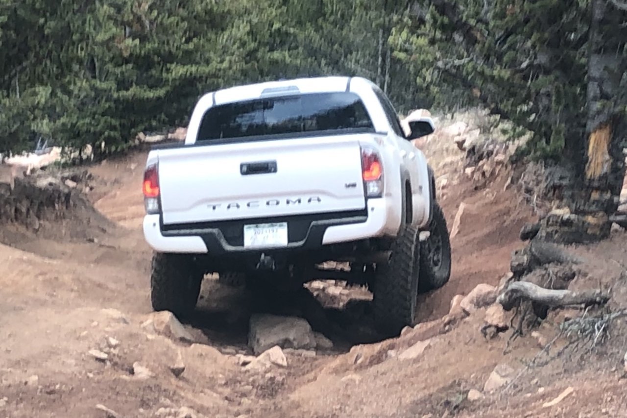

    May not apply but thought I would let you know, I have a 2” lift running 285/70R17’s with no rub anywhere. Bought it this way from Toyota and they didn’t have to chop anything...

    No rubbing all day long on moderate-difficult rated trails.

    Looks like front sway bar is still connected in that picture. With good alignment and sway bar, I didn't rub when wheeling with 285/75/16's and a 3" lift. When I took the sway bar off whole different story, fronts would then have full travel and rub bad. Hello cmc and fender liner trimming.

    I don’t doubt it but if I can do moderate trails like this that are fun with the sway bar connected and don’t rub then I guess I don’t have to ever disconnect it...not looking to trash my $50,000 truck just yet.......at least until I am past the break-in period!!
