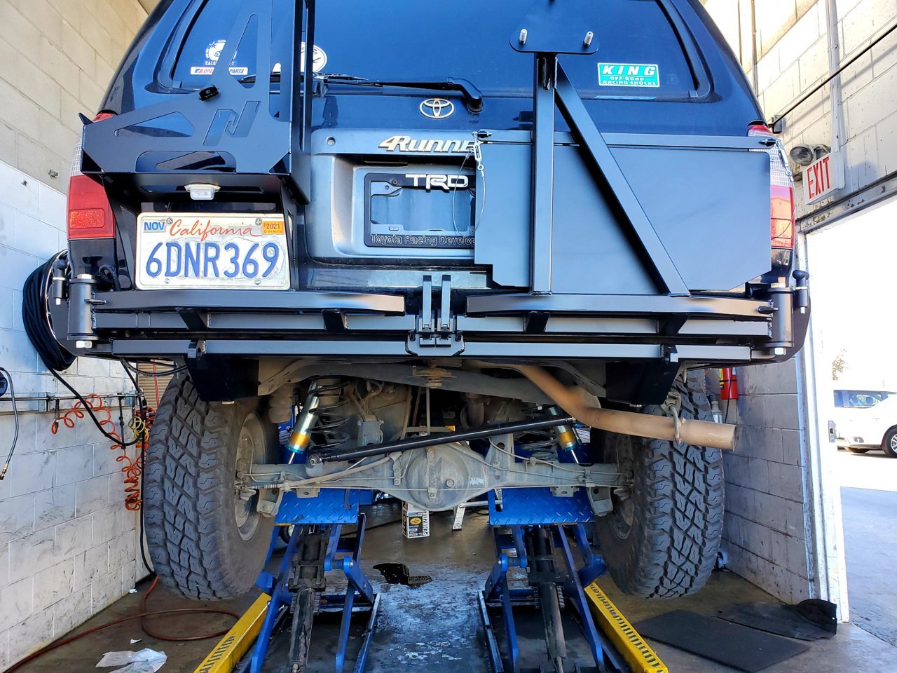

    Hell, the rear end feels even better cause those bumpstops really compress. Here you can see just how long they are -
    eon_blue[QUOTED] likes this.
