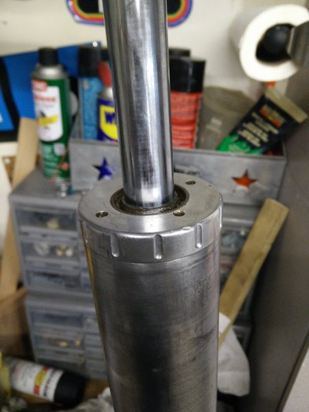

    I'am rebuilding my shocks, I got one of them done with no problem. But for some reason on this one I can't even get the damn dust cover off. The set screw is not in and the cover just keeps spinning. Anyone have any suggestions? The shock is a 2.5X18" smooth body with reservoir

    Is there air in them? Try putting some air in

    Is compressed air fine? I don't have a nitrogen tank.

    Yes that's fine...it will be gone when you get the cap off anyway and rebuild them

    Try pulling up on the rod to put some tension against the dust cap while you try to spin it off. It might take 2 people and it's probably gonna be either really stubborn or feel like it's cross threaded coming off

    Thanks Anthony, it worked. I love your truck btw!

    For anyone having this problem fill to 150 psi and break it loose

    we left maybe 15-30psi when we rebuilt mine. How old are yours that they have naked aluminum dust seals? haha
