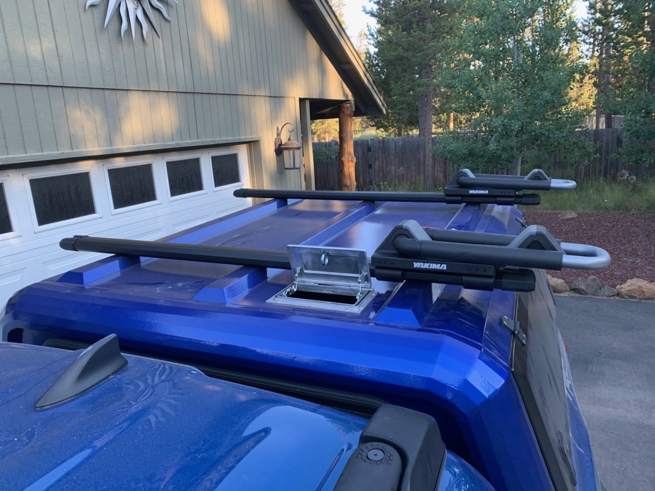

    A positive pressure inlet will probably make the biggest difference in preventing dust from getting inside when off roading. This RLD canopy is the first canopy that I’ve owned that came with this feature and man, it really helps out!B106F8D0-9E55-46CC-B4E7-521CB375FA58.jpg
