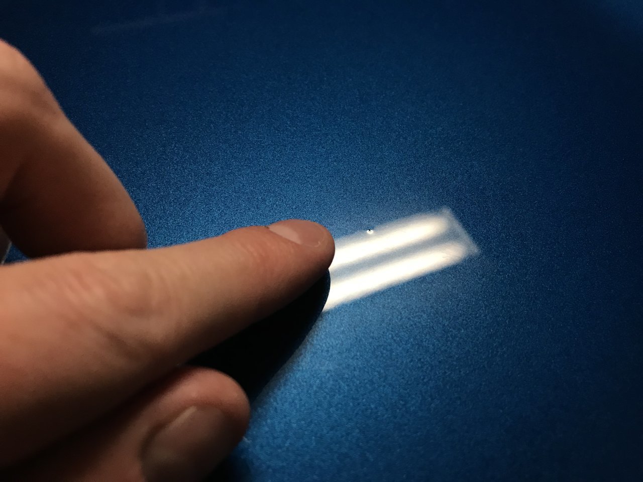

    Hey Everyone,
    I just bought a new TRD OR in BBP and I've found a few small particles under the clear coat. They're tiny dark pieces that blend in fairly well with the metallic blue, but it's pretty obvious in the right light due to the bump in the clear coat. Is this common with these trucks? If so, what has Toyota done to fix it for you (assuming you chose to get it fixed)?

    I could be wrong, I don't think so clay bar will help this. It's definitely under the clear coat. This is the best photo I could get in the garage of the one on the hood. It's a lot more obvious in sunlight.

    It should wet sand out. Try some 3500 grit and then polish it out. I had a spot on my 18 Sport. No big deal, took about 10 minutes and gone.

    Trash in the paint is extremely common. Like others have mentioned, even multi million dollar facilities that the major manufacturers have for paint applications still cannot have 100% perfection. If you are considering having it repainted, I'd highly recommend you reconsider.

    I’d take the one spot of dirt in the clear all day, any day over the chance that some $10 dollar an hour prepper swirls up the entire panel trying to polish it out.

    Lol true, but it'll need to be wet sanded then buff/polished. No way someone is sanding on my truck unless it's me! Even I wouldn't mess with that though.
