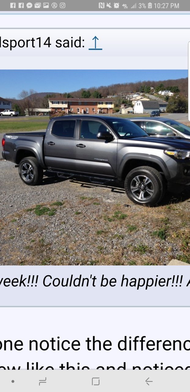

    Well while we are on paint. Has anyone seen this issue anymore, with the mismatch paint? Saw this one on the MGM forum and the guy didnt notice when he posted it but I've seen people who have noticed on theirs.

    Now that’s a problem to take back to the dealership.
    But that has more to do with the angle that the doors are painted at. They need to be sprayed at a consistent angle so the metallic flake will settle the same way so that the light is reflected equally back to the eye.
    It’s like messing with suede leather. You rub your hand one way it looks lighter, rub your hand the other it looks darker.
