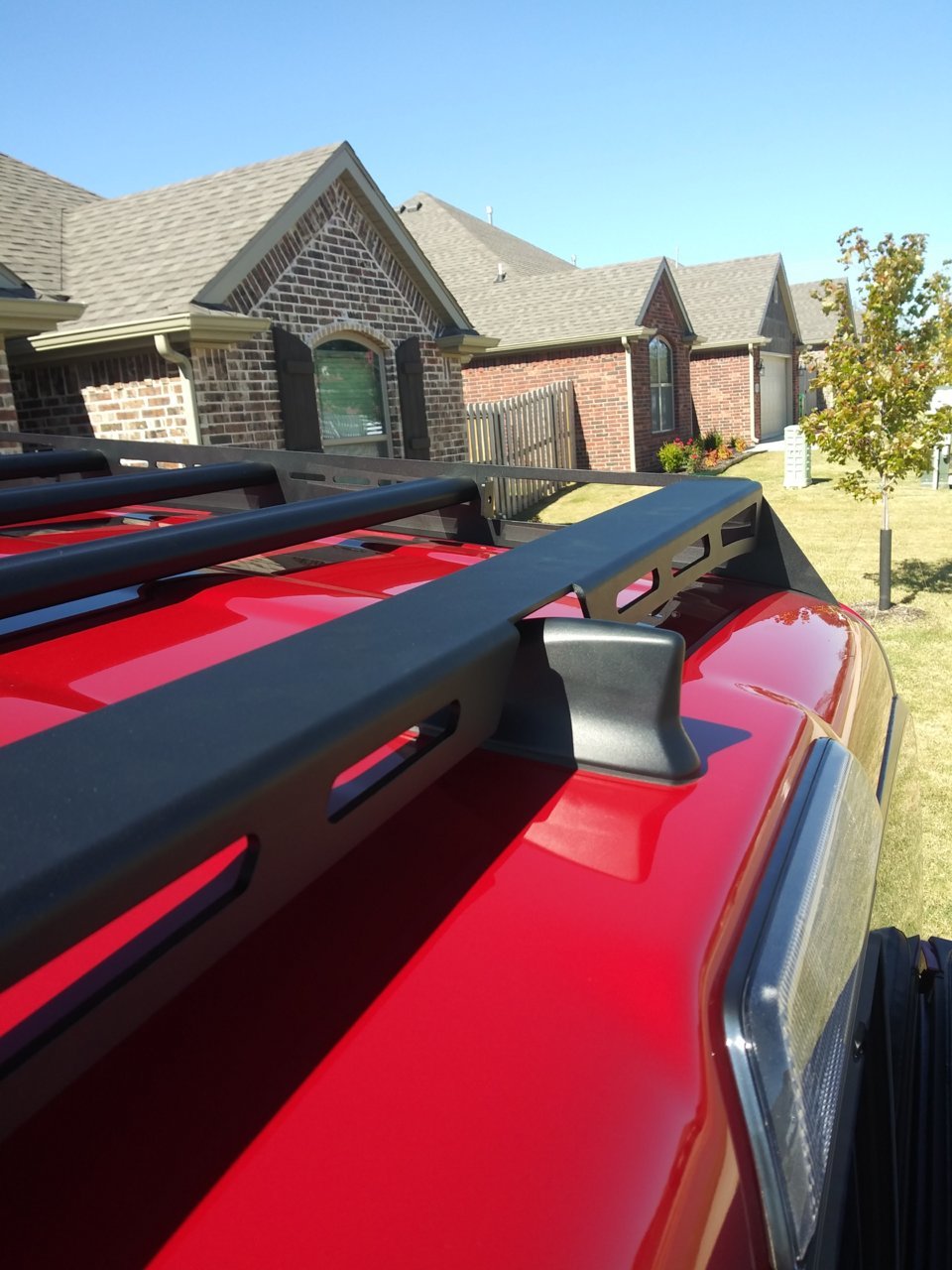

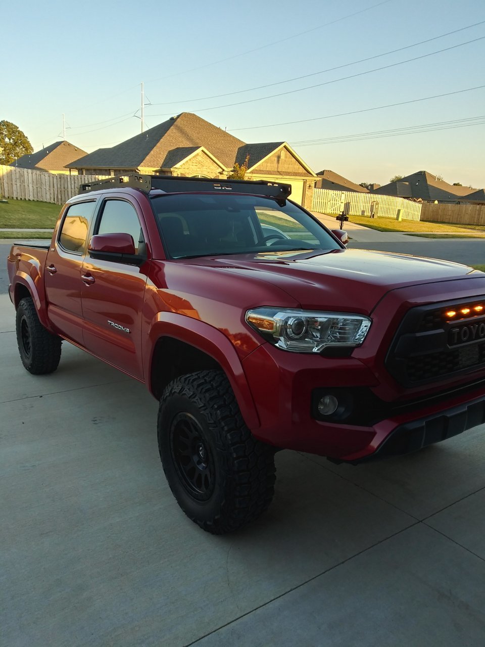

    Installed dv8 roof rack on my truck. I know there isnt much info on these on here so thought I post mine.

    Looks good OP :thumbsup: Now, be prepared as some folks here might tell you that you should've went w/prinsu or uptop. To each his own, thanks for sharing.

    :D:D. I'm prepared jepoy cemento! I wanted something somewhat budget friendly but aluminum lightweight rack. It took alittle modification but I'm pleased with it.

    Looks like a good rack to put some gravity pro 6 lights on

    Looks good! What kind of modification did you need to do to get it on?

    What's the noise like? How much clearance between the roof and the cross bars? My sunroof can't open vertically all the way with my baja rack, a small downside.
    I really like the way the bar covers the shark fin, but i wonder how it affects antenna performance. Wouldn't really matter to me since I never used any radio stuff...

    Interesting cross bars, how do you mount things?
    The integrated light mounts are neat.

    I had to cut one of the cross bars about 3/4" and retap holes for bolts to go back in. Other than that easy install. I dont hear any wind noise so far. The crossbars do sit about half inch from the roof top. My radio works just fine.

    Honestly not a bad rack if you want to save $200 to $300 bucks compare to prinsu rack if you dont mind taking the time to cut one of the bars and retaping. I forgot to mention I did also have to get 8 bolts to mount to roof. M6x1.0 25mm. The ones that came with rack were M8 bolts.

    The side rails have mounting holes . could possibly install hooks and youll be able to strap things down.

    Ill be throwing bags up there when going camping. I usually put the 4wheeler on bed of truck and dont have room for any luggage.

    Are the crossbars intentionally installed upside-down?
    Why no channel to use t-slot nuts for tie-downs?
