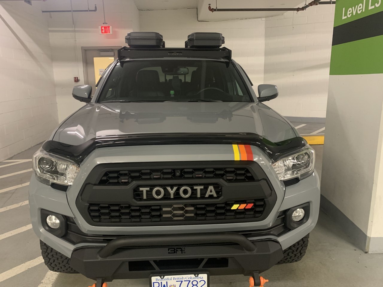

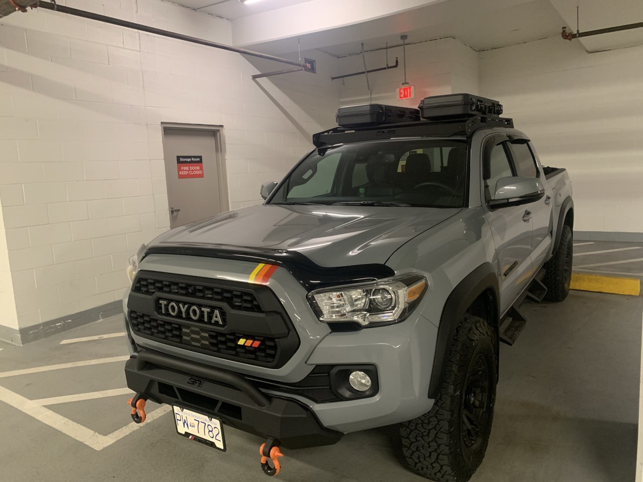

    Complete with cargo boxes!!!! No real wind noise. Sunroof works fine. Love the look!!!! 98163C3B-F9F7-4DB1-AAF4-B193E114AB99.jpg AADA4F84-2783-4C45-B0E7-EE7DCEBD6A37.jpg

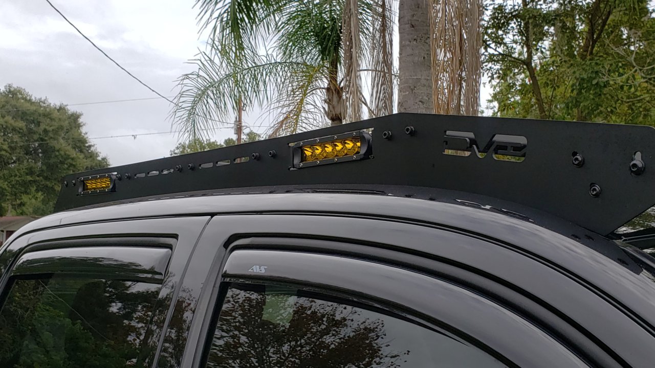

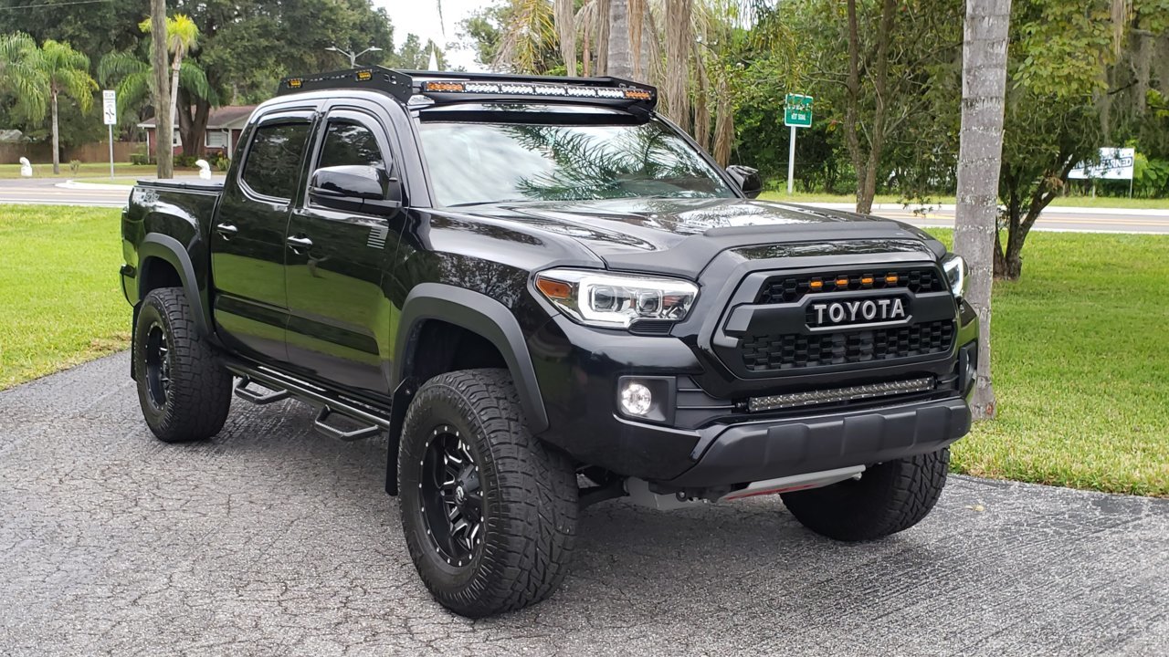

    i think the DV8 is a good rack overall and i like all the different pictures everyone has posted of theirs. this is mine and i really like it.

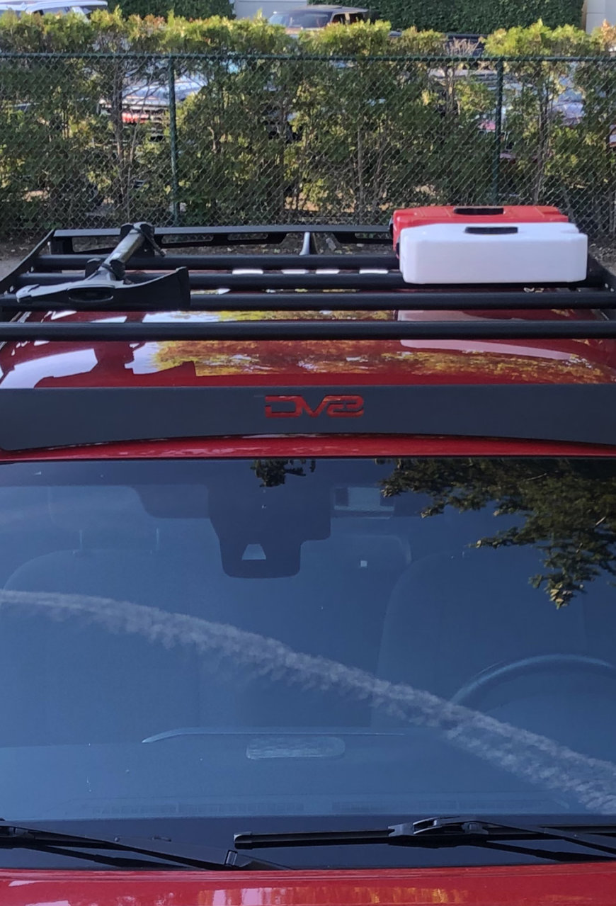

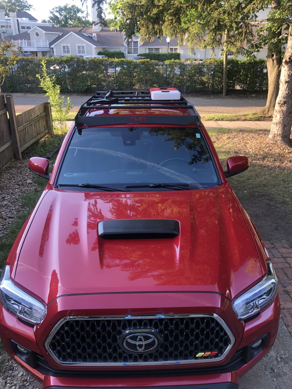

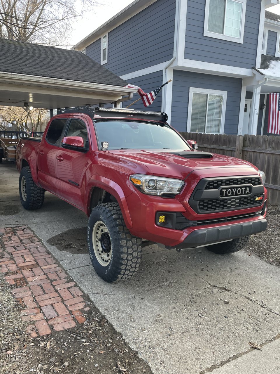

    The cross bars should be mounted with the slots up and they are numbered 1-5 if you go back to front perfect fit no noise no vibrations. How I mounted things were m8 nuts (square nuts that slide into the track) I did do a few things when putting it on I left everything really loose and tightned each allen head one at a time different places. I also used this like door trim that came with it I cut it in half evenly and put it under the bottom of the long bars in the middle, that made non of the roof bars touch the roof it also keeps any vibrations away. I would recommend buy better quality screws for the side rails they like to strip quick. ( I ordered a bunch of black hardened steal torque) screws to replace the chrome ones. It’s a
    Okay Rack for what you pay. I only plan to mount a few roto cans, I have a gas and water now and a supply one coming (black gas can that folds) there mostly going to be for back up gas and water and some first aid stuff for camping and when i take my son dirt dirt biking. It’s only rated for a 100 pounds
    Hope everyone is doing great. D608FABF-E393-4126-AA30-17A181D4B172.jpg28679DA6-F4D9-4A54-AB7C-8DD2A0F683FE.jpg

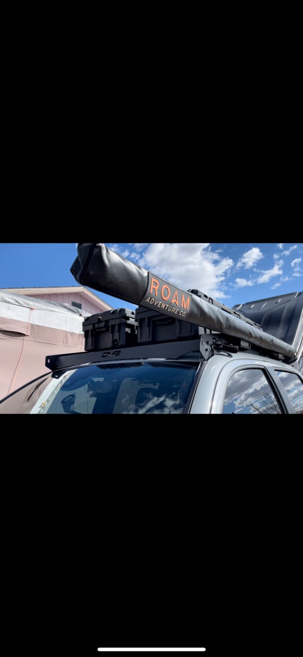

    How did you mount your awning? I just bought a Rhino 270 and I've not seen anyone really have any info on it. Much light the rest of the install, I was planning on spitballing it lol. Like everyone else who's attempted to add things to it, it took a bunch of trail and error, Amazon returns and adjusting to get it right haha.
