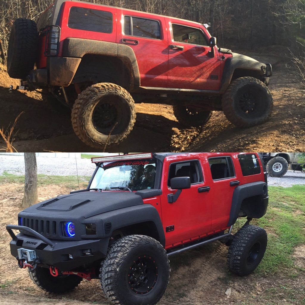

    Did a SOA on a Hummer H3 today. Turned iut well and got to use an awesome MIG all day.. Almost made it to easy..
    Tried on the hummers 37x12.5 MTRs w/ Kevlar on today.. They were HUGE!! Well over an inch taller than my buddies 38 TSLs on beadlocks.. I sat 1.5 inches lower on the flat portion of my frame than my buddy on 38s and the MTRs were an inch taller so that means I'm about 2.5 lower overall. Happy about that..

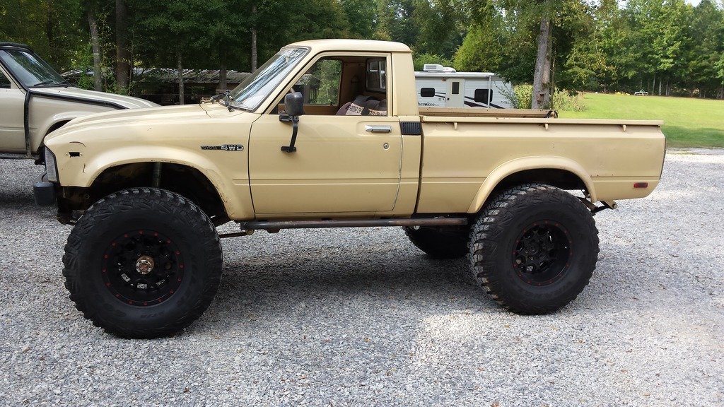

    Reworked the rear pack.
    Much better

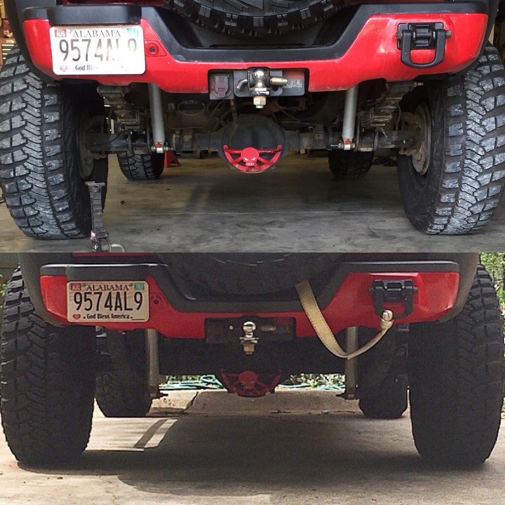

    And the bottom 2 are the 1st and 3rd leaf out of a Rancho spring pack for a......................................Hummer H3 :D
    I did a SOA lift on one last weekend and he left his old springs here and didn't want them. Turned out nice though. Here's some pics:

    Not my cup of tea, but he loves the dang thing and actually tries to wheel it.
    He wanted it done so we did it. It definitely helped his flex and clearance..
