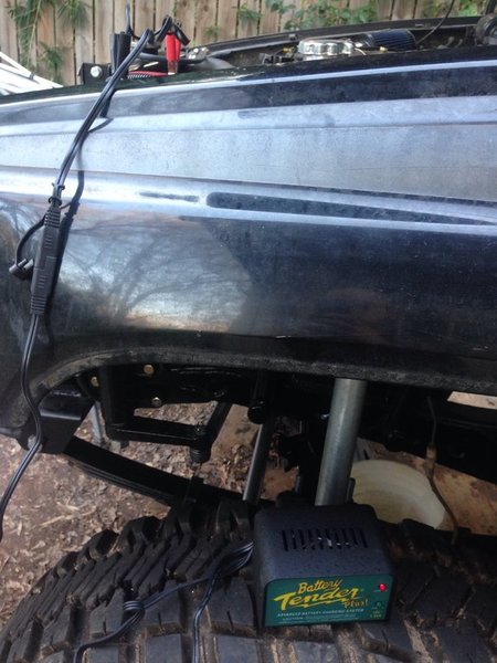

    I would highly advise to pick up a laser level for pictures. I hung it from the ceiling and it gave me a perfect straight line over the wheel well. I'll go through my pictures when I get off work and see what I can find

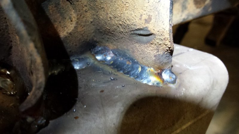

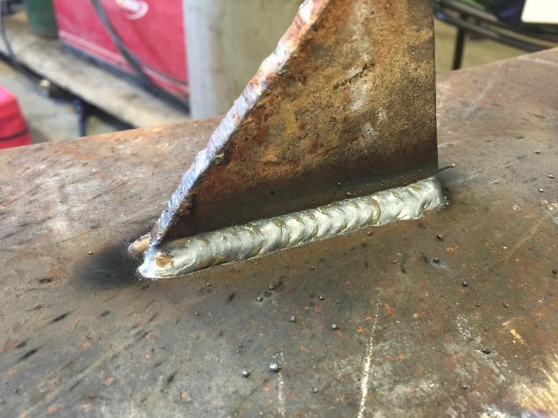

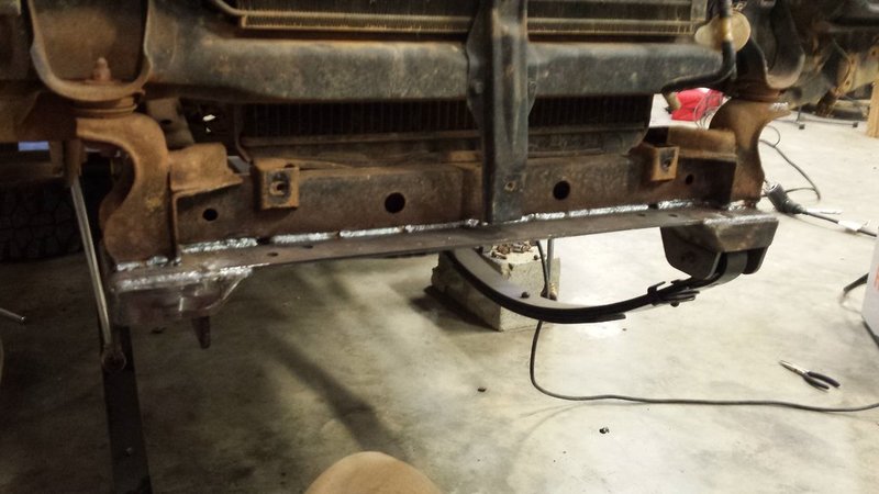

    Got my front hanger welded up. I went 1/2" forward and the shackle is just perfect along with the lift height.
    Probably overkill going all the way across the front, but I was having fun with the welder.
    Up close of welds:

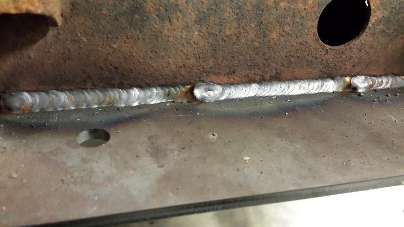

    Just because my buddy said this spot was hard to weld good:
    My overhead welds turned out as good. The best overhead I've ever done..
    Really this welder seems so forgiving. It just welds good.. I freaking LOVE it.
    Tried maxing out the duty cycle and couldn't get it to.

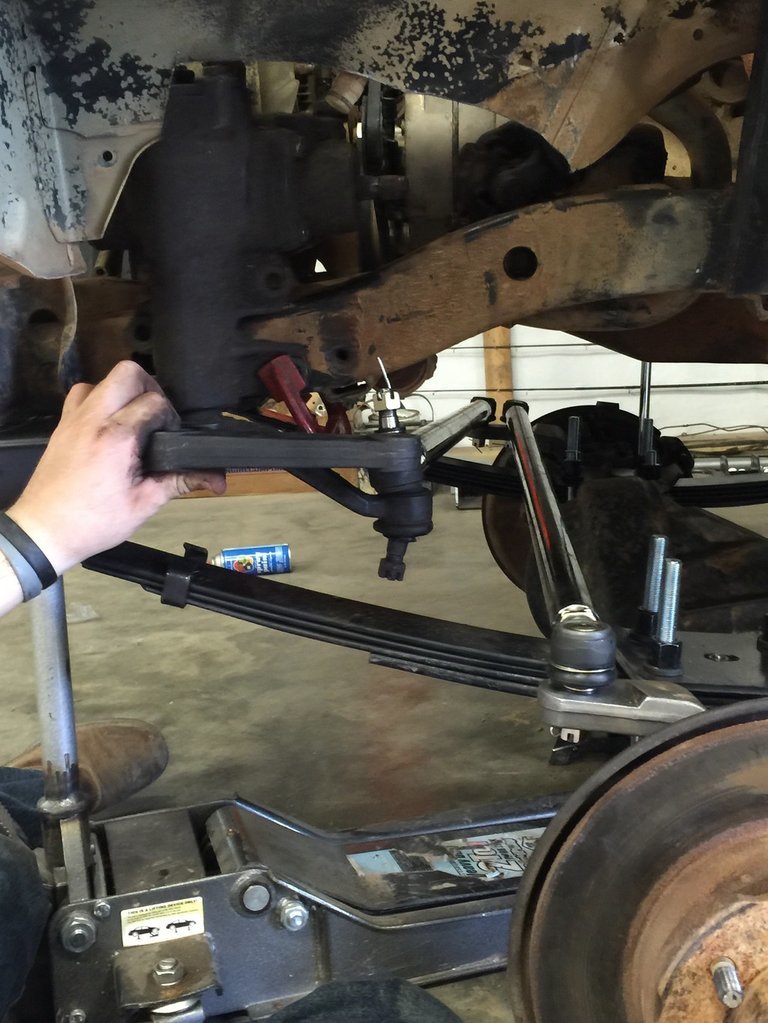

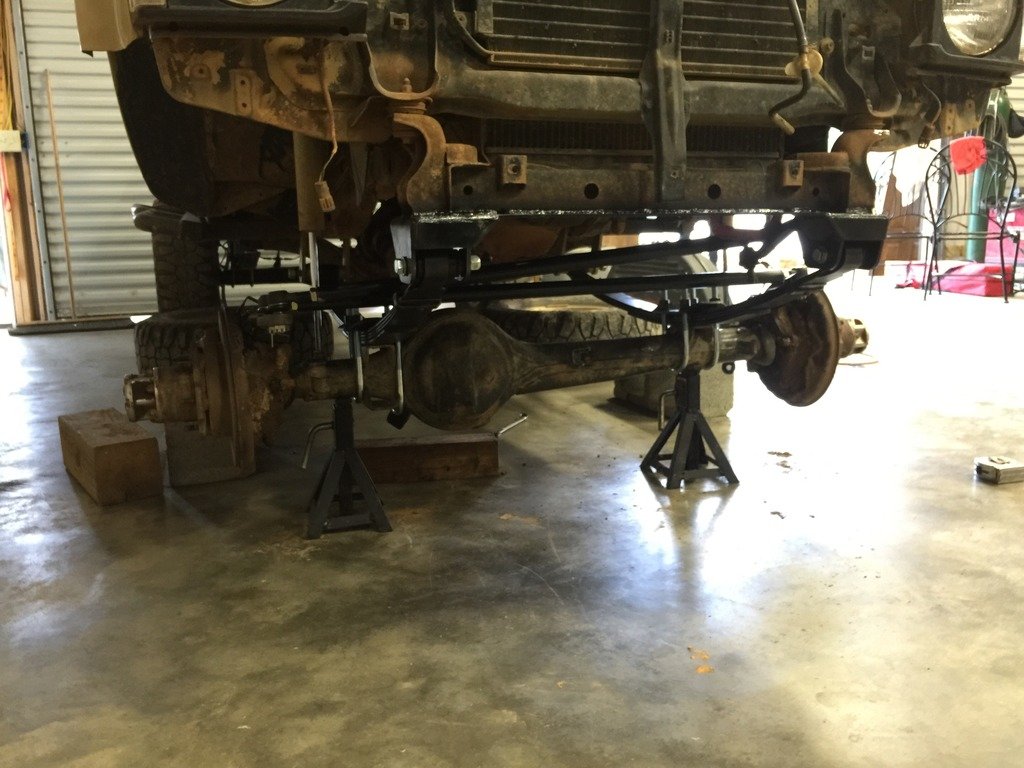

    Threw the high steer on the old axle for mock up and stuck it under the truck
    Looking about right I reckon
    5" of separation between the tie rod and drag link.. I may go another 1/2" forward..
    Ajohnson you wanna measure the horizontal separation between you tie rod and drag link for me?

    It's kinda hard to right now
    I had plenty of room so I'm moving the axle another 1" forward on the springs

    I went out and did what flexing I could with the jack and it seems like it's gonna clear fine.. Mo where near close to touchin anywhere but I still had about 2" of uptravel..
    I'm gonna throw the flat arm on the box and get it where I want it and then clamp it down and I'll find a way to fully cycle the suspension to make sure I'm good..

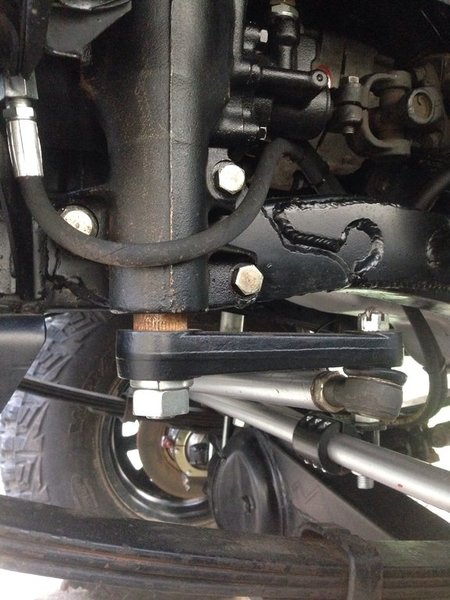

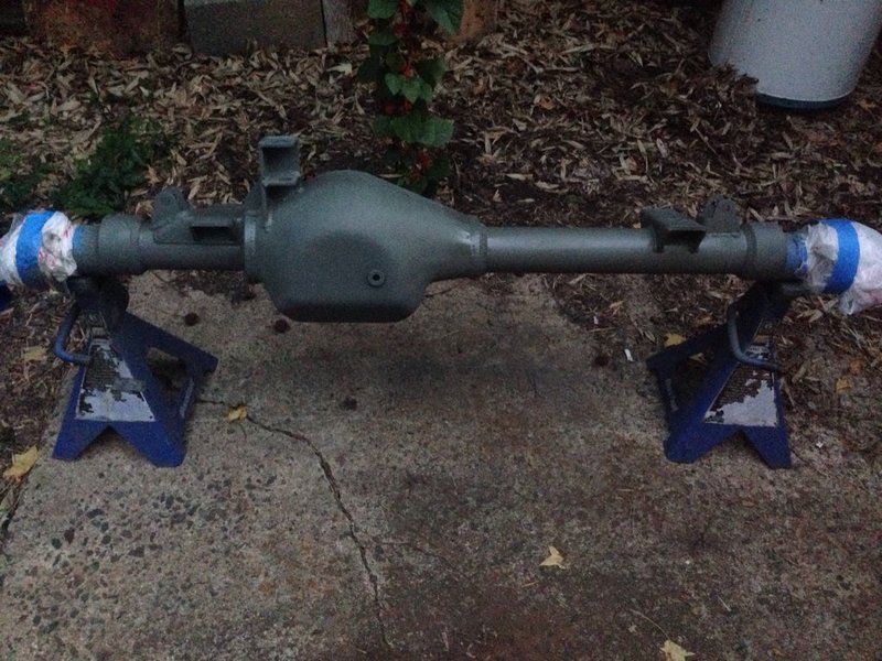

    I found this pic, it's not great but can kinda see my clearance, plenty and of course the tie rod/axle swing back a bit when compressed with leafs.

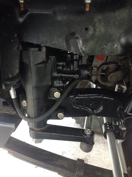

    Here yah go, couple more I found. Only problem I had with the box this far forward is having to clearance the core support because of where that hydro ram fitting is on the front of the box.
