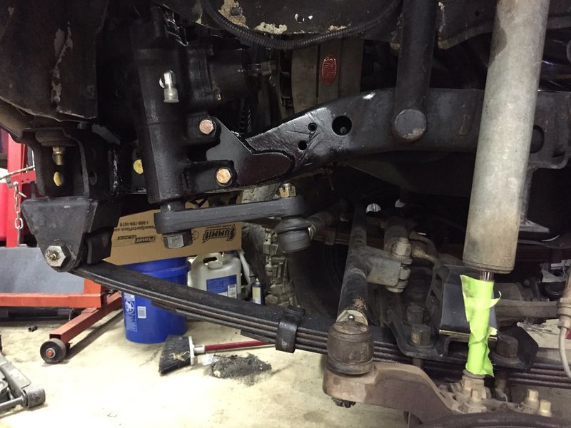

    Yeah I think I'm good where I'm at then.. I'm gonna barely have to clearance around the front of the box. There's a little lip of sheet metal sticking out that I'm bumping into so I'll grind it off and clean up the inner fender some..
    Really not gonna have to cut anything major out in front of the box along the core support.. That's why I'm kind of skeptical about where I'm at with it. I could really finagle it in without cutting anything.. I'll take some pics to show you

    That hydro port can be tapped on the side of the box, but the placement is very crucial. That's why most are tapped in the "O" on the front, like mine, cause it's easy. My friend just moved his port to the side so he could easily push the box forward.

    This is my friend's 85 runner, you can see he retapped the box on the side. Keep the pitman tight to the frame so the TRE stays off the spring. I think his axle is 2" forward from factory now like I want

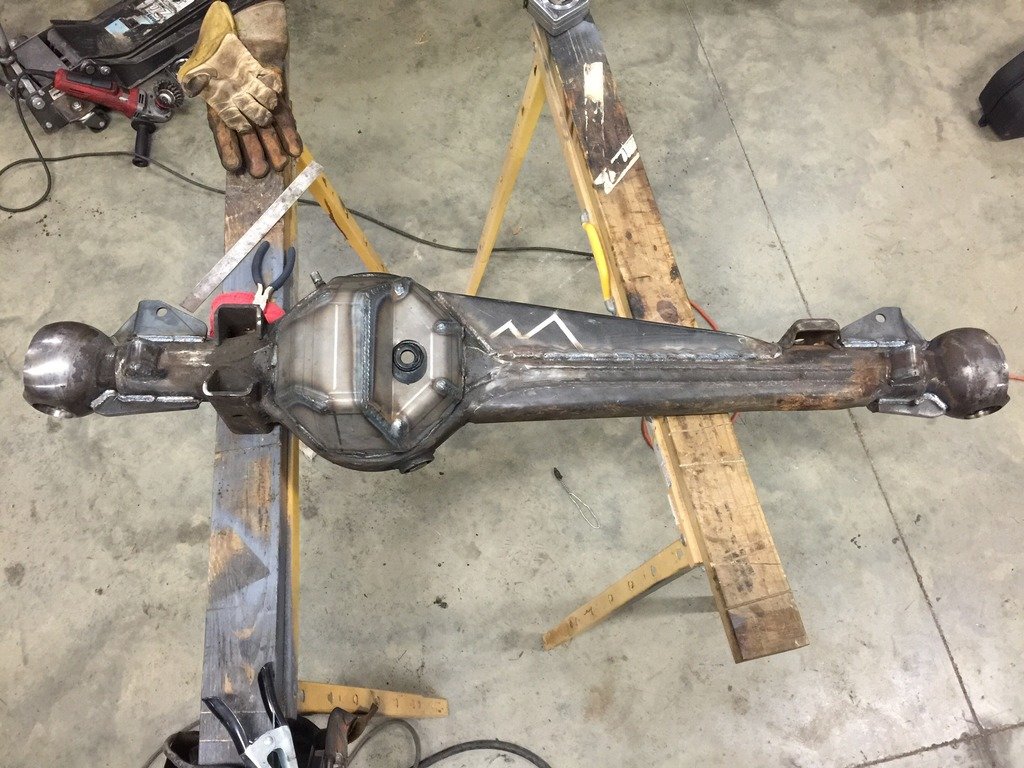

    Diff armor and knuckle ball gussets came in.. Already got them halfway welded on. Skipped around on it for awhile till I couldn't weld anymore without welding up to a bead I had laid earlier so now I'm letting it all cool before I go "connect the dots".

    Pure beef. Diff armor and knuckle ball gussets/shock mounts..
    Up close:
    This welder is awesome. The bottom knuckle ball gussets is a single piece of steel at least 3/8" thick and I welded it on the 4th of 7 power steps and it penetrated great. It's so awesome. Best investment yet..

    Looks good dood. I had clearance issues with my wiper, rings and upper gusset. Test yours before final assembly

    Yeah you will have to clearance them. It's not bad

    I know you mentioned it a few pages back but what welder did you go with?

    Hobart Handler 210 MVP. It's awesome.. It ran for over an hour straight tonight without a hiccup.. Welds nice and hot too..
    Hopefully I can throw the knuckles on tonight and I'll deal with the clearance.

    I used a dremel with a carbide bit to shave a little off the gusset
