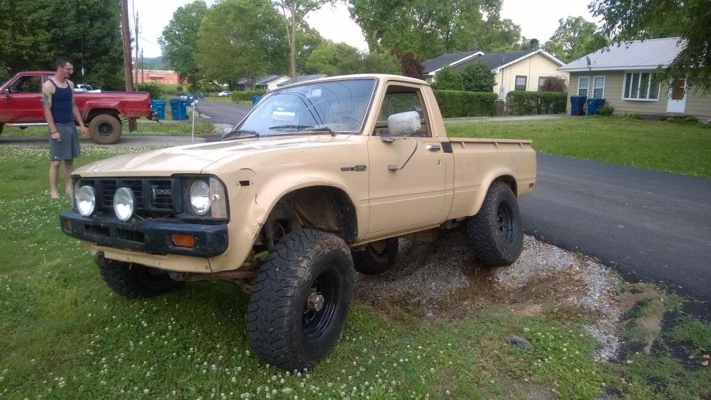

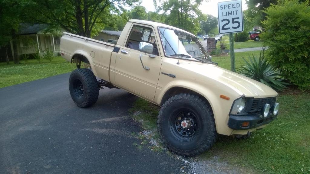

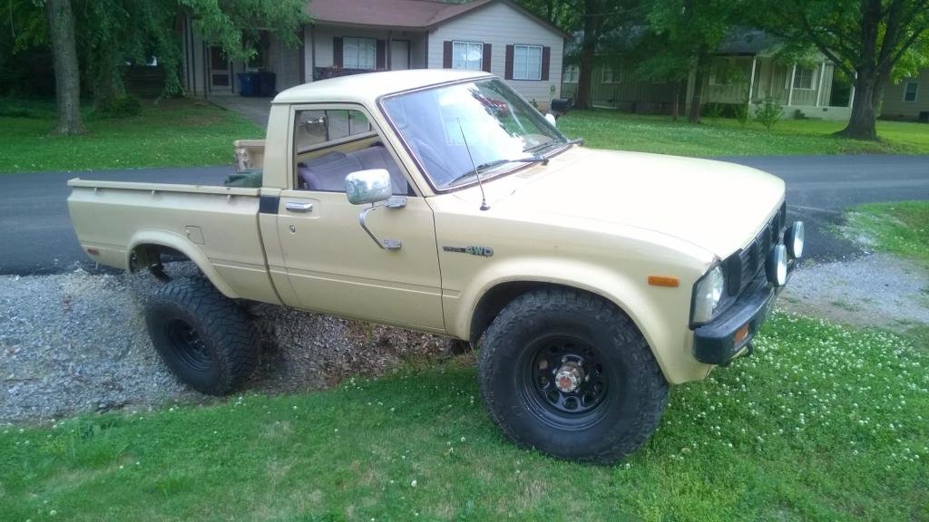

    Got new tires and rims today:
    Kenda Klevers: 32x11.5r15
    15x8 steel wheels 3.75 backspacing.

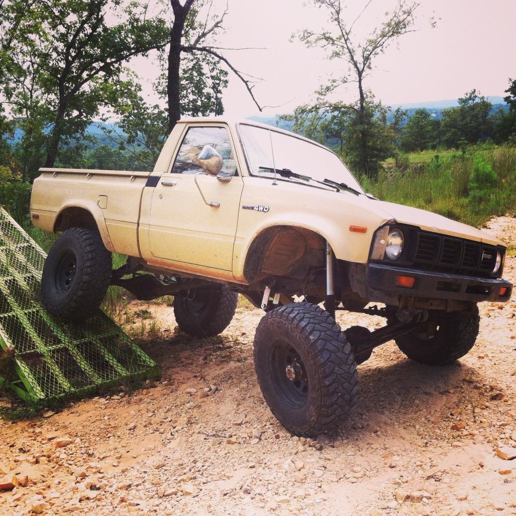

    Maybe I should update this thing every once in awhile?
    Finished my desmog and 32/36 install a longgg time ago.
    Got my sliders from Chad (still haven't mounted them)
    Put my lift on, but no highsteer. Just a drop drag link. Highsteer, 5.29s, and 35's are coming up as soon as I can afford it.
    I'm running a RUF/OME hybrid with 5.5" shackle in the front. 89-95 OME springs with 6" shackle in the rear (soon to be replaced with Chevy 63's), and 12" Bilstein 5125s all around. Gonna go to 14"s for the front because the springs have more and the shocks are stopping it. Also gonna mount my rear shocks vertical through my bed.
    I built a square front D-shaft and bought 4xinnovations tube doors. Both are awesome.
    Here's a teaser. Got some in progress pics, but I'll have to get to those later:
    Plan to bob 8" soon and bedline the bed and floors and get some bucket seats.

    Nope.. Not much lift at all and do not flex worth a crap.. Already got 63s.. Just gotta fab up the mounts..
