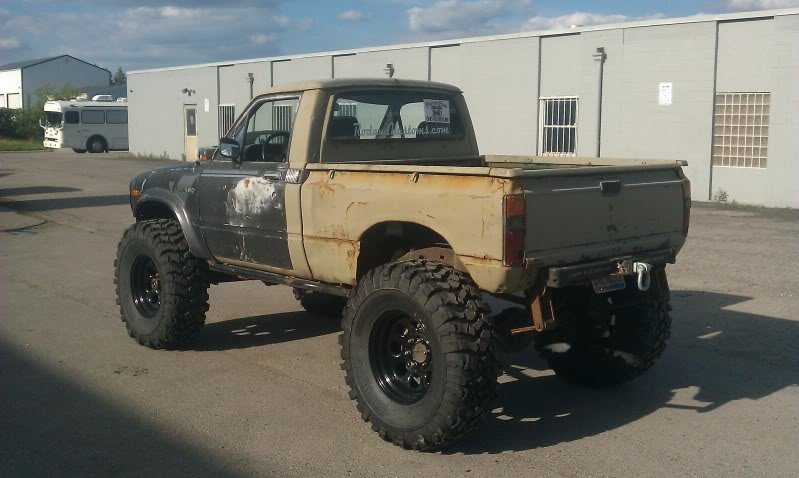

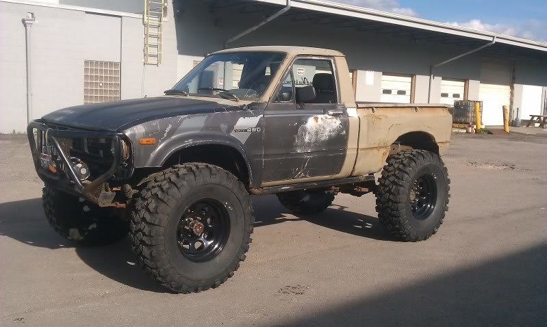

    Got the Chevy 63's on today & officially graduated as an EMT Basic. Just gotta take registry.
    Here's some pics:
    I was trying to keep the front from flexing as much and let the rear do all the work. Need a taller jack cause I could barely get it to come off.
    I had 10" of travel in the rear w/o a bed and with small amounts of unsprung weight. Hopefully once I get some more unsprung weight on the axle it'll stretch out closer to 11"
    I know.. The shop is a MESS!!
    Still gotta cut some old brackets off, etc.

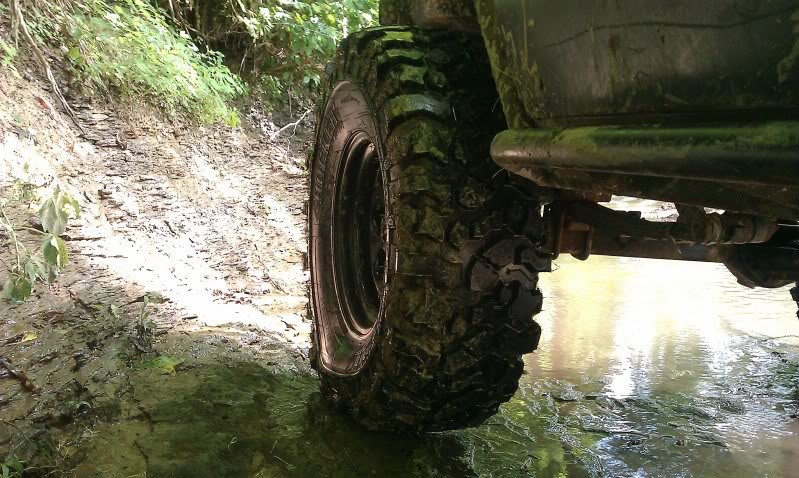

    I REALLY want these tires!!
    37x12.5x17 Pitbull Rocker Radials.
