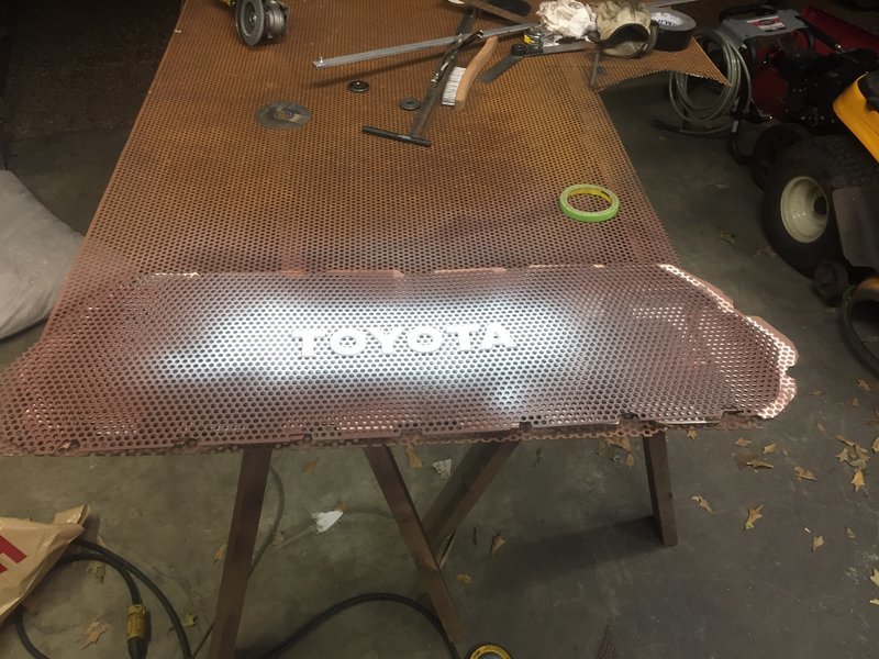

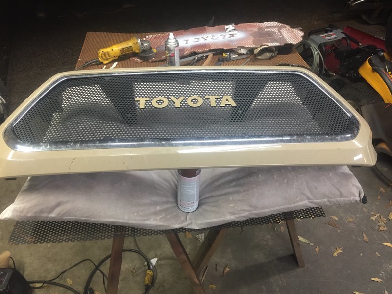

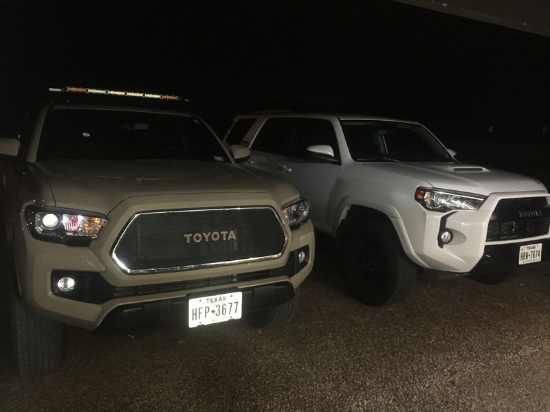

    Wow I'm impressed. How difficult was it to work with the punch plate and to get it cut to fit? What method did you use to mark the diameters before cutting?

    Took the stock grille out, laid it on a sheet of cardboard and traced it. Cut the template out and test fitted it to the grille bezel. Traced the template onto the punch plate and cut it out with a cut off wheel. Took all of about 20 minutes. The emblem letters I cut out of 1/8" plate on the plasma table then rosette welded from the back side.

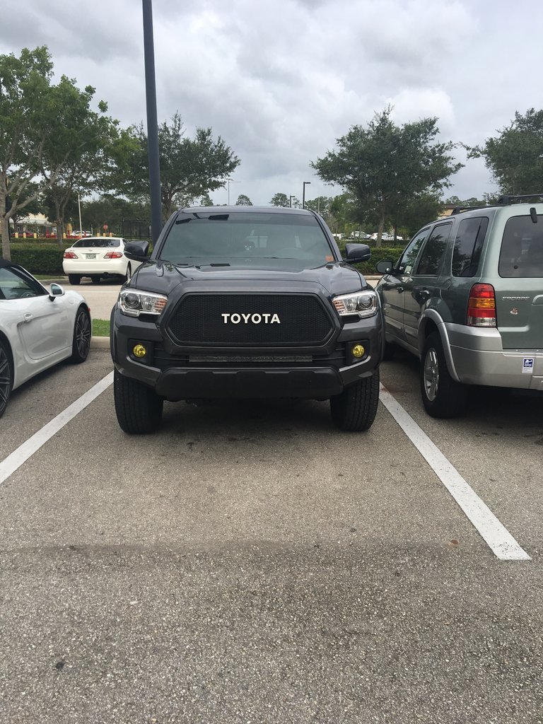

    I did this myself for less than $100 and a few hours of time (mostly waiting for adhesive to dry)
    Custom Car Grills Grille from eBay, $25 FJ style Toyota emblem, 3M automotive body adhesive (for emblem), and plastidip for chrome outer ring. Done.
