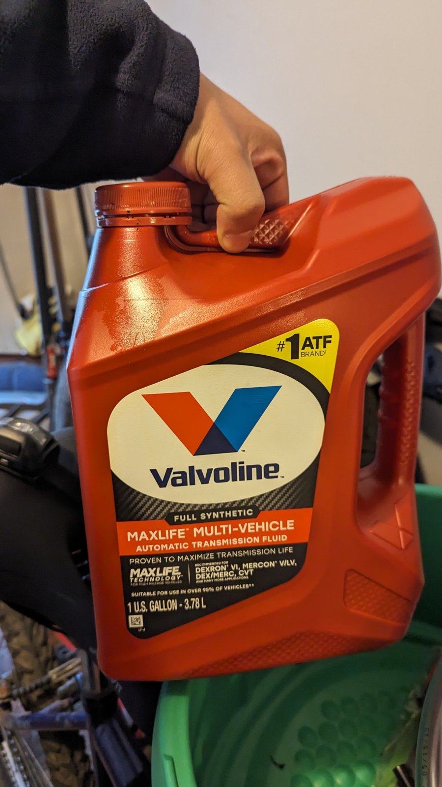

    I ended up using this Valvoline MaxLife Multi-Vehicle ATF fluid for Automatic Trans, rated for "Full Synthetic Dexron VI" as well (which is what Toyota recommends, so I've heard):

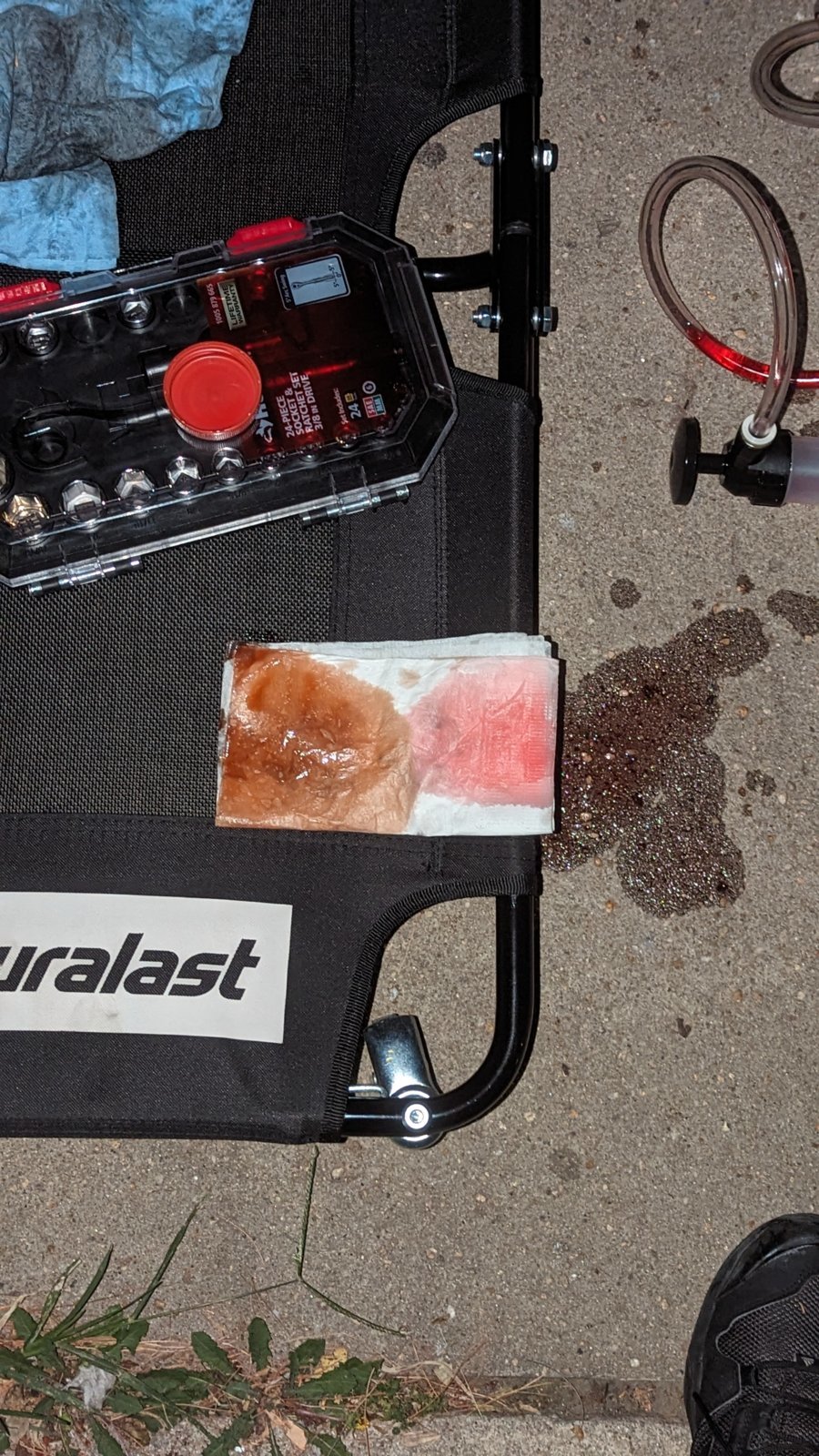

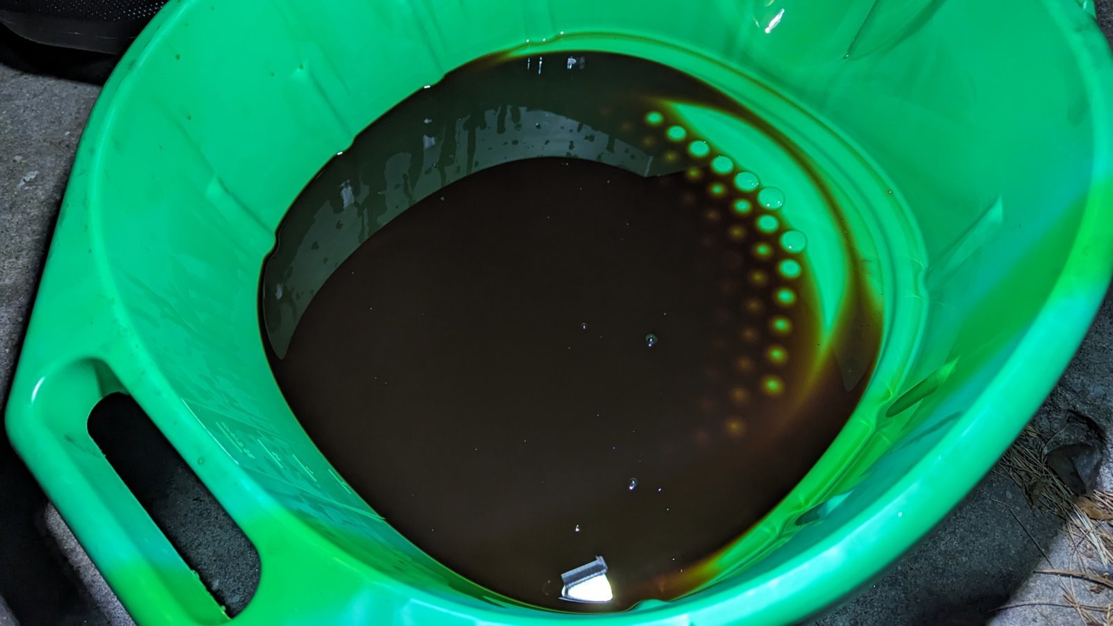

    I checked the old Trans fluid coming out, and with it being dark with a brown luster and smelling like something burnt, it was definitely time:

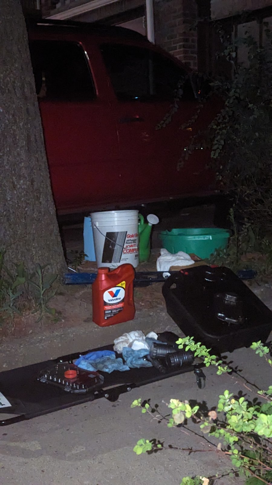

    Here are the overall tools I used. I don't remember the specifics, but again, I followed Mountain Lion's guide on his DIY Guide:

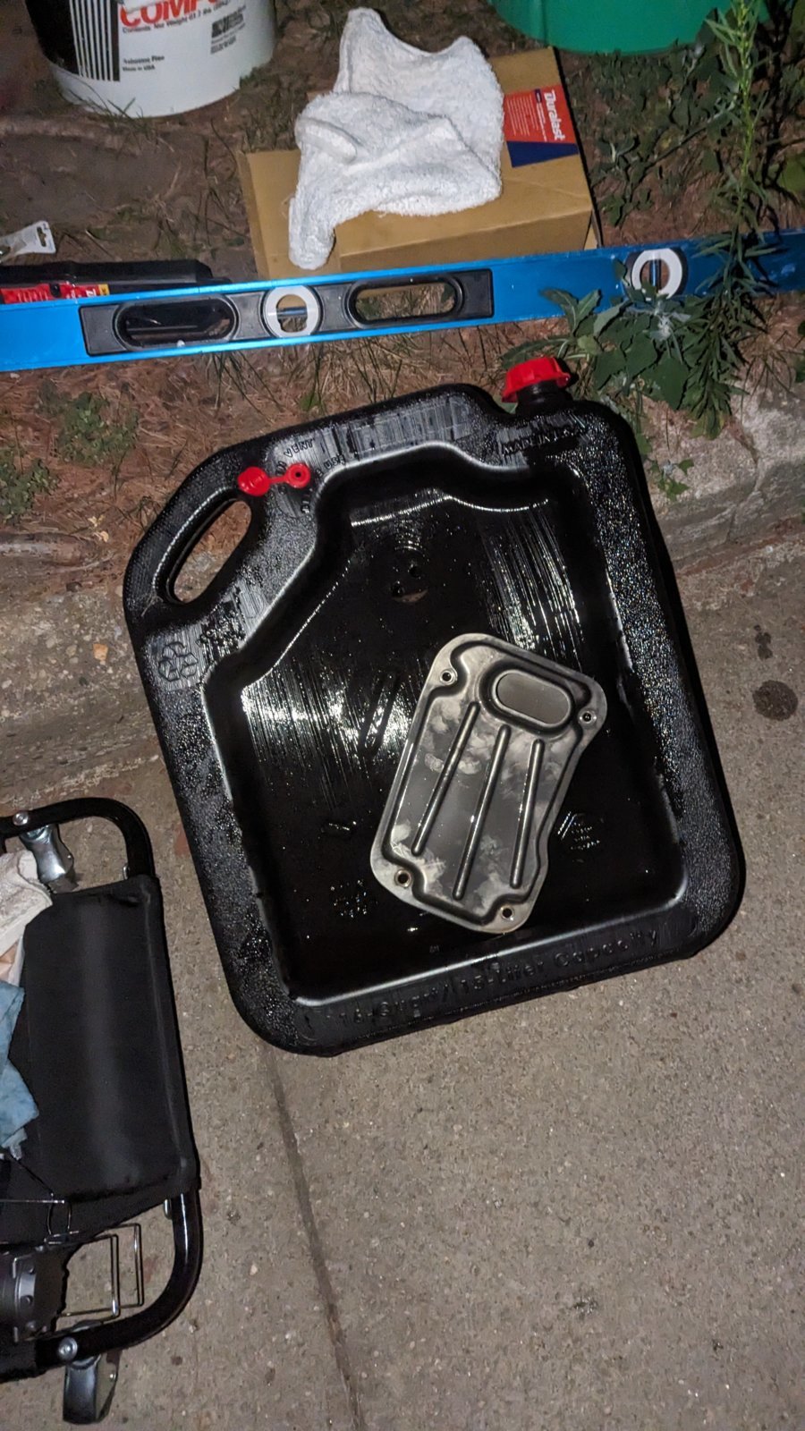

    Here is the old trans filter that I took out and replaced. I found my new replacement in some Autozone - after telling the site the Year, Make and Model of my Tacoma, they were able to recommend me a Trans filter that was pretty much identical to my old one. I still have the packaging box if anyone needs it (DM me or reply here for more info if needed at all):
    And here is the comparison of the old trans fluid I took out next to the new fluid from the Valvoline ATF bottle I got:

    Congrats on doing some DIY maintenance. It can sometimes be intimidating if you haven't done it before, but I'm sure your Taco thanks you for doing it. I did want to call out one thing though, and I am not intending this to criticize you so please don't take it like that. I just want to make clear what the correct specification is from the Toyota user manual so that if someone finds this thread in the future they don't put in the wrong stuff.
    Just wanted to point out that Toyota 100% does not say to use DEX-VI. You should always consult the user manual for which fluids your specific truck calls for. In this case, if you have a 5-speed automatic transmission, the correct spec is Toyota WS fluid. User manuals can be downloaded directly from the Toyota site linked below. Since I also have a 2015 model with the 5-speed auto, I know this spec is on page 529.
    https://www.toyota.com/owners/warranty-owners-manuals/
    Have some people used DEX-VI with success? Probably. Should you be worried about using the MaxLife "multi-vehicle" ATF? Not at all, lots of people are happy with it and that's your choice. I'm not here to debate one oil spec versus another (unwritten law of TacomaWorld says you can only post oil threads on a Friday). Cheers.

    @wi_taco I believe he got the right Valvoline ATF. It appears Valvoline has changed the label. I don't recall there ever being more than one red bottle Maxlife. The spec sheet on their website shows WS compatibility.
    https://www.valvolineglobal.com/en/maxlife-multi-vehicle-atf/
    But I will point out that most transmission mechanics point out to avoid mixing different ATF fluids. In this case they would recommend a flush with the Maxlife or stick with WS for a drain/refill. Since the new fluid is in, I would do another drain/refill sooner than later. That start getting the old stuff out.

    Yeah I should clarify my clarification lol. Valvoline MaxLife Full Synthetic Multi-Vehicle ATF is listed on the label as being "WS compatible" so that fluid is fine. My main point is that I don't want to see other people using other fluids that are for DEX-VI because that is the wrong spec and should not be used as a reference.
    Beyond that I am not getting into debates about how good or bad MaxLife is versus OEM Toyota WS or anything else. No oil discussion. It's not Friday. :rofl:
