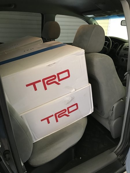

    Wheel and tire package was added (in a believer in this, it paid for itself in less than a year. I live in New Orleans).

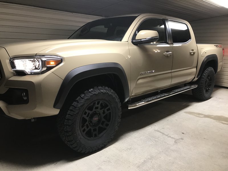

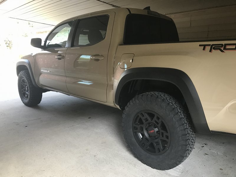

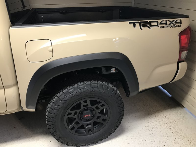

    Wheels & Tires installed. Alignment completed. Set caster to 2.8 (OEM High limit) to prevent any rubbing. Thanks @stan23!! No rubbing!

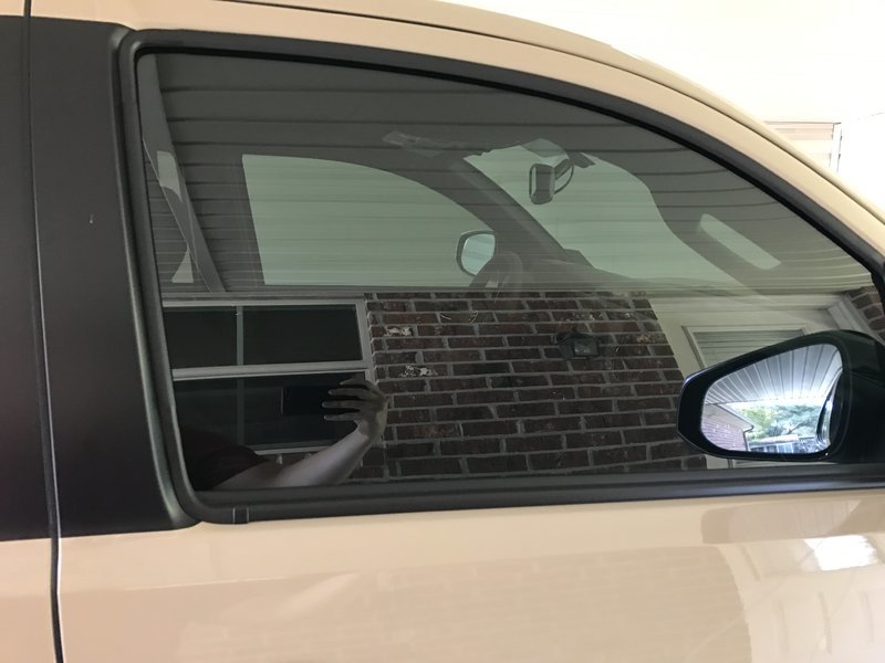

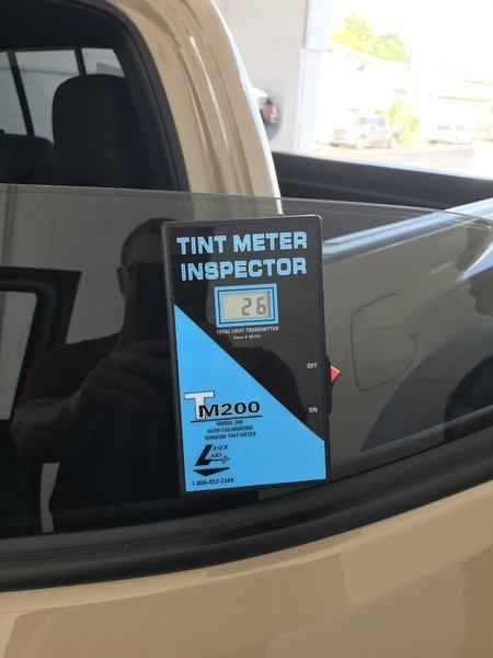

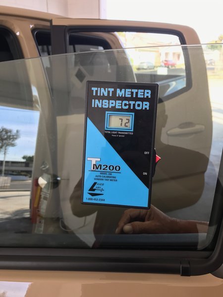

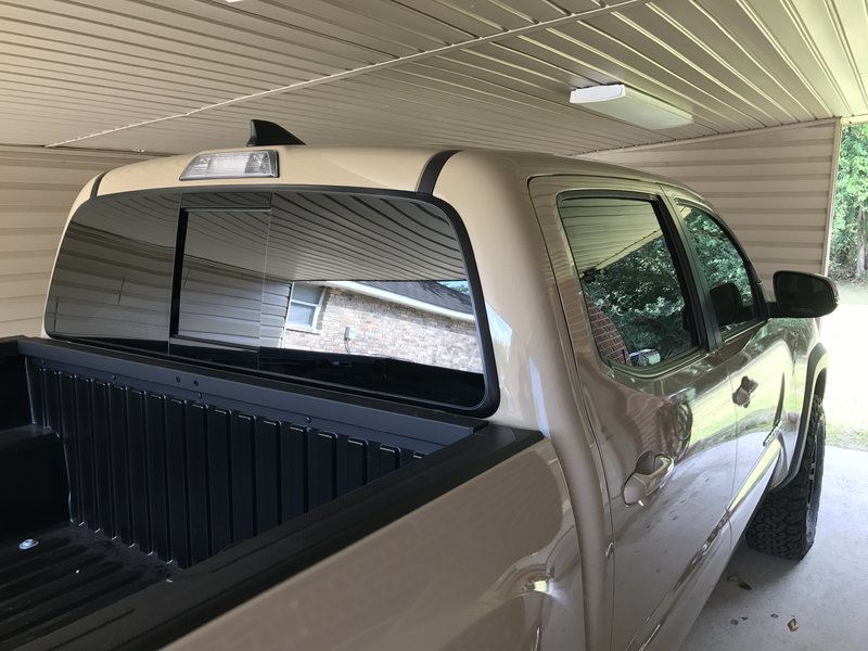

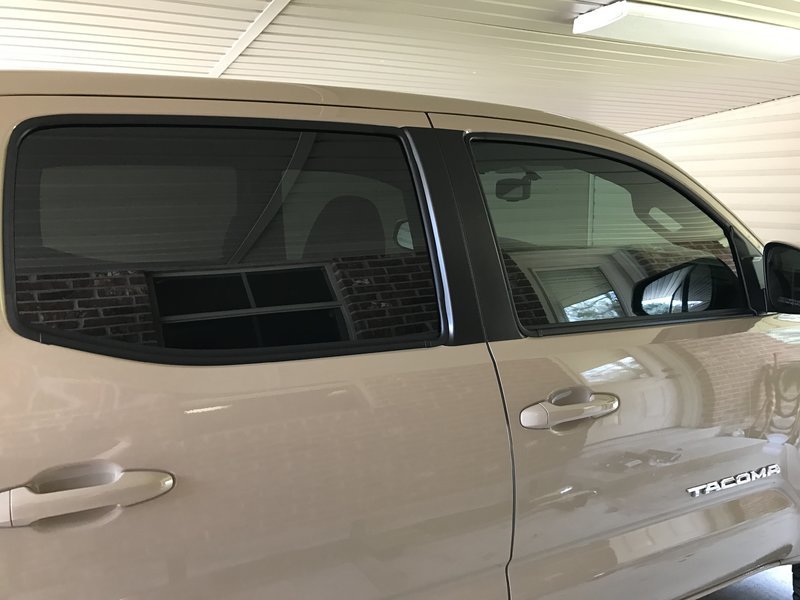

    Window tint installed. Went with 50% in the rear and 30% in the front. I learned that dark tint in the rear absolutely sucks at night. 20% in the front will still get you tickets in louisiana. Trust me, I've gotten 3.
    Stock Rear
    Stock Front
    And the result:

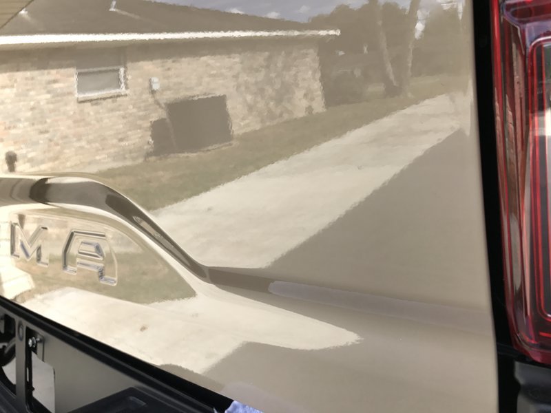

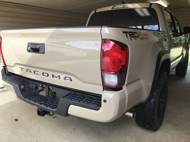

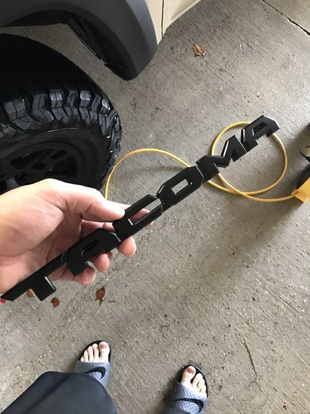

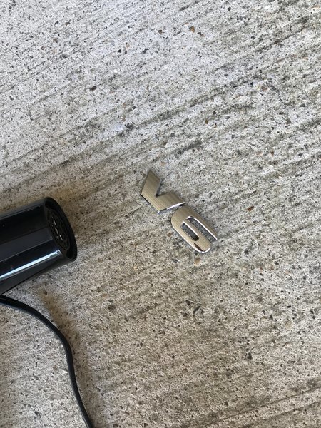

    Removed the "V6" badge from the tailgate. Its amazing how easy this thing came off with only 60 miles on it. Left absolutely no marks when I was done. Hair dryer and fishing string did the trick.

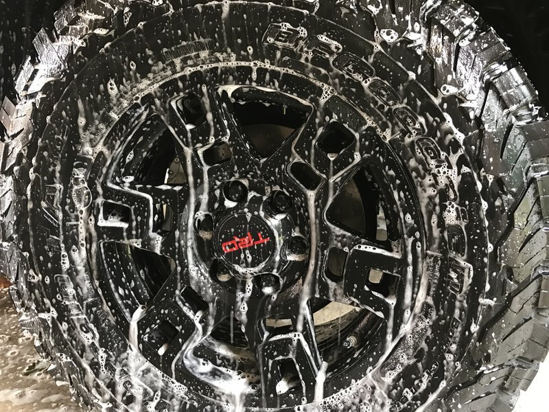

    Gave it its first wash! I didn't let toyota detail it, I was afraid they'd mess it up.
    I only use chemical guys!

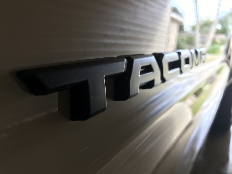

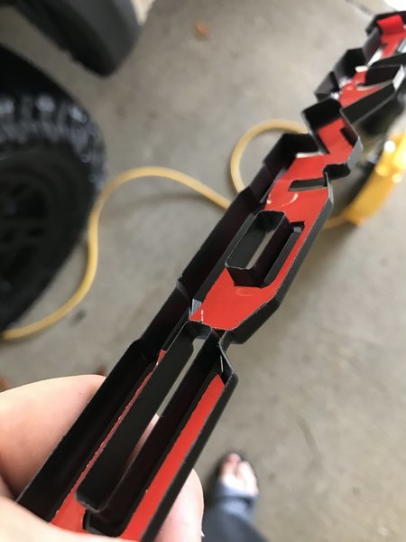

    Installed my nox lux black emblem covers. I'll be selling the remaining I didn't use. I also emailed nox lux about getting a group buy going on just the "tacoma" emblem. :cool:
    Here's some pictures of the back of it and close ups of it on the truck. I couldn't find any pictures like this when I purchased them. This may help someone.
    IMG_0705.jpg IMG_0706.jpg IMG_0707.jpg IMG_0709.jpg IMG_0710.jpg IMG_0711.jpg

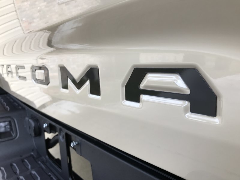

    Now that the back is clean, I can install my tailgate inserts

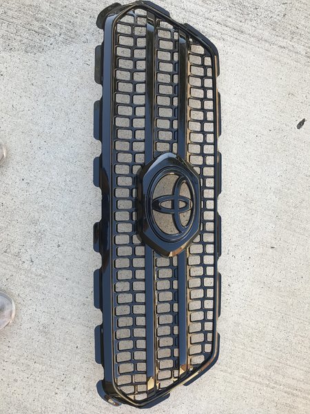

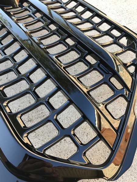

    Got this extra TRD off road grill painted by a local auto shop. Sandblasted, coated, 2 coats of clear.
    Install was SUPER easy. Didn't break a single tab, installed in less than an hour.

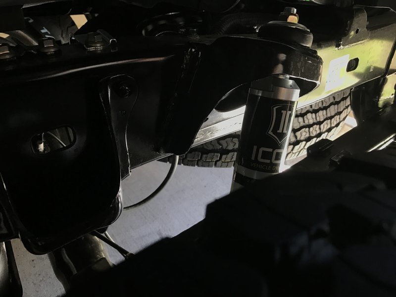

    Installed the rear Icon shocks (PT# 56503). Going to do the coilovers sometime this week.
    11/02/2016

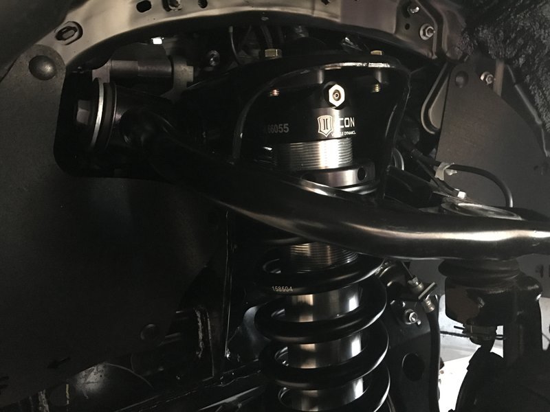

    Installed the coilovers. Pretty damn easy. Ive done this a few times on an 06 and 97 tacoma and the suspension is near identical.
    Came with 15 threads showing, I adjusted them to 13 showing. Sits pretty damn level. When I washed the truck, the water very slightly rolled to the back of the truck. It'll be perfect when it settles out.

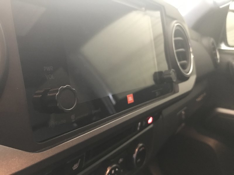

    Hondo Garage Entune Knobs installed!

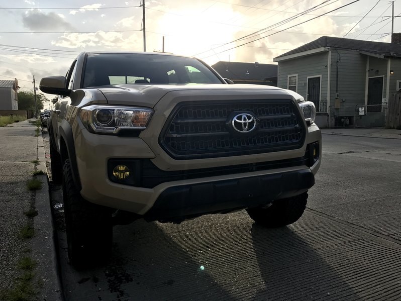

    Added some KC Hilites LED Amber Fogs with Lamin-X film

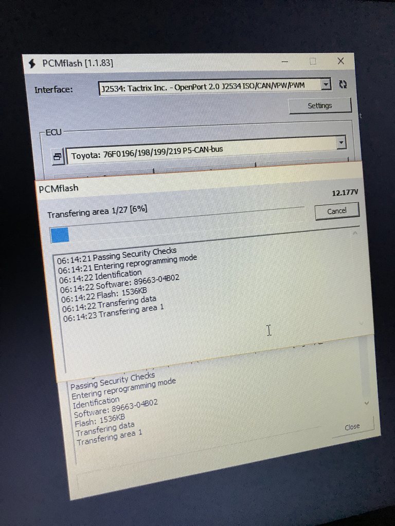

    Unboxing the @OVTune tune. One of the first to get it. I can't wait to pair this with the @Gadget@URD URD Racing SPEC-U Exhaust!
    7/11/2017

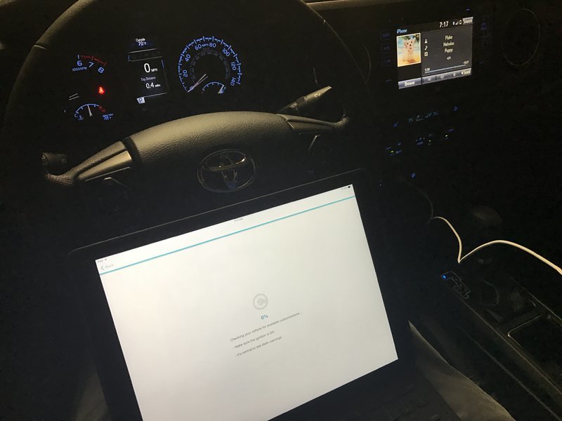

    Tune has been downloaded to the ECU. Review to follow!

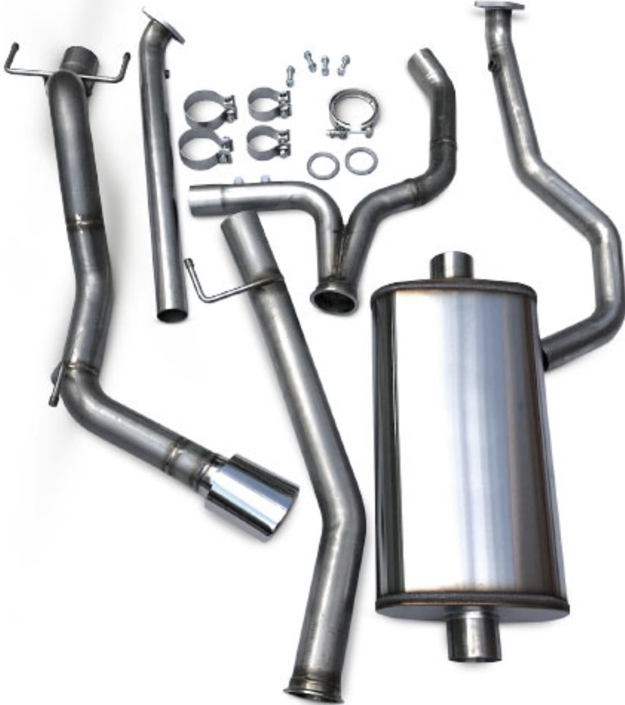

    URD SPEC-U EXHAUST
    Fitment:
    It's not good. I don't feel comfortable showing the underbody to anyone. Hangers are stretched. The center part where the "Y" meets up isn't right. I played and played with it and right now I got it as best as I can. The O2 sensor on the passenger side hits the transmission lines. Gadget is sending a new piece in 1-2 weeks to fix this. I'm also not sure why URD decided to NOT use 2 of the OEM hangers. Maybe for easier installation? Weird. The only hangers the exhaust system uses is 2 on the muffler (which are stretched) and 1 on the tailpipe (also stretched).
    After talking to another owner, his URD setup has one of the hangers. This is just damn ridiculous.
    More more R&D needs to go into this.
    Sound:
    People have said "sounds like stock under 2500 RPM" that's a lie.
    It's clearly different than stock at all RPM. Deeper tone all around and a slight drone around 3k. I expected it to be quieter based on other people's feedback.
    It's not a terrible sound. I wanted stock below 2500 and moderate/loud above that.
    At 1500 RPM with a load (say im doing 40ish and decide to accelerate without letting it downshift) the drone is quite loud. Maybe it will get better once the muffler packing settles in.
    Performance:
    Too early to tell. I want to let the ECU adapt to the changes. It does feel better on the low end, but then again, I have the @OVTune 1.01a on the truck which tremendously improved the low end. I'll do more driving and report back.
    The good:
    I'm happy to look at my truck from the side and not see the damn crossover pipe as the lowest point on the truck.
    Low end torque is improved. Other people have stated this as well.
    Once it's warmed up, idling tone is identical to stock.
    It doesn't sound like a civic.
    The bad:
    Fitment (see above)
    Should have an option for a resonator
    Chrome Exhaust tip is the only option
    Drone at certain RPM ranges. 2200ish and 1500 under load.
    Fitment
    There are 2 exhaust hangers that the factory exhaust uses that this system does not use...

    Dowload screen for 1.01B

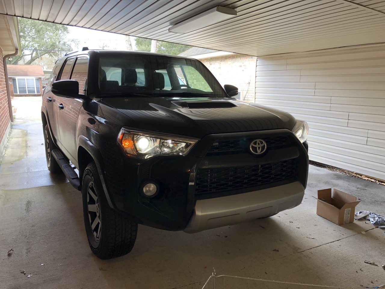

    Added Morimoto HID kit. The output is phenomenal! No bounce that I’ve noticed. But, there is some radio static.
    Install was a breeze!
    Also ordered a second kit for the 4runner :cool:
