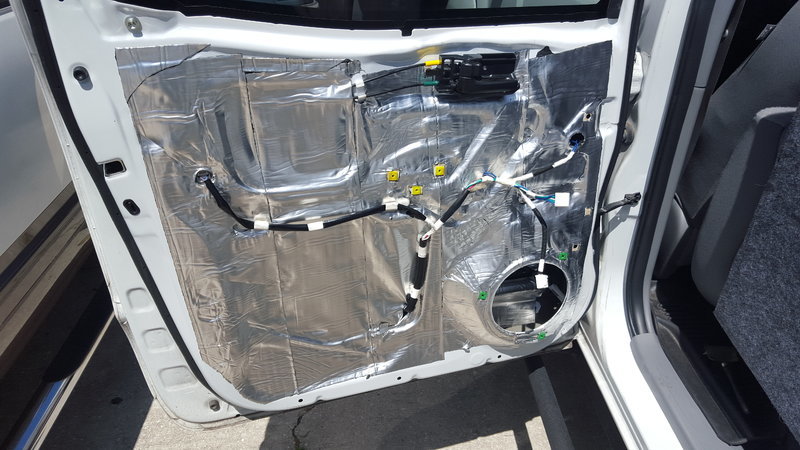

    I did 85 ish percent on inner door and 100 on the visible panel you see in pic. The other back door i dod like 25 percent on inner door and 100 on visible part(except the hole that vapour sheild used to block) and let me tell you this door is way more solid sounding now and way more deadened than the other rear, i plan to redo that door. I used the peel and stick from lowes so it was cheap enough that i decided to use it as a vapour sheild too

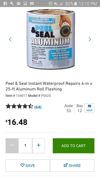

    Peel and stick from lowes is 16 bucks for 12 sqft

    P&S is application specific for household roofing, as is Dynamat/Second Skin/RAAMmat/ect is for automobile application.

    What exactly is this stuff called? I'm trying to find it on the Lowe's website.

    boostedka[QUOTED] likes this.

    TS2F tested that stuff & found it to be worthless as a damper. IIRC there were some chemical concerns with it as well as heat tolerance issues.

    Mine isnt as flimsy as that stuff in exos roof. It was quite rigid

    I'd be interested to hear how it holds up through a Florida Summer.

    Ill check it out when i change the rear door speakers out. The backwall held up perfectly fine for 5 months so far. And even if it was crappy the floor should still be fine. I never had any intentions of uaing it on the roof however, i was gunna use the good stuff up there. My roof flex is bad so i plan to do some legit stuff up there
