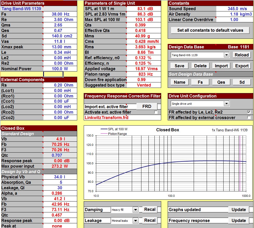

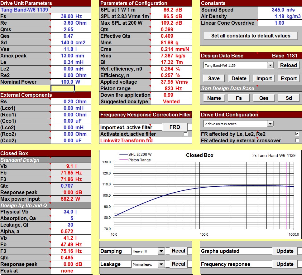

    Of course. Amps like the JL with RIPPS and the PDX series are a nice little exception.
    I run the JL in my Tacoma for those reasons as well. I don't think anyone here will really notice the change in dampening factor though. You also left out that every time the impedance is halved you double the distortion. It's likely to be inaudible on most normal systems.
    It was a nice touch though that the JL makes 500 at 4ohms. I'd gone from running those Tang Bands at 1ohm on another amp (which was wonderful) and now I can raise it to 4.
    I don't believe so. Try modeling some subwoofers like I've done in Unibox. As you can see from the data, two subs results in the efficiency of the system going up 3db. (top middle column) When you graph the results and throw 200watts at the system instead of 100 on a single sub you gain 6db.

    that messed up, although there are many variables there that could cause the extra gain.

    Pretty crazy right?
    And I think it goes without saying that when we talk about 3db or 6db gains it's approximate and not an exact value. It should be close though.

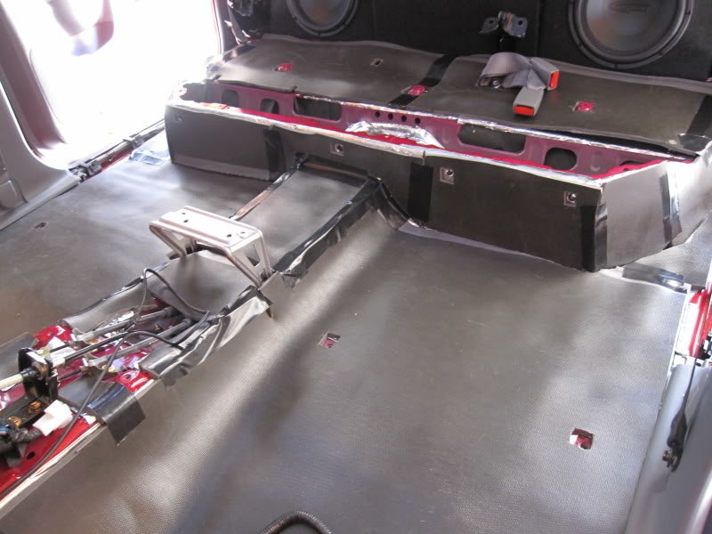

    If you're looking to block road noise the proper material to use is Mass Loaded Vinyl. Dynamat is for resonances.

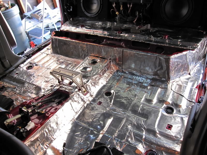

    Yes, foam wont do much. You don't have to add too much weight though. I did the whole truck and added 55lbs of MLV....and that was the WHOLE truck and all 4 doors.
