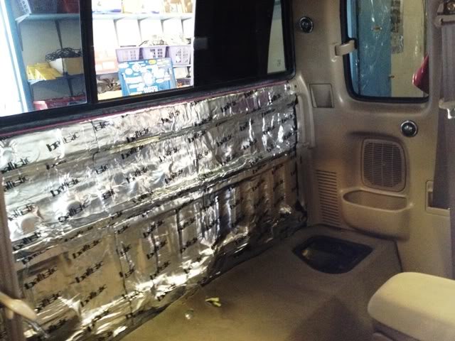

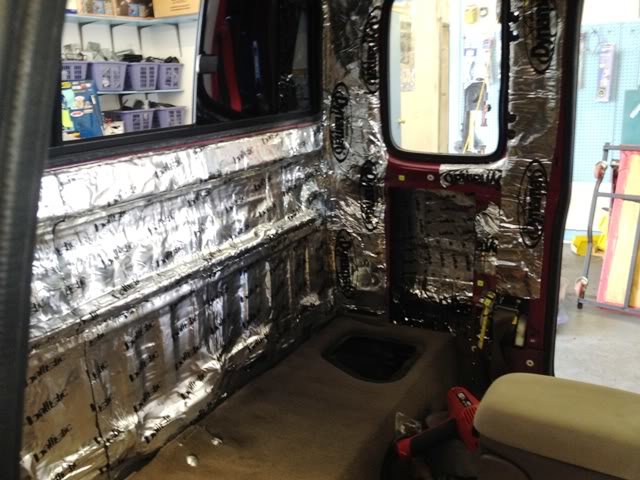

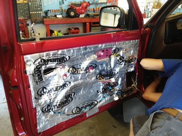

    Yes to sound deadening...totally worth it:
