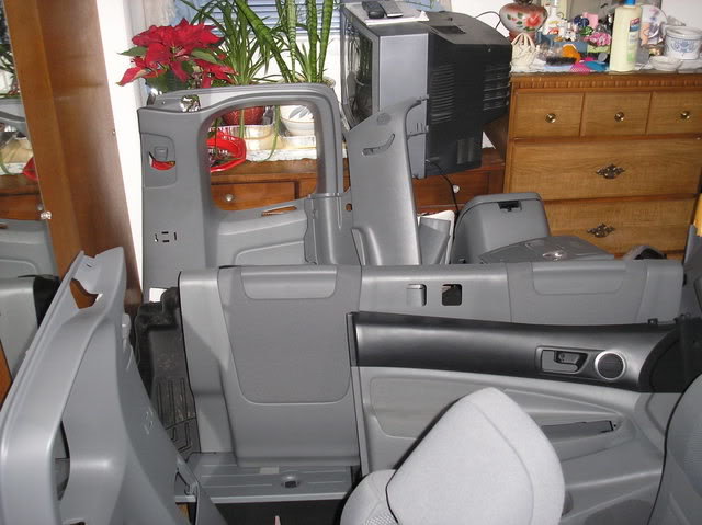

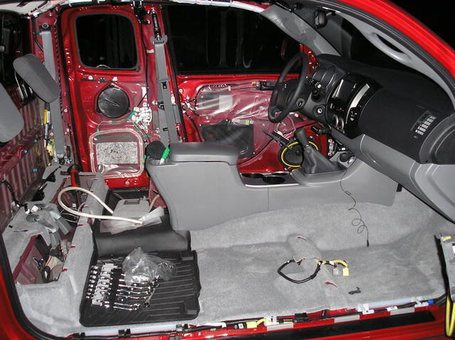

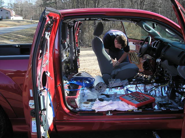

    the install isn't hard at all its just extremely time consuming...if your like me and went all out by sound deadening the whole cab you will have to remove all the door panels, roof, seats, rear firewall, carpet...and some other stuff...
    here's pics of my buddies truck...I didn't take any of mine cause I wanted to get done...lol

    I don't think i'd be able to put my truck back together after that....let alone take it apart.
    I was able to get the door pannels off to do the leather arm rest mod

    its not hard to keep track of all the bolts and screws and where they go...
    this is how I do it...
    when removing any parts whether interior, exterior, and even engine components I take things apart 1 side at a time and have all the bolts and screws in size all together in direct line of site of that part that it came from...that way when putting everything back in reverse order you have everything directly in front of you and its almost full proof...:D
