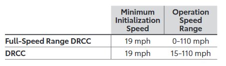

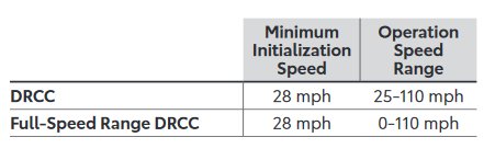

    It looks like Toyota has Dynamic Radar Cruise Control (DRCC) and also Full-Speed Range Dynamic Radar Cruise Control (DRCC) on select vehicles. We have TSS-P on the 2018-2021 Tacoma with the basic DRCC. There is also a TSS 2.5 and 2.5+, but I couldn't find the DRCC specs for those.
    TSS-P
    TSS 2.0
