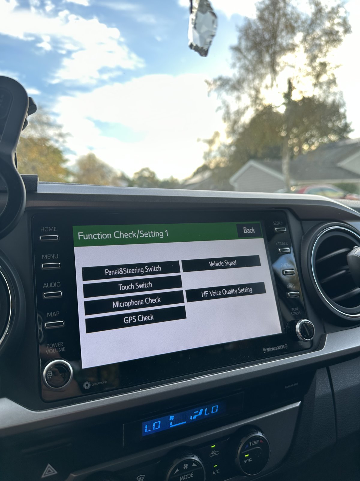

    I’ve tried this, attached is all the buttons in my “functions” menu no “camera” setting. That’s where I’m stuck.

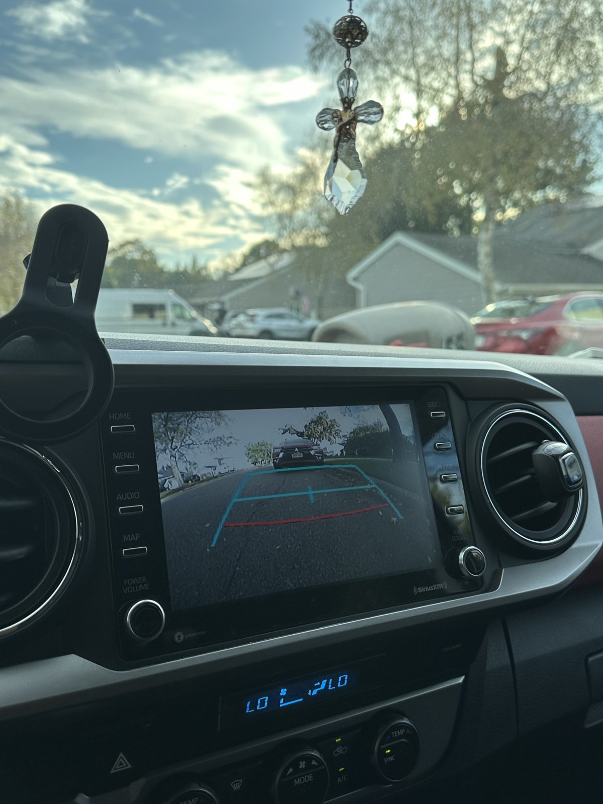

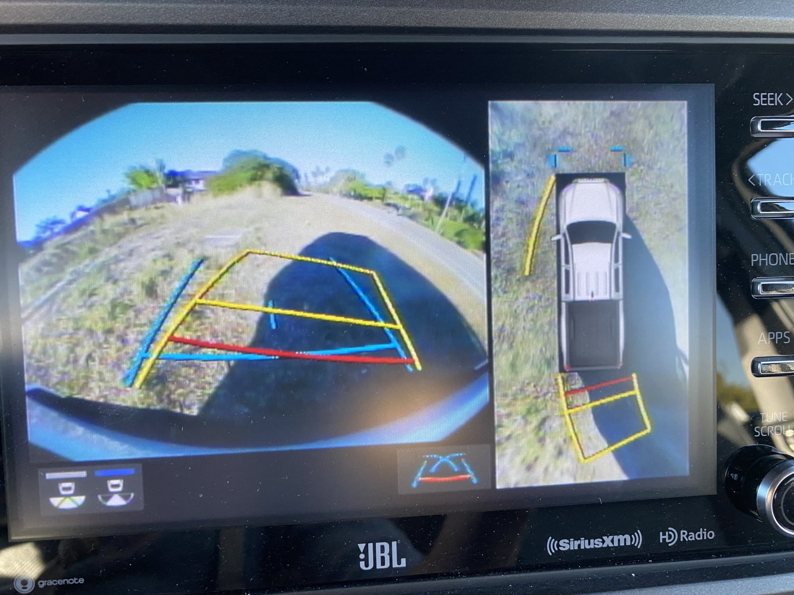

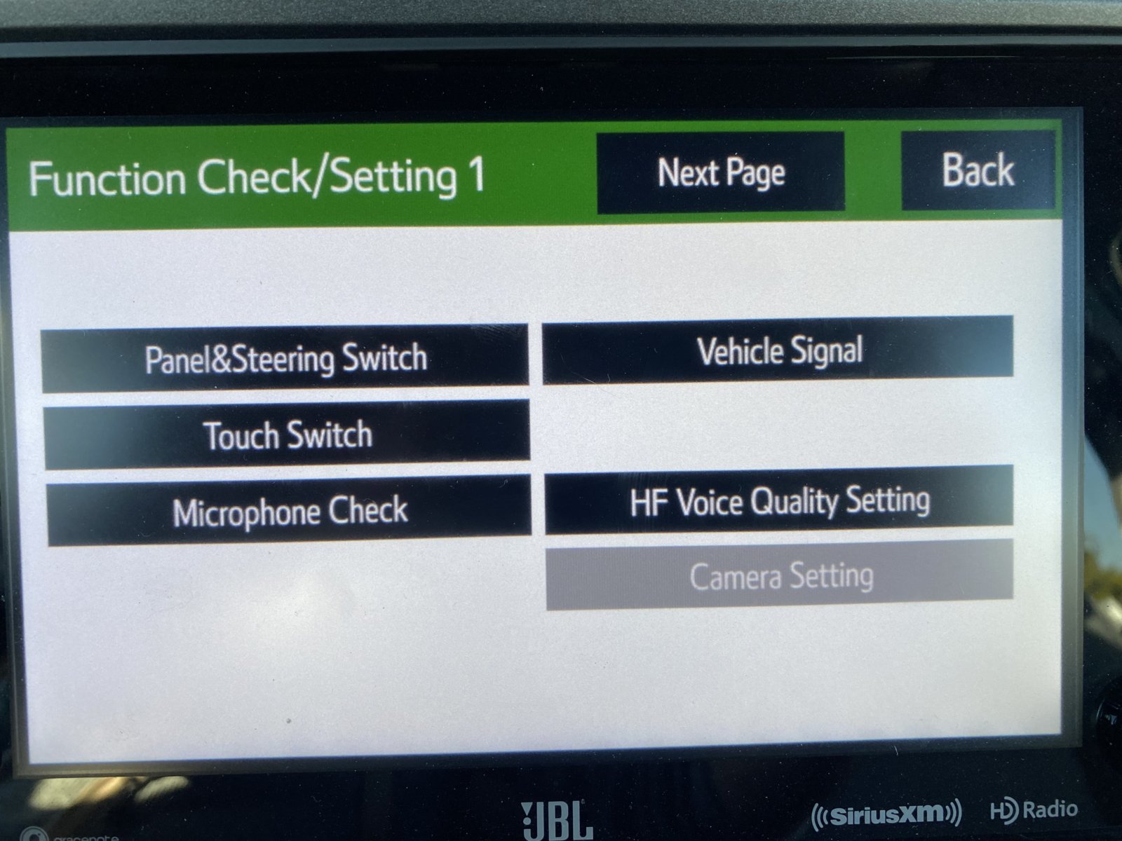

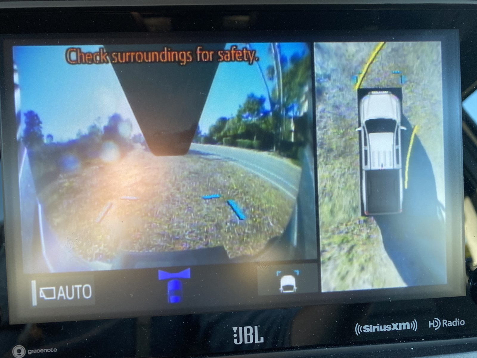

    On my 23 OR premium the yellow lines track with steering wheel rotation. Useful in the LB in tight spots. OP here are some reference pics to refer to, guessing yours is the same.
    The last shot shows the grayed out Camera setting you aren't getting. Guessing your camera isn't detected?

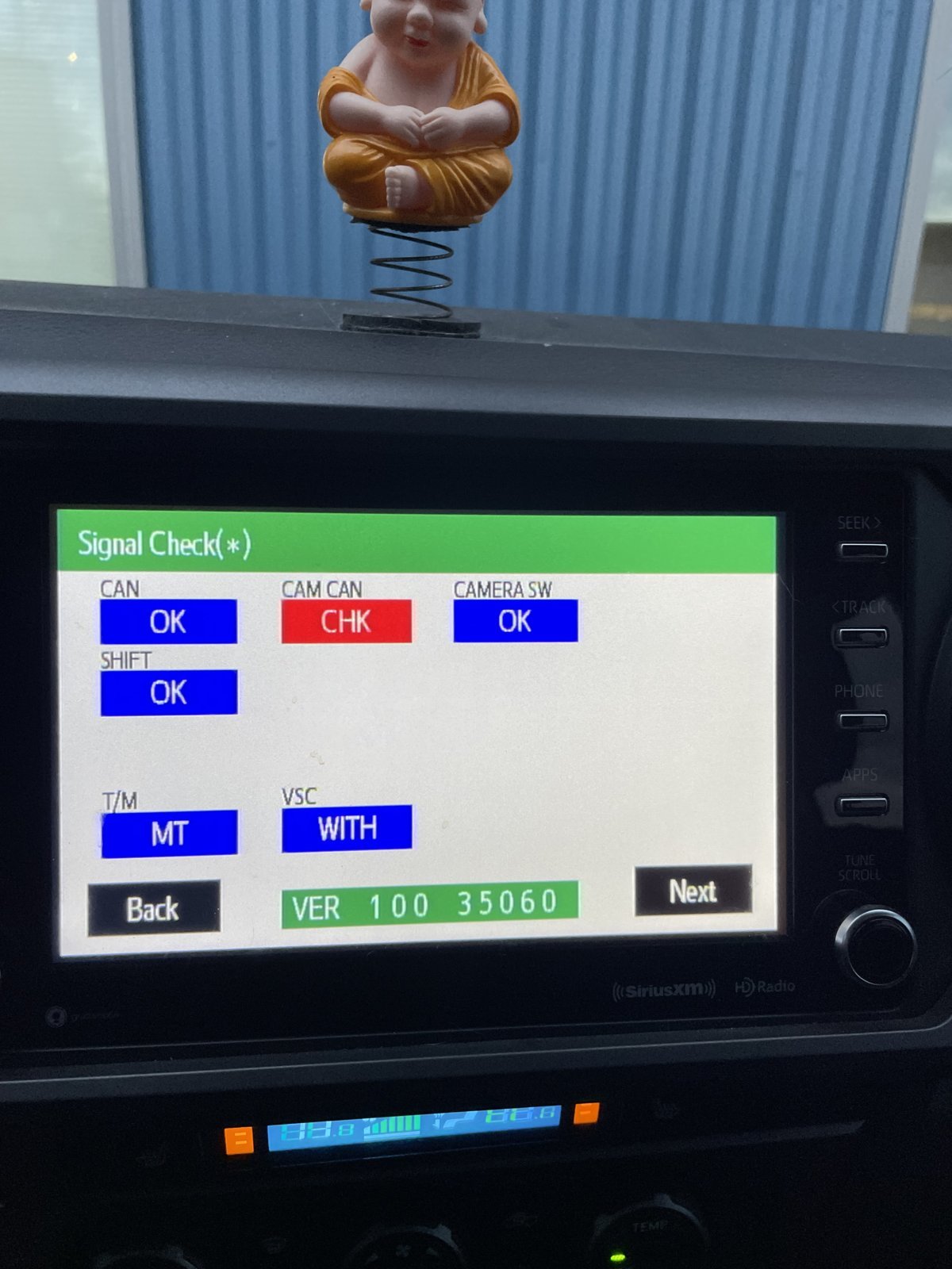

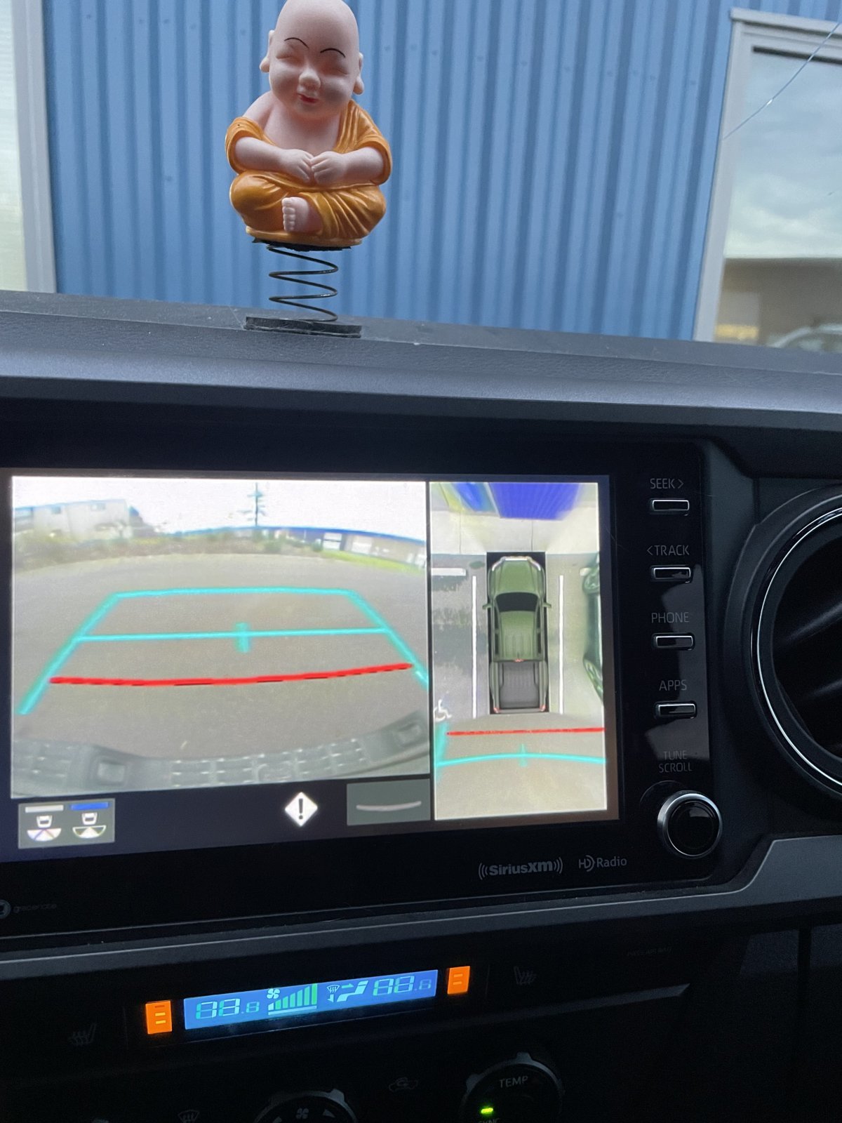

    I installed a new camera for a relocation, and I opted for the less expensive 86790-04040 instead of the 867B0 (which is the oem for my truck with the panoramic cameras). I don’t mind the cameras not meshing perfectly, but I would love to turn off the dynamic lines. I can’t do this as there is an error on the screen. When I go through to change the steering settings it just shows a screen with signal check.
    Anyone know how to get around this?
