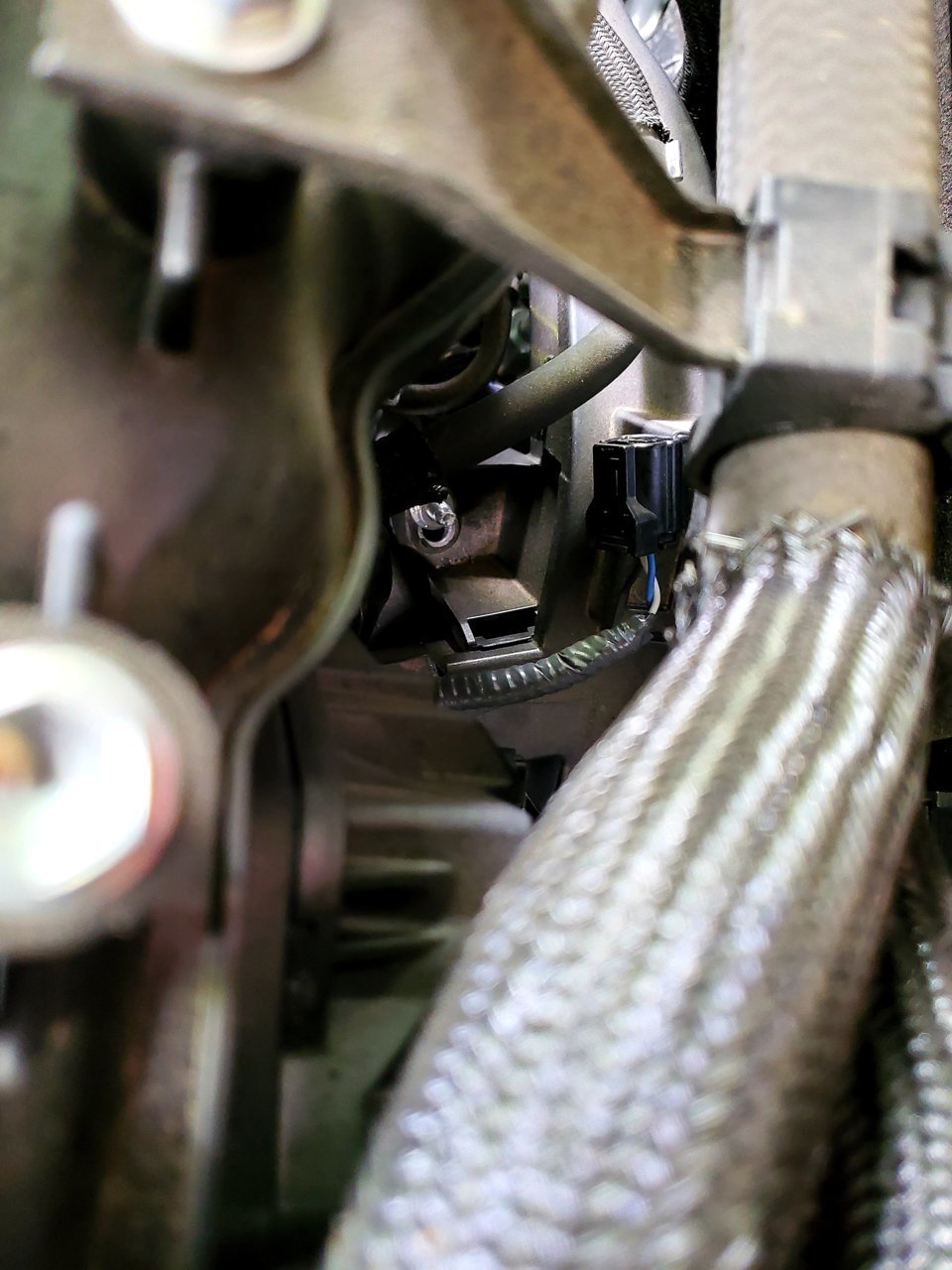

    Can someone post a pic of the connector to the ACIS? I want to disconnect mine now.
    And then I’ll get off this hijack...

    It's buried in the what did you do to your truck thread.
    On the back of the engine near the heater hoses. It's the two wire plug. One blue and one white wire
    Access from the drivers side
    Rujack likes this.

    Found it
    Rujack likes this.
  9. Oct 31, 2019 at 5:11 PM
    #69
    Rujack
    Rujack Stop Global Whining
    Aug 16, 2016
    #194732
    2,447
    2016 Tacoma TRD Off Road 6 speed manual
    Awesome, thanks!
