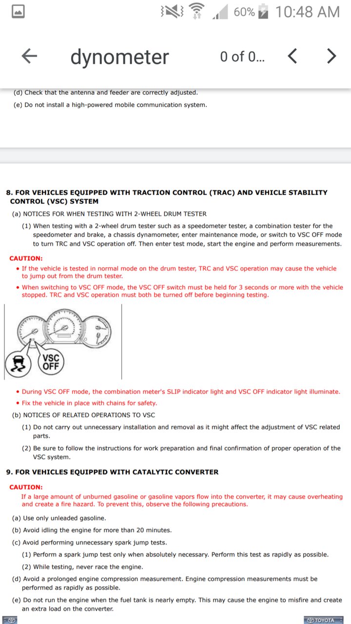

    Truck is 17 manual trans 3.5L. Searched but could not find an answer specific to third gen Tacoma’s. I will be doing some dyno runs soon. I need to know if all I need to do is hold VSC off for 3 seconds while at complete stop to completely shut off traction control and vehicle stability control to make the runs. Don’t need a Toyota sneak attack while strapped on the dyno.
    Those of you with dyno experience please chime in.

    Thanks for the info. Confirmed with @tonered all that’s needed is to hold VSC off for 3 seconds while stopped. That disables everything until truck is restarted.
