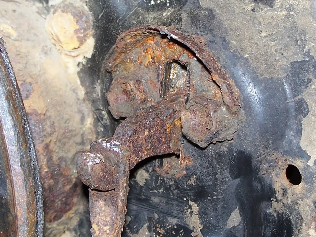

    Not sure, but the bell crank sticking is relatively common amongst at least the 1st gen Tacomas and previous gen Tundras. They were frozen solid on my 02, but with a little persistance and a lot of penetrating lube, I was able to free them up.....didn't have to replace anything.

    Same thing with my 98. I removed the pin and sanded down the clevis and then reassembled.

    Here is what mine looked like.
