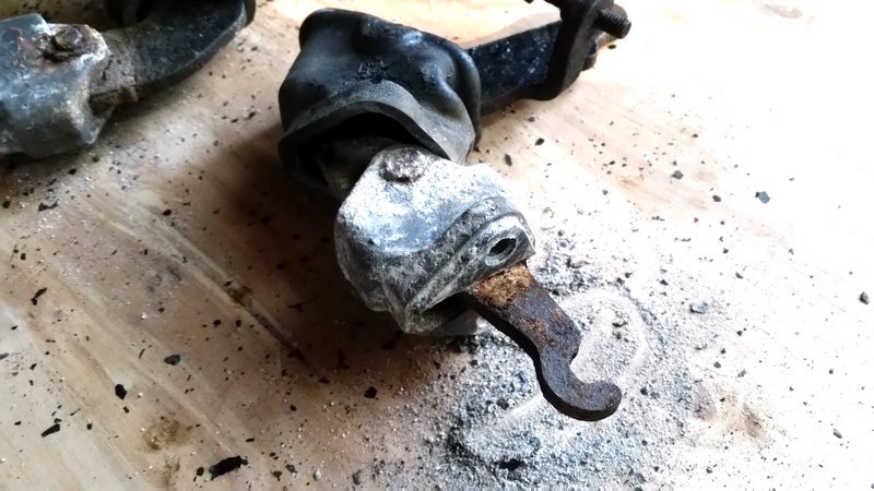

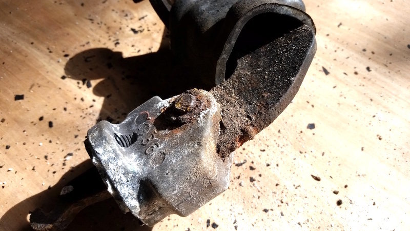

    I had some seriously siezed up and corroded e-brake bell cranks on my 2001 TRD that I bought earlier this month. E-brake light was on all the time, and the e-brake didn't work at all. Also, my brakes felt pretty mushy in general, even tho the P.O. just redid all the brakes before I bought it. Dealer wanted $598 to replace them...I did it for $35 and a few hours of my time. Here's the crusty ass bell cranks after I removed them...
    Truck was originally from Connecticut, and you can see the road salt deposits all up in those muthas. I replaced the whole assembly on each side with a complete set of new Dormans....this is what I bought:
    https://www.amazon.com/Dorman-924-751-Parking-Brake-Crank/dp/B00C89QV18
    They went on fine and were an exact replacement. Issue now is that I think the front and possibly the rear e-brake cables are stretched too much and probably need to be replaced. Right now I have some of the slack in the front cable taken up by pulling the cable to the side and tethering it to the frame. I was only able to adjust the front e-brake cable lever under the driver seat area so far before the nuts stopped moving, and the cable was too sloppy for what that adjuster was able to take up anyway. For now it all works....the e-brake holds after about 15 clicks, the the light goes on and off as it should, and even my brakes don't feel mushy anymore. But I know I need to replace one or both cables at some point. Anyone have any pointers for how to replace those two cables?
