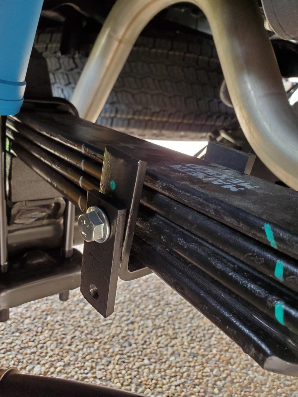

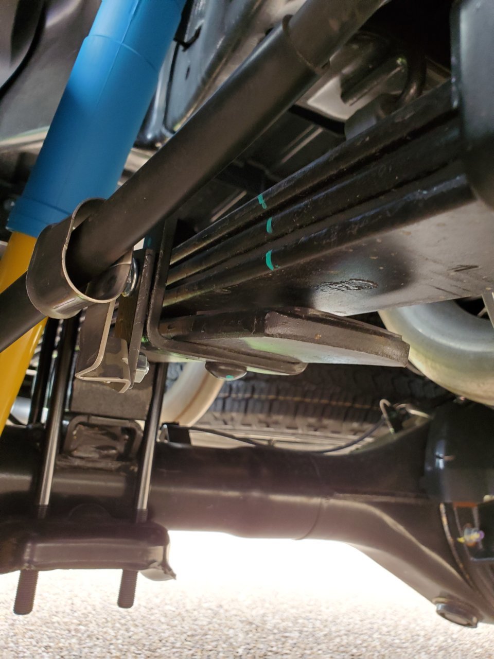

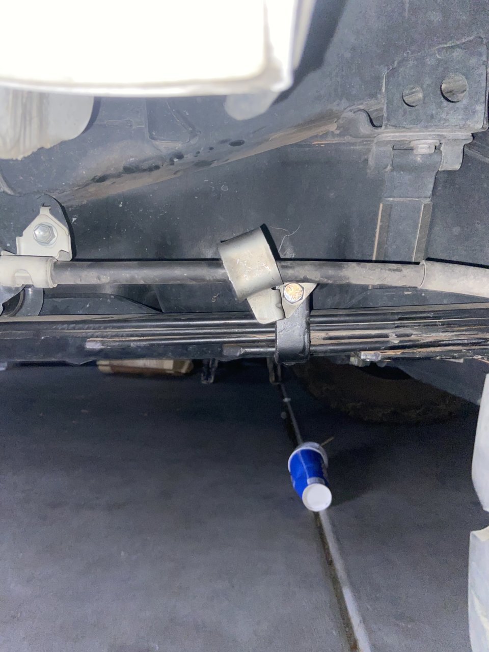

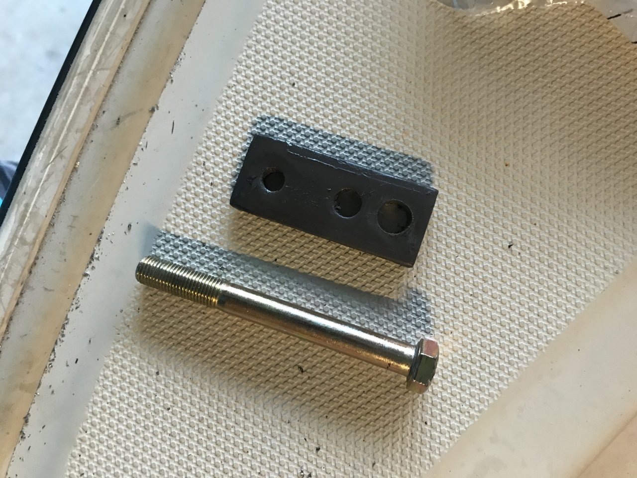

    I finished a Ready Lift SST 3" lift and had the same problem with the brake line being to tight to mount back to the original location. I came up with a similar solution by creating a drop bracket. Now I have plenty of slack. Thanks for the ideas and lucky I had the material laying around the house.

    I have the same rear set up. Do you mind sharing what bolts/nuts/ size that you used. Also how long is your drop bracket? Thanks!
  4. Dec 13, 2020 at 6:46 AM
    #24
    Two Yutes
    Two Yutes Well-Known Member
    May 21, 2020
    #328816
    46
    2020 TRD Off-Road
    3" Ready Lift; Bakflip MX4 Bed Cover, Meso Customs Total Tail Stage 1 Tail Lights, Raptor Grille Lights.
    The bracket is 3" long and is the same width as the original bracket. You can go to your local hardware store and find exterior plan hot rolled steel that you can cut. Then you'll need to primer it and paint it. I used a spray paint designed for bumpers, because that area will get rocks and dirty and stuff hitting it. You might find small pieces of steel at the automotive store as well. The thickness is the same as the original bracket. The new bracket doesn't have to be very think, it isn't supporting much weight at all. I've seen in other post some people just leave the bracket off all together. As far as the bolt, I took the original bolt with me to the automotive store and found the same size but as a bolt/nut. You could use a tap and die to thread new holes, but that is more work than is necessary. The length of the bolt is about 1-1/2". Long enough to go through both brackets and for the nut with lockwasher to fit on. In keeping with the rest of the Tacoma the nut is a 10mm.

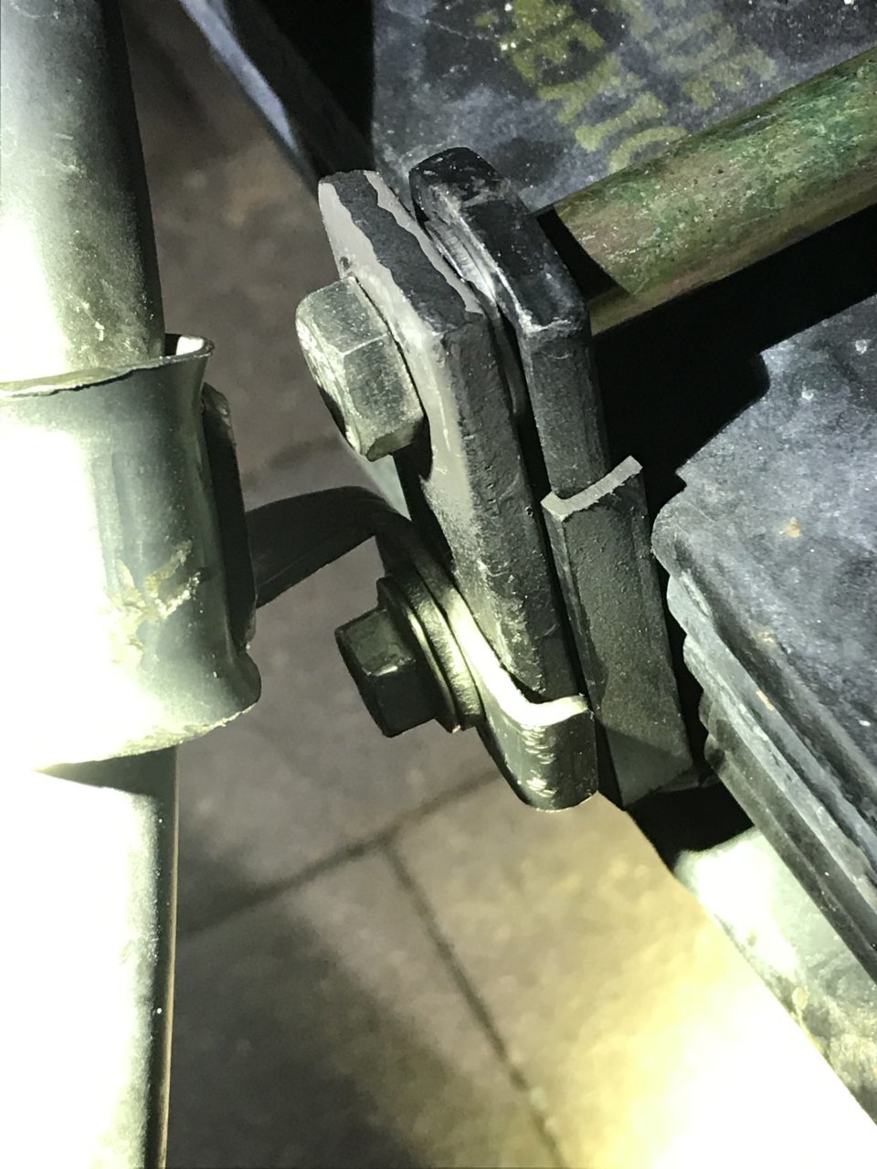

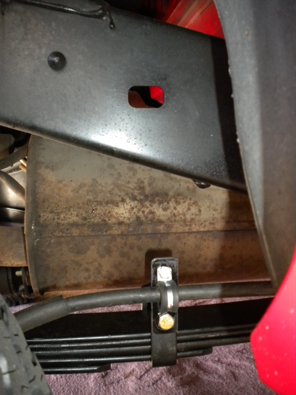

    Thanks to Two Yutes here’s mine installed. 68C85C63-44FA-4FB1-BEE6-6F68A63A1435.jpg

    Sweet. Did you drill a hole n thread it on clip?

    Yes, I did.

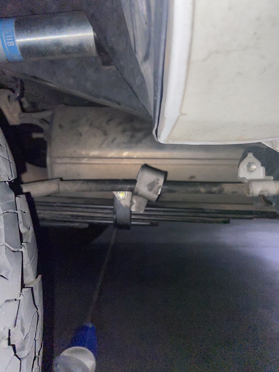

    Where I put mine. Should it be ok there? Just put icon rxt leaf pack
    Thanks
    71tattooguy and Greatdane01 like this.

    Looks just fine to me. I did similar
    RickyG1[QUOTED] likes this.

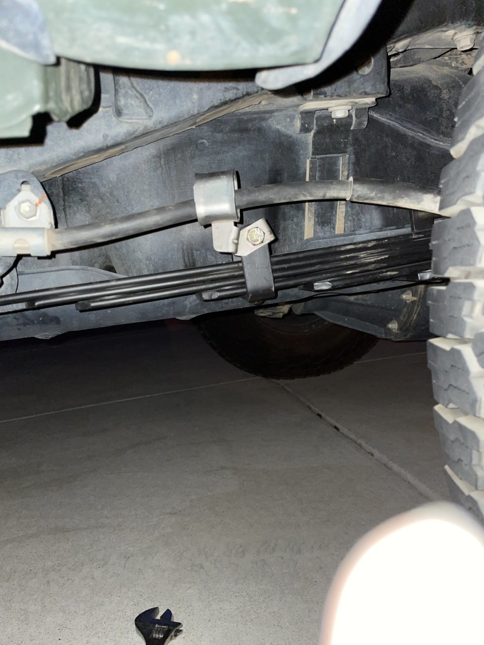

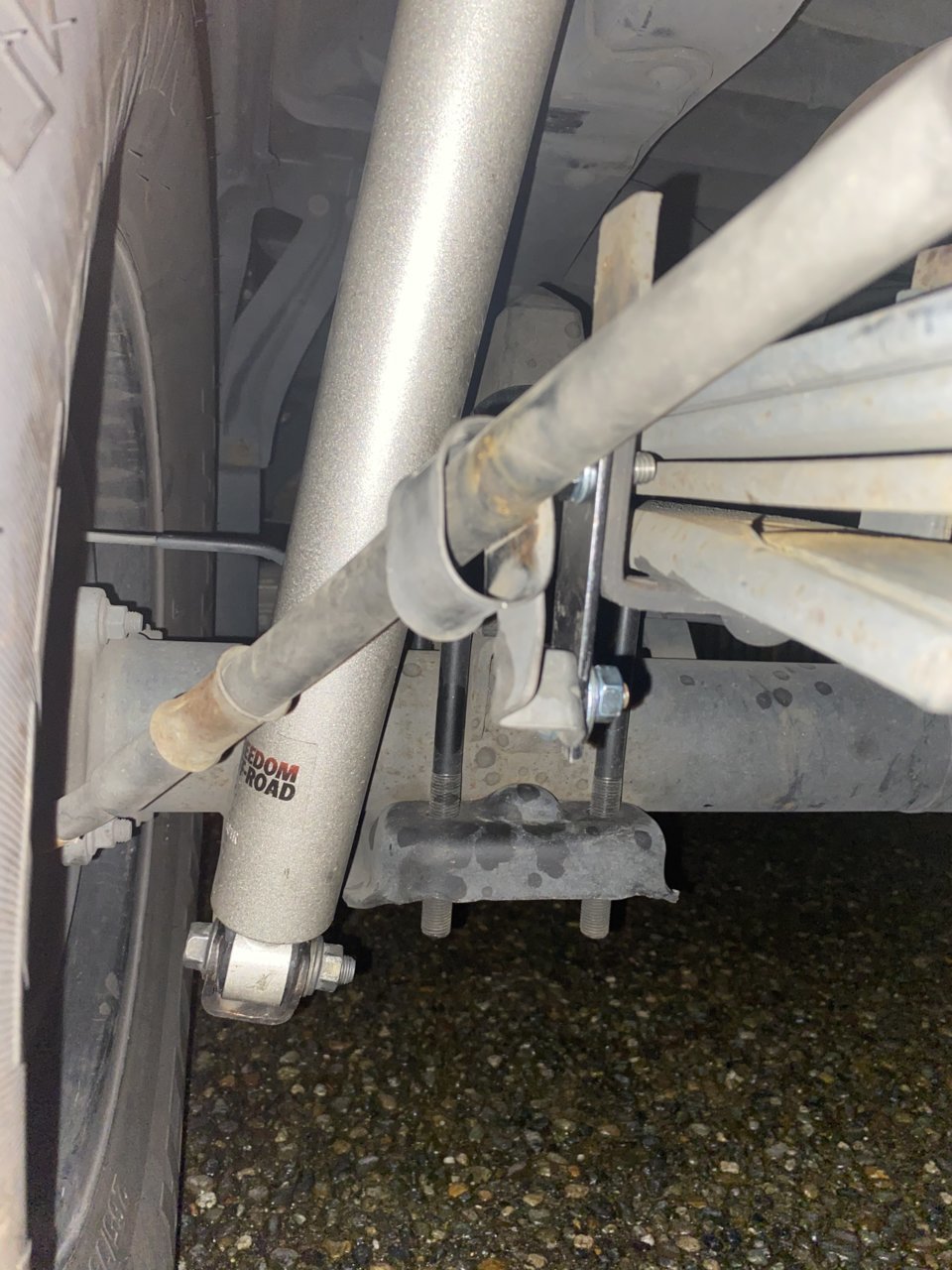

    1F119A0B-6F3F-4797-A9B6-0608E6E8550E.jpg BBEEA2D8-17F1-4FE2-8B99-3AE4051C0F50.jpg Same. Bought some step bits. Made the hole a little bigger and tightened it down. Bent the eye a little so line would lay naturally and not apply any added pressure
    RickyG1 likes this.
