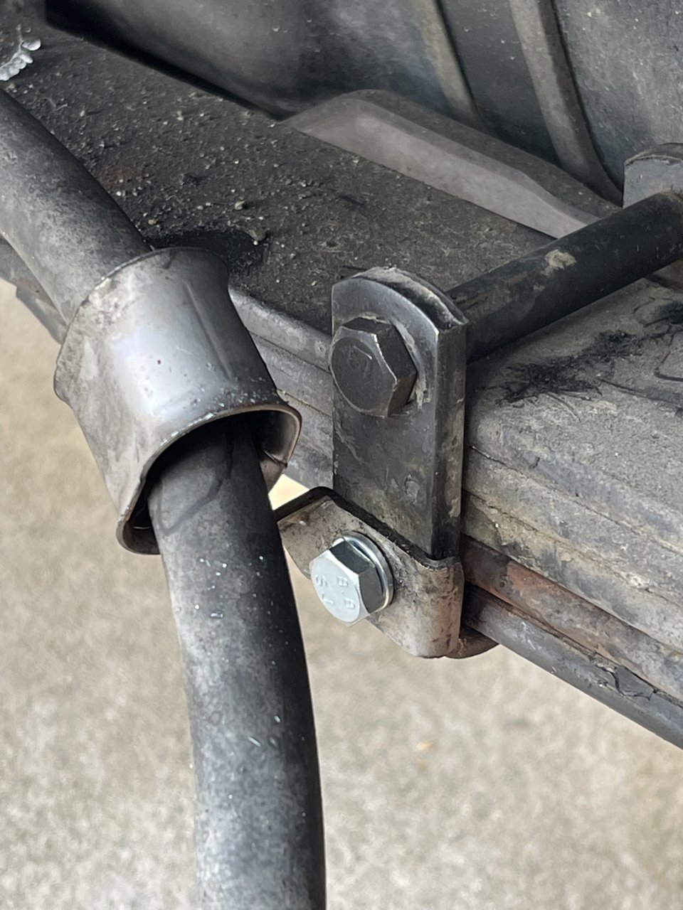

    Only real way to remount the factory bracket is to drill and tap. Cost less than $20 for a drill/tap set and bolts. I left mine just hanging for a a couple of years and ended up replacing the parking brake lines as it was rubbing against the leafs. Symptoms would be locking parking brakes from corrosion inside the line.

    That's some clean work man. What are the specs on your hardware to do that? Did you leave the leaf pack on or did you have to take it off and disassemble it?

    Leaf pack was left in, no need to remove. I used an M8-1.25 tap, bolts and lock washers. Super simple to do.

    What length of bolt did you use? I'm looking at doing this but don't want to go to deep and cut up the leaf springs.
