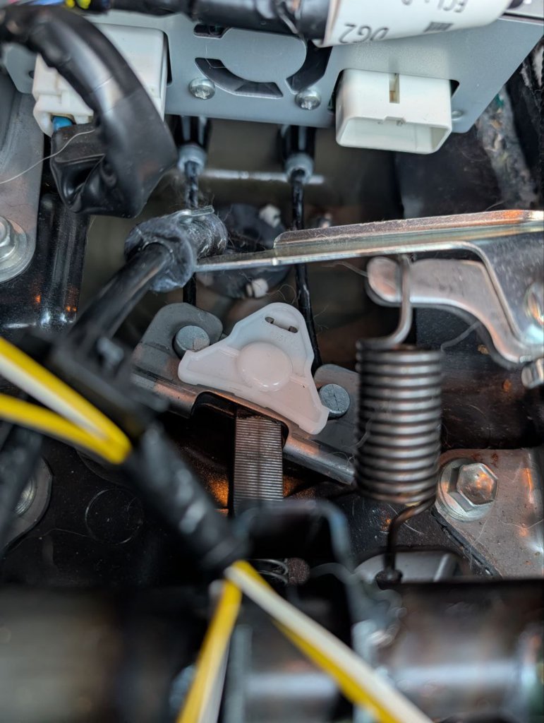

    It appears the e-brake is stuck engaged.
    I pulled the lever and towards the end it felt like something snapped/gave.
    Now, the first 1/3 of the lever is "loose" and brakes are definitely engaged.
    I did some searching and found some threads to pull the lever and reverse to disengage, this is not working.
    It also does not appear there are any accessible mechanical failure points (levers) outside the wheel hub or under the console.
    Any tips/tricks/advice on what I should focus on disassembling?

    Alright so I got the drums real nice and toasty forcing it up and down the road.
    Here is a video of the lever, its more like 2/3 of the lever is "limp".
    I don't see any obvious external failure points for the ebrake lever and cable.
    Maybe I should start at the drums and check the cable there, similar to this?
    https://www.youtube.com/shorts/wNxb8X8IPIg
    came across this thread... guess ill rip the console apart
    https://www.tacomaworld.com/threads/how-to-replace-rear-parking-brake-cables.799982/

    2017 Tacoma TRD OR
    After disassembling the console, it appears that the driver side brake cable is not retracting and causing the "slop" in the lever and keeping the brake engaged.
    I'm guessing this is going to be problematic trying to remove the drum.
    What are my options here, just cut the cable near the drum and hope it releases?
    Having a difficult time finding the part number for these cables, does anyone have them?

    My guess is cable itself failed after rust stopped movement of a section of the cable.

    yea im gonna park it and see if it magically fixes with a thaw.
    Seeing that its a plastic coated cable inside, I could see cold weather causing the materials to contract and cause friction.
    After reviewing the whole mechanism, it is so needlessly over engineered it literally can't be used.
