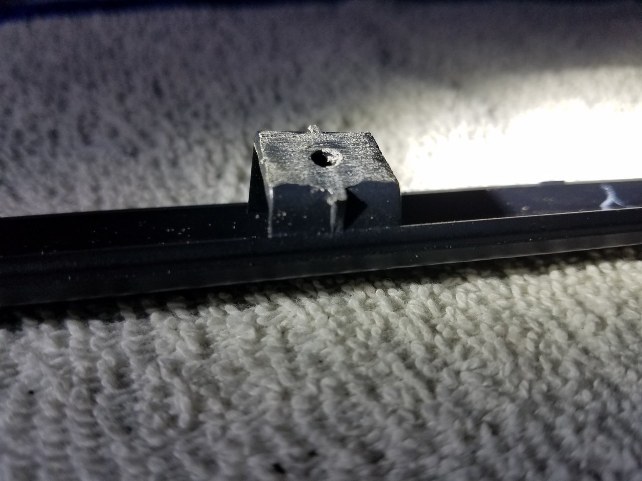

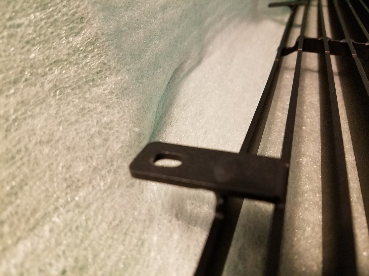

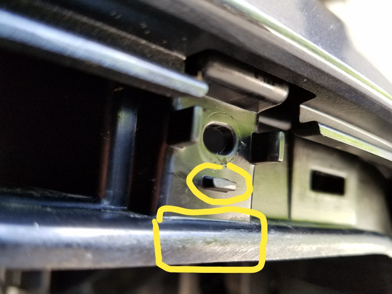

    I attempted to install a E&G Classics billet grill today on my 2017 and got stumped. The new grill has three tabs across the top that evidently are supposed to go between the outer surround shell and the bezel.
    Here's the back side of one of the tabs. It cannot sit flat against the surround unless these little sections circled in yellow are removed.
    However, even if I were to do that, the bezel will not sit as flush as it normally would because it will be spaced out from the shell by the thickness of the E&G tabs across the top only.
    Has anyone else installed one of these grills? What did you do?

    The instructions are actually quite detailed about everything else, but not this. In fact, there's no mention of trimming off tabs or cutting of any kind. As far as I can tell, if I don't do that, the top of the bezel will stick out a good 1/4" while the bottom would remain in the factory location.

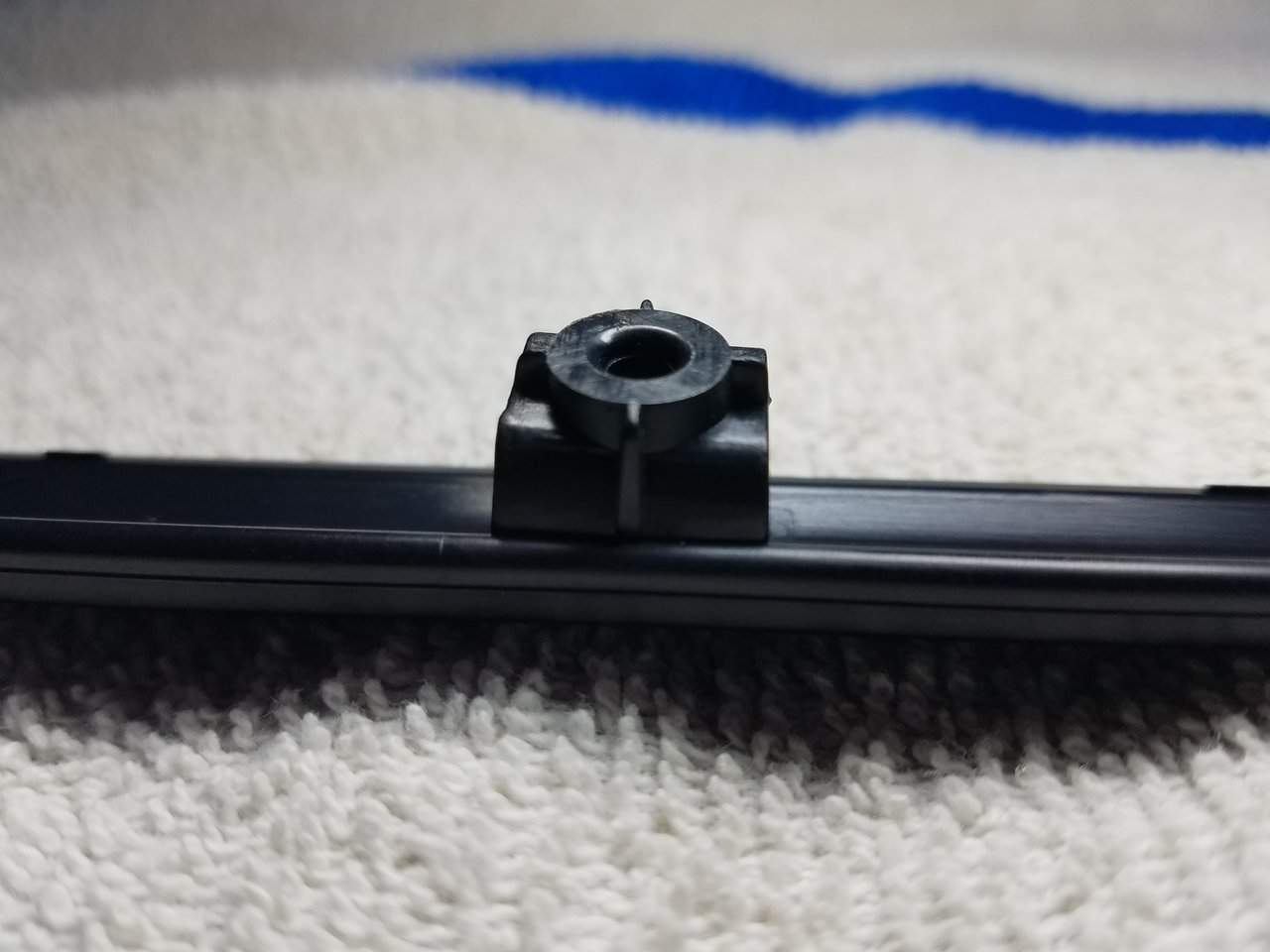

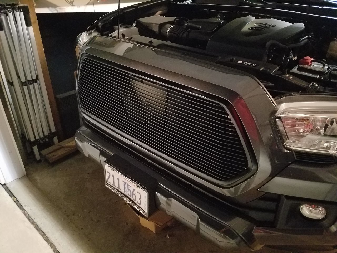

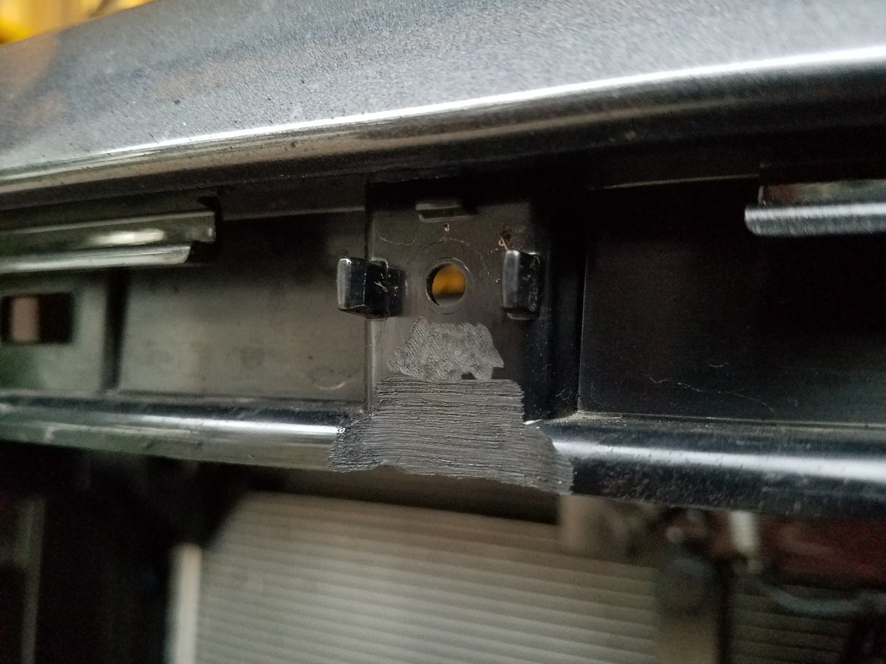

    I chatted with Lee at E&G and after explaining the situation he suggested using a Dremel to remove the offending plastic as shown in my original post. So I did that as well as shaved down the three mounting locations across the top of the bezel. Fits great now. Lee said he would talk to management about updating the directions.
