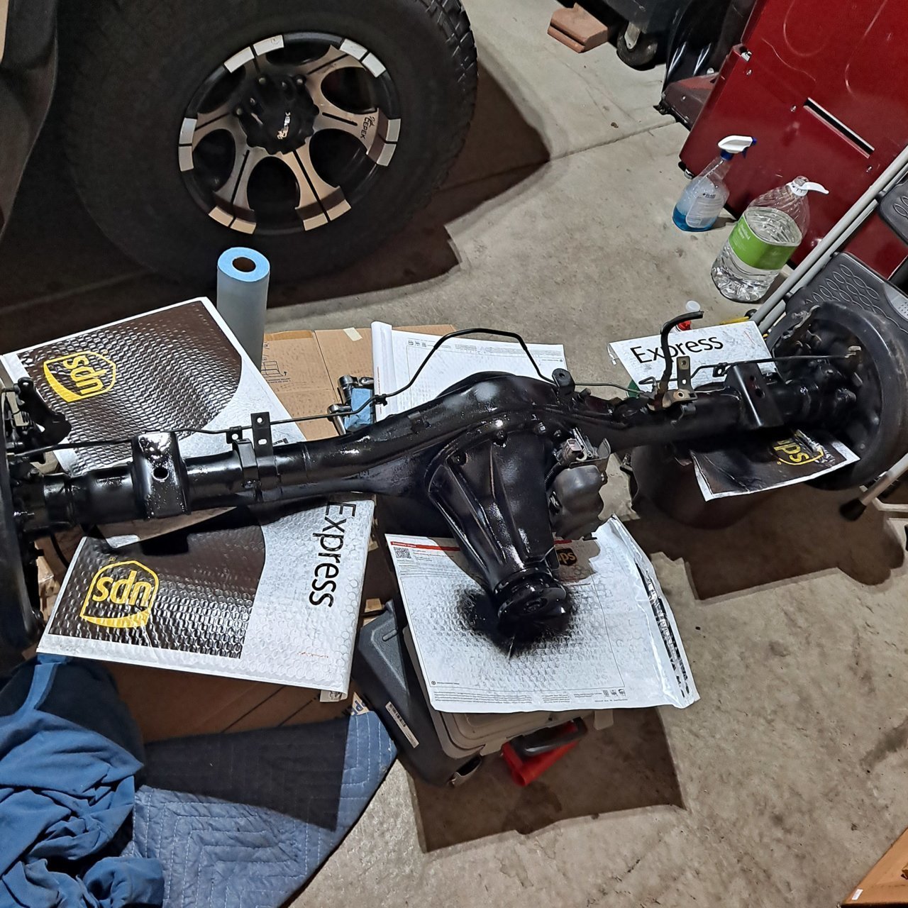

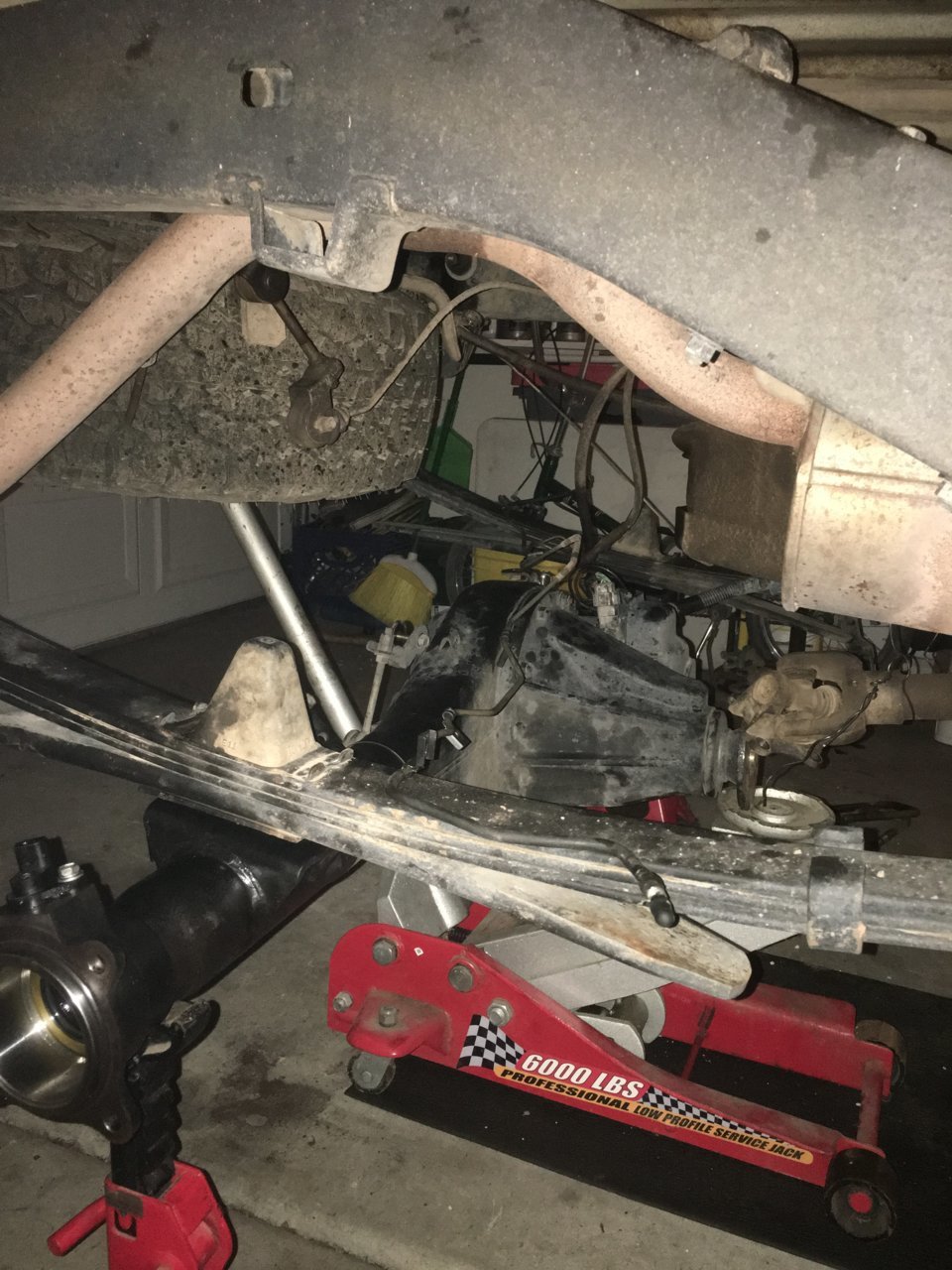

    I Recently swapped out my 95.5 axle for a 2,000 axle with a factory E-Locker.
    I got the 2,000 axle, with an E-Locker from my local junkyard. They only buy trucks from auctions, and they give a 6 month guarantee on their axles! All these plugs, plus the male harness coming from the diff, the E-Locker ECU, came with the axle.
    3C29A606-BF63-4811-96FB-9F3AA90A3366.jpg71F5912B-9B04-477D-B87C-EB1465791117.jpgD45CE9E4-EE8F-4009-A4ED-32C43E25F5E7.jpg

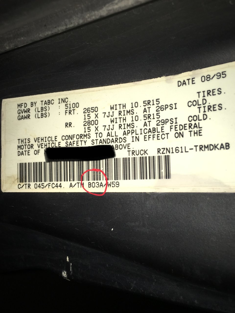

    Be sure to match the gear ratios using this code.
    The 2,000 axle bolted right up to my 1995.5 Tacoma. Edit: don’t use your old U-bolts, buy new ones. I paid $40 for new ones, don’t cheap out on this! Also make sure you tighten the U-bolt nuts evenly, and torque them to factory spec.

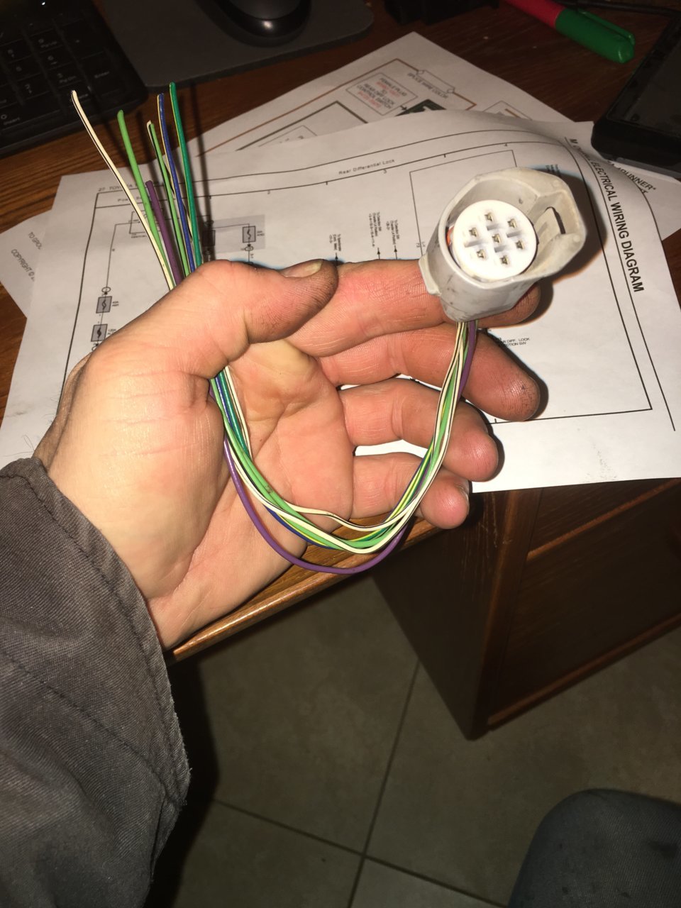

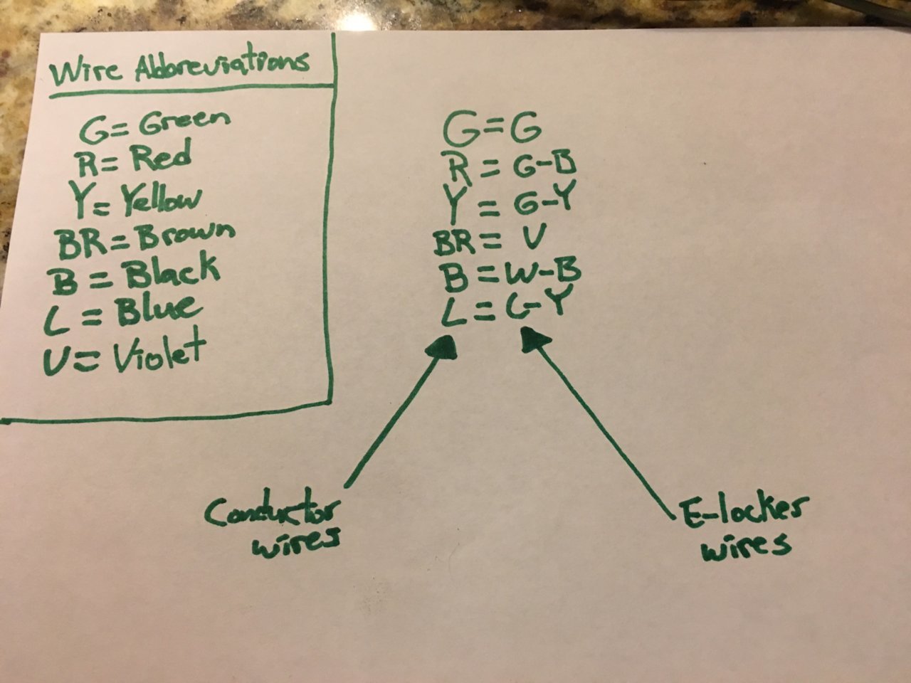

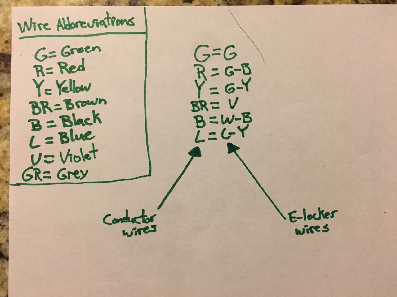

    The wiring was the most time consuming part of the swap.

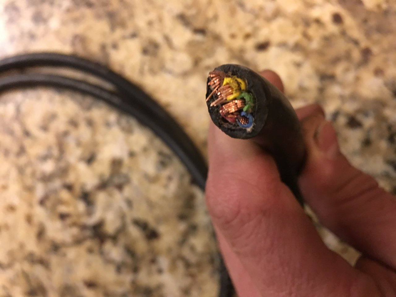

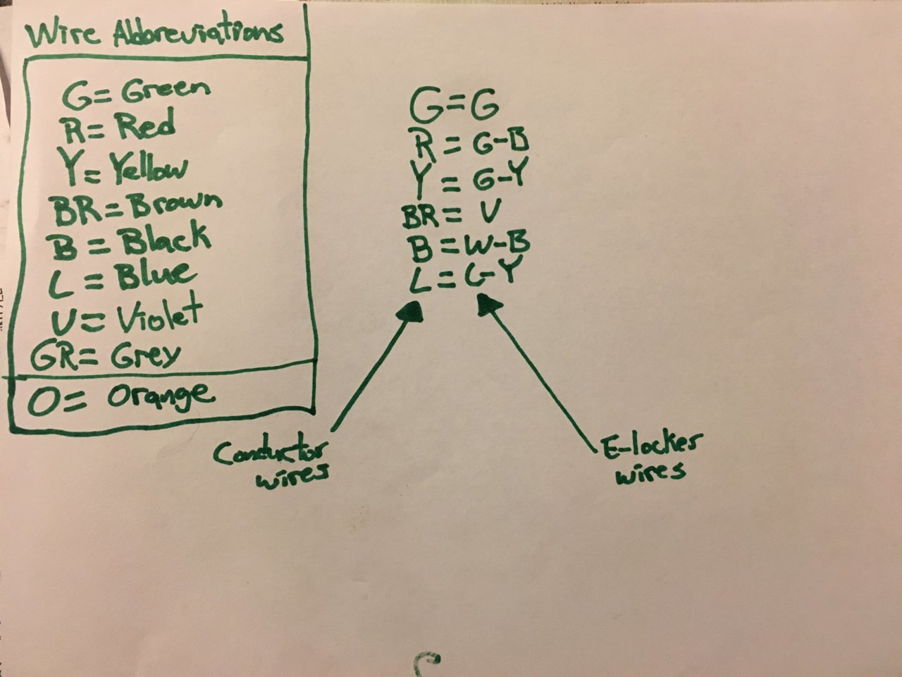

    I used a, 6 conductor, trailer wire to make the harness for my E-Locker.
    Next I assigned the wires I wanted to solder to the conductor wire. I chose black to be my ground, which connected to the White and Black wires coming from the e-locker.

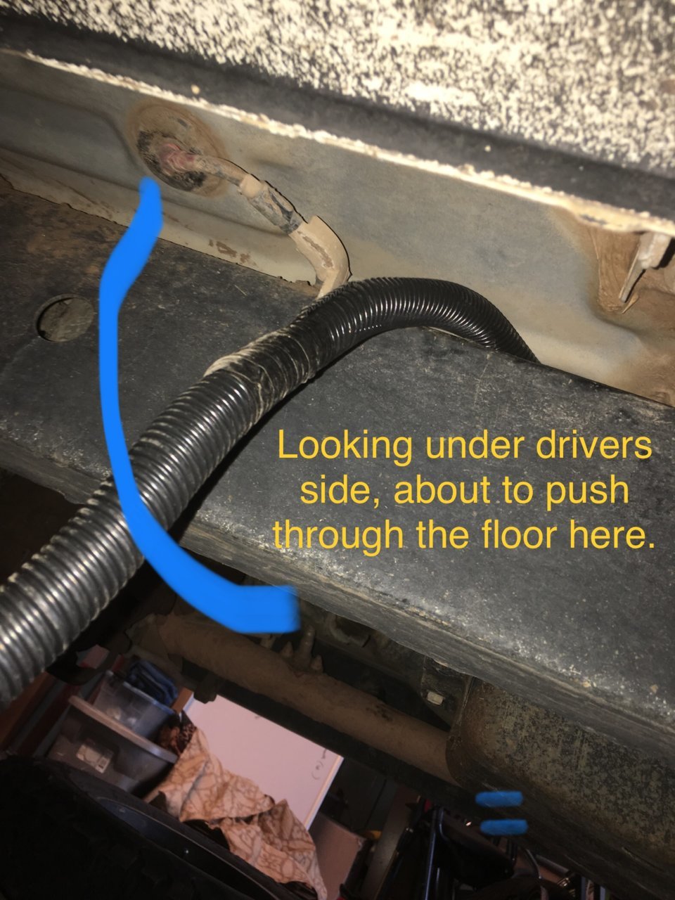

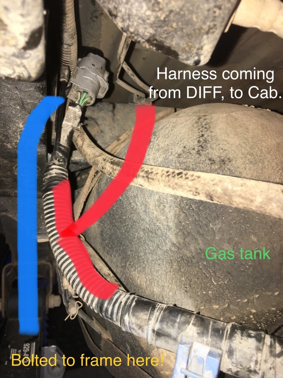

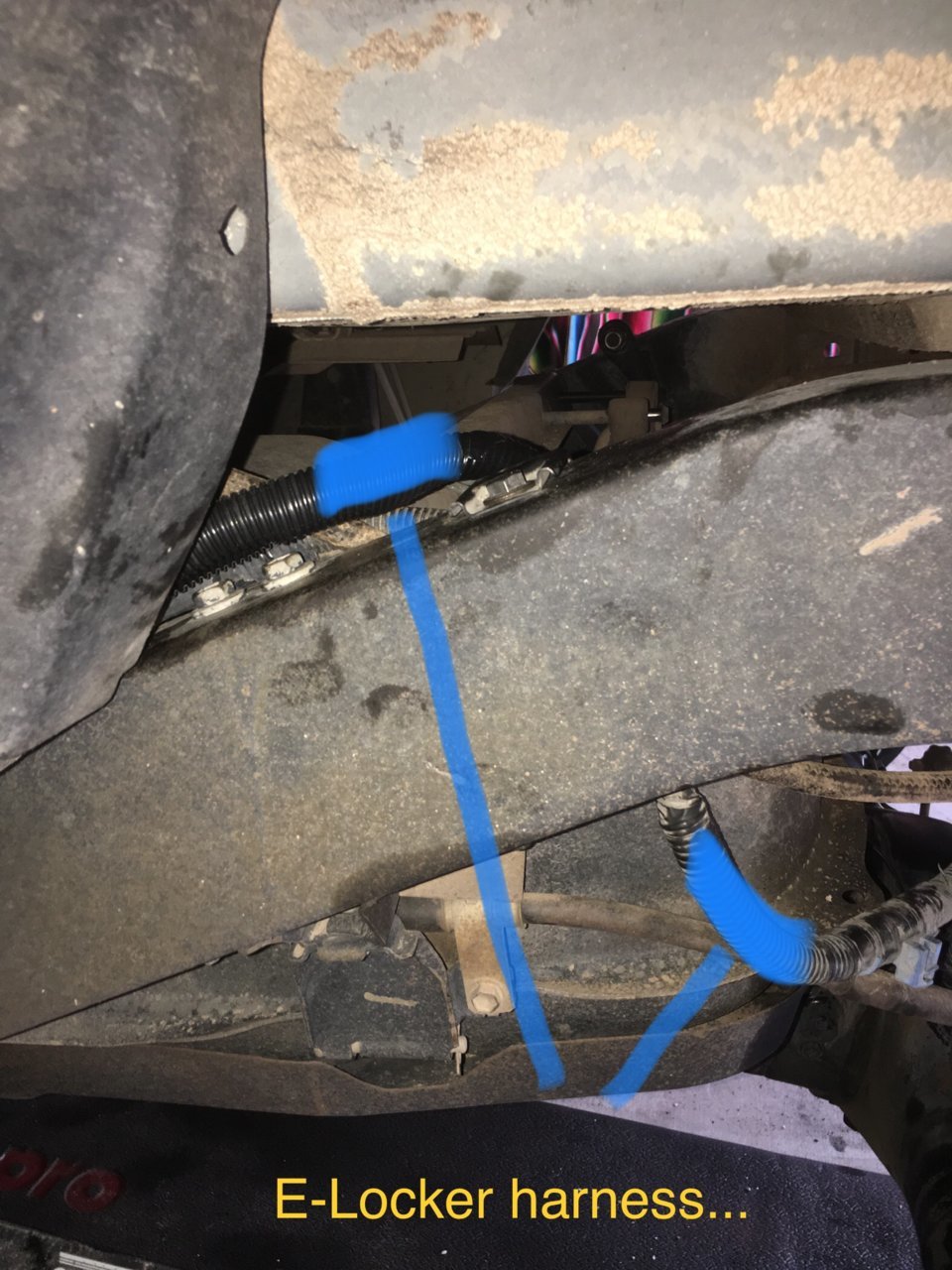

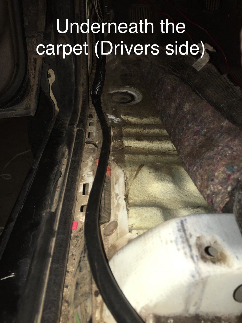

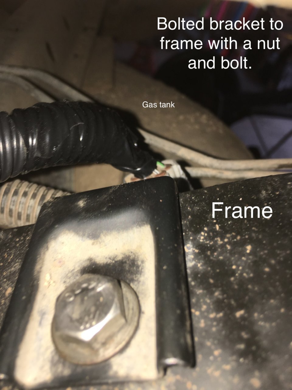

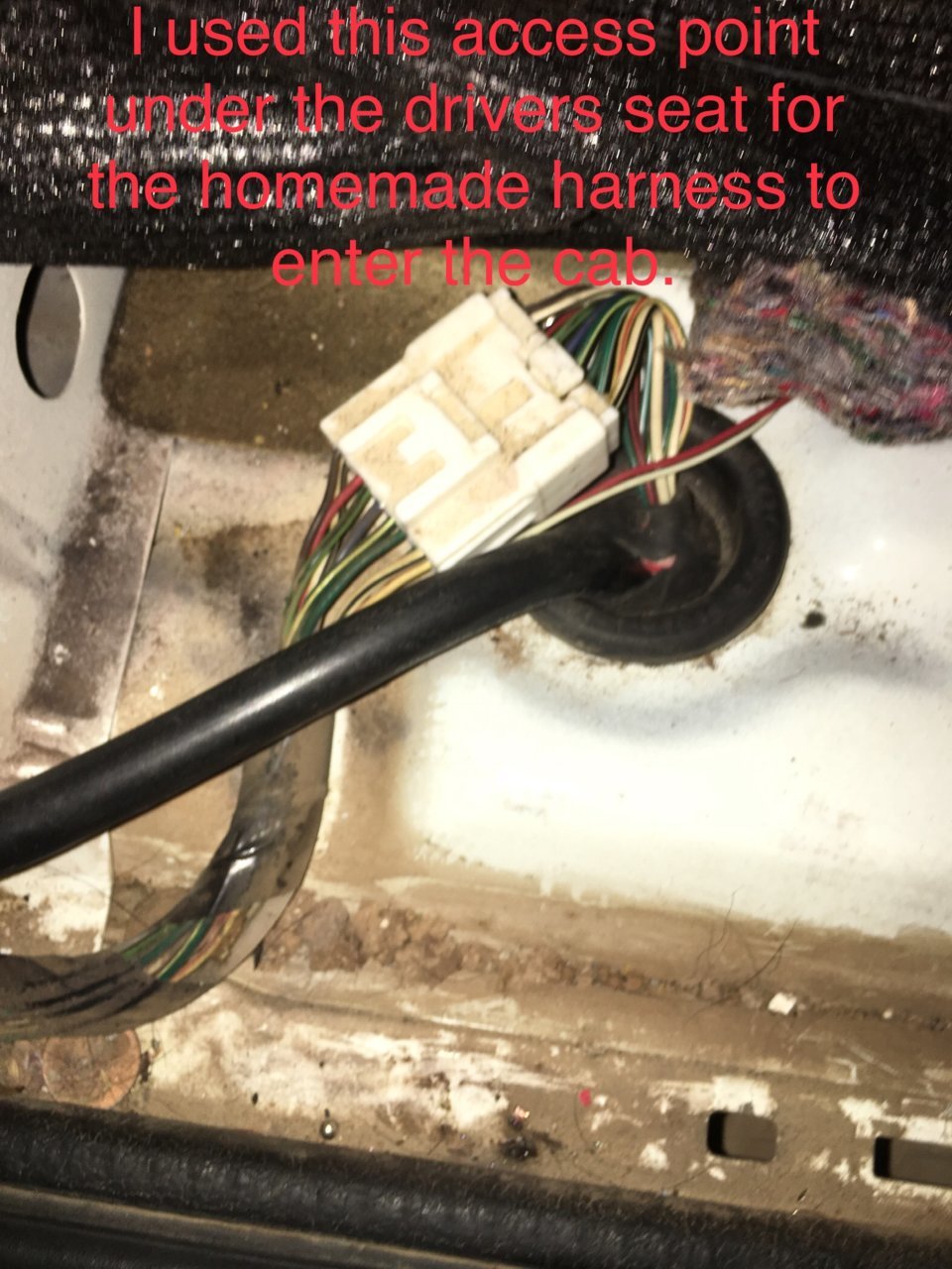

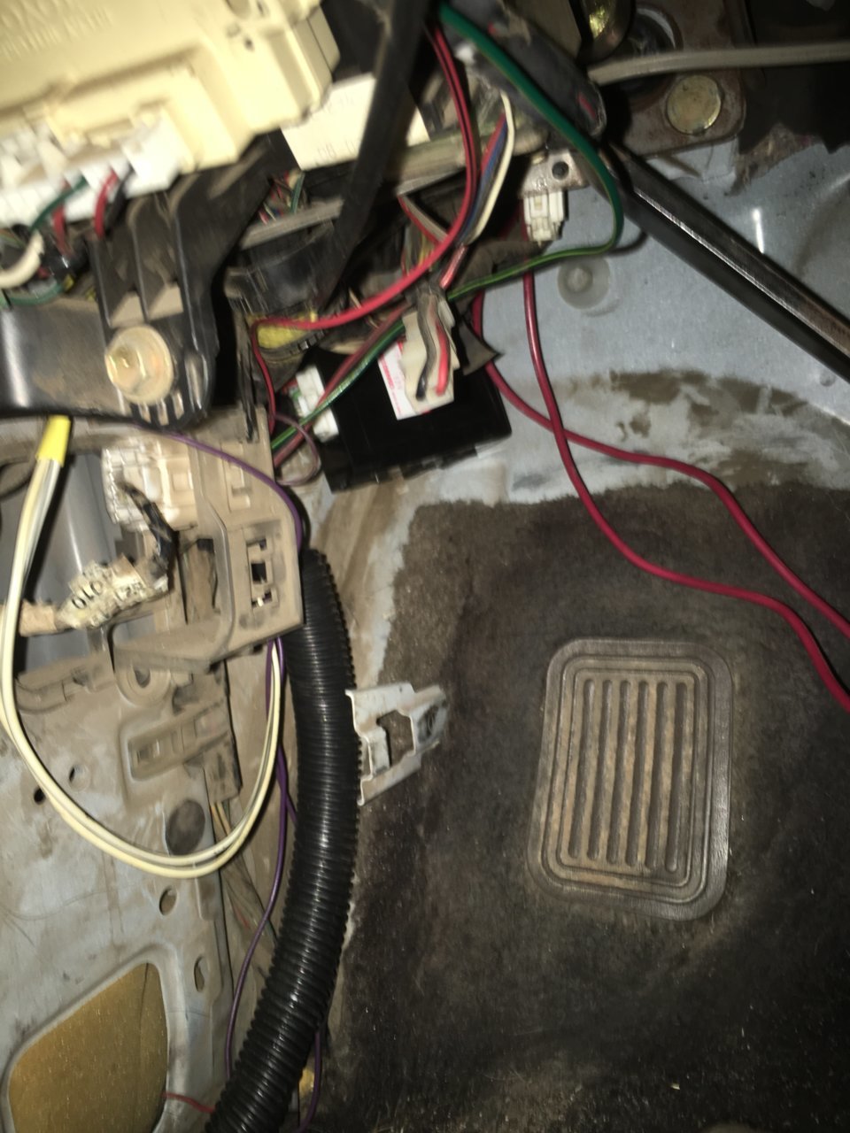

    Next I ran my new harness from the e-locker to the inside of the cab.
    E2CAEE1B-BA38-4661-8D85-55B774019020.jpg 48C4DCD9-E88F-473F-A089-5EF9398C5E38.jpg 7B1B749D-6274-4638-855D-0E42E60F59CD.jpg 8864AA53-74F9-4570-882B-FB235DE6A2FD.jpg 65E96A31-0937-409A-B40D-D053B230456A.jpg 79B8EE45-D7B1-4D74-9BEA-9F1735847AFC.jpg 89BC3F53-A6CF-4CD2-ACB7-8300D91839ED.jpg

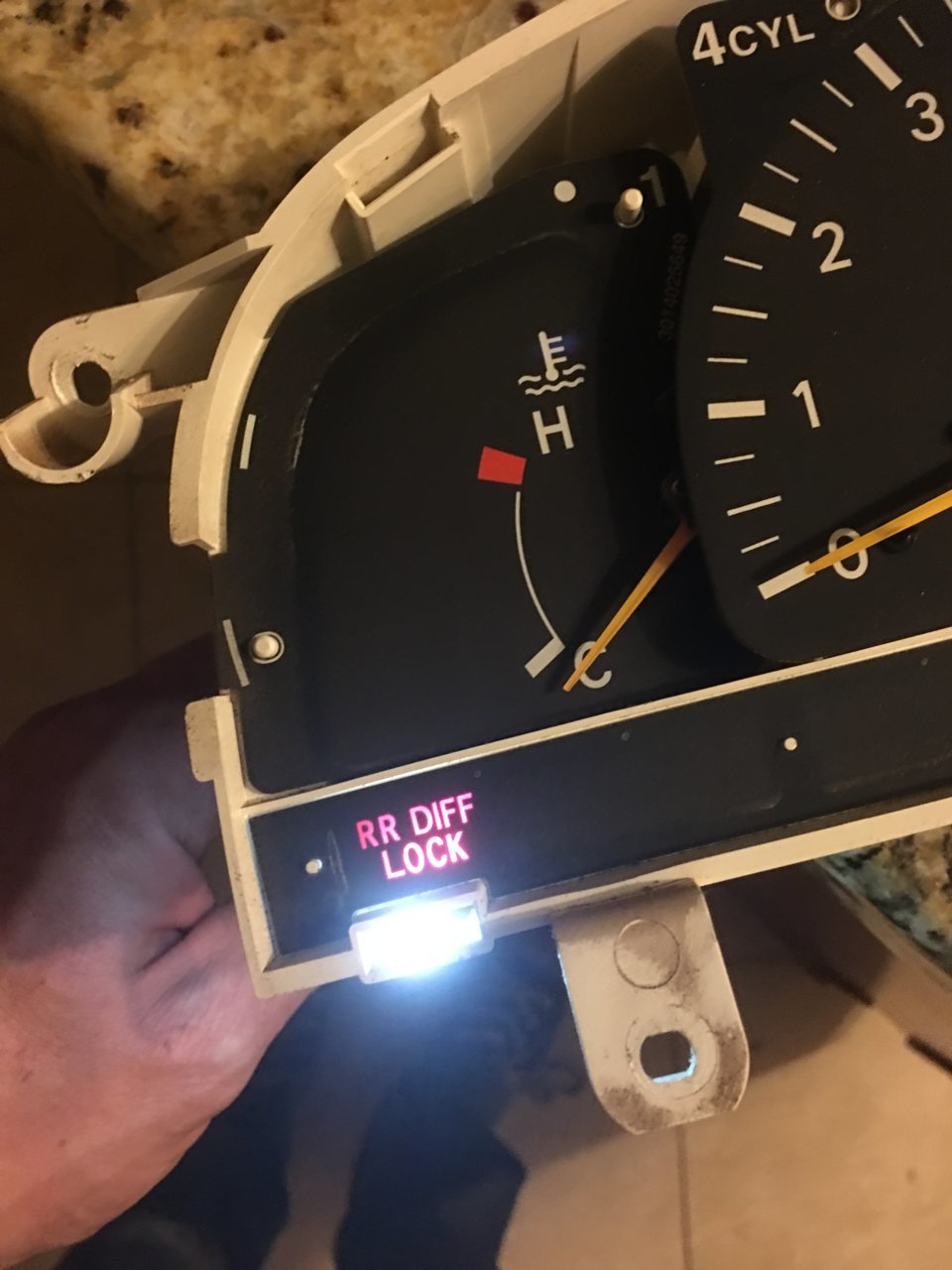

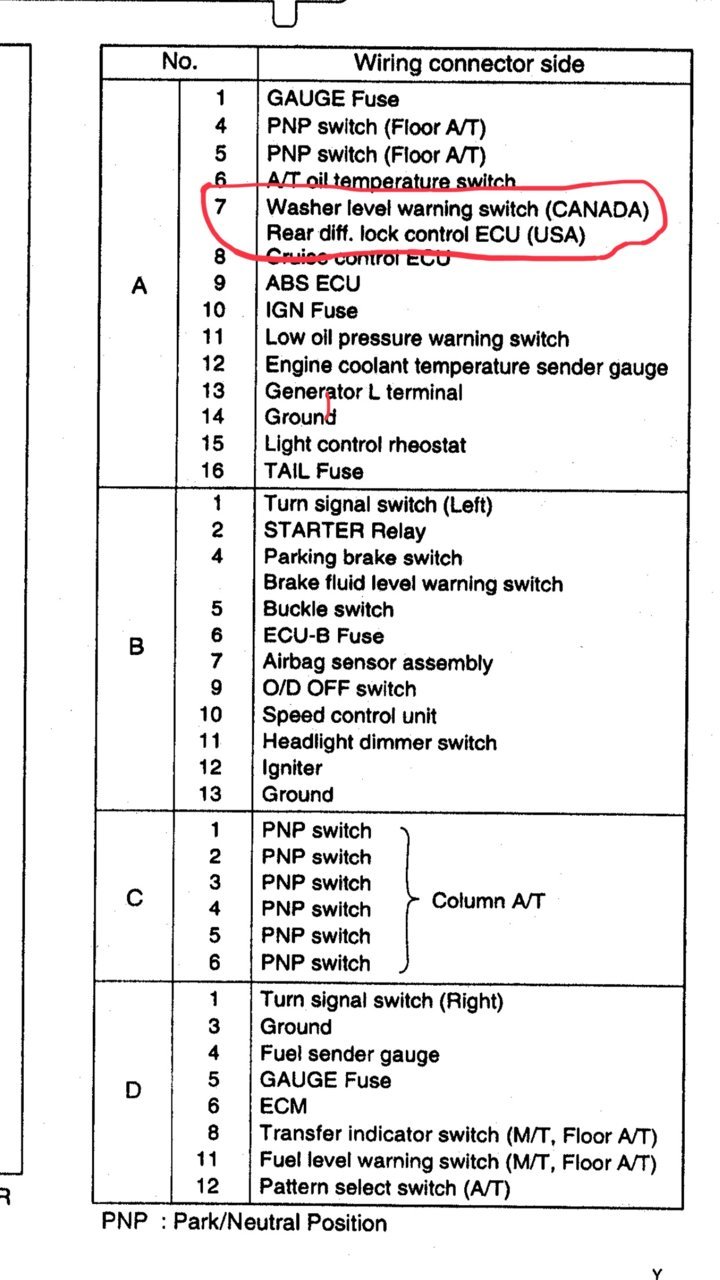

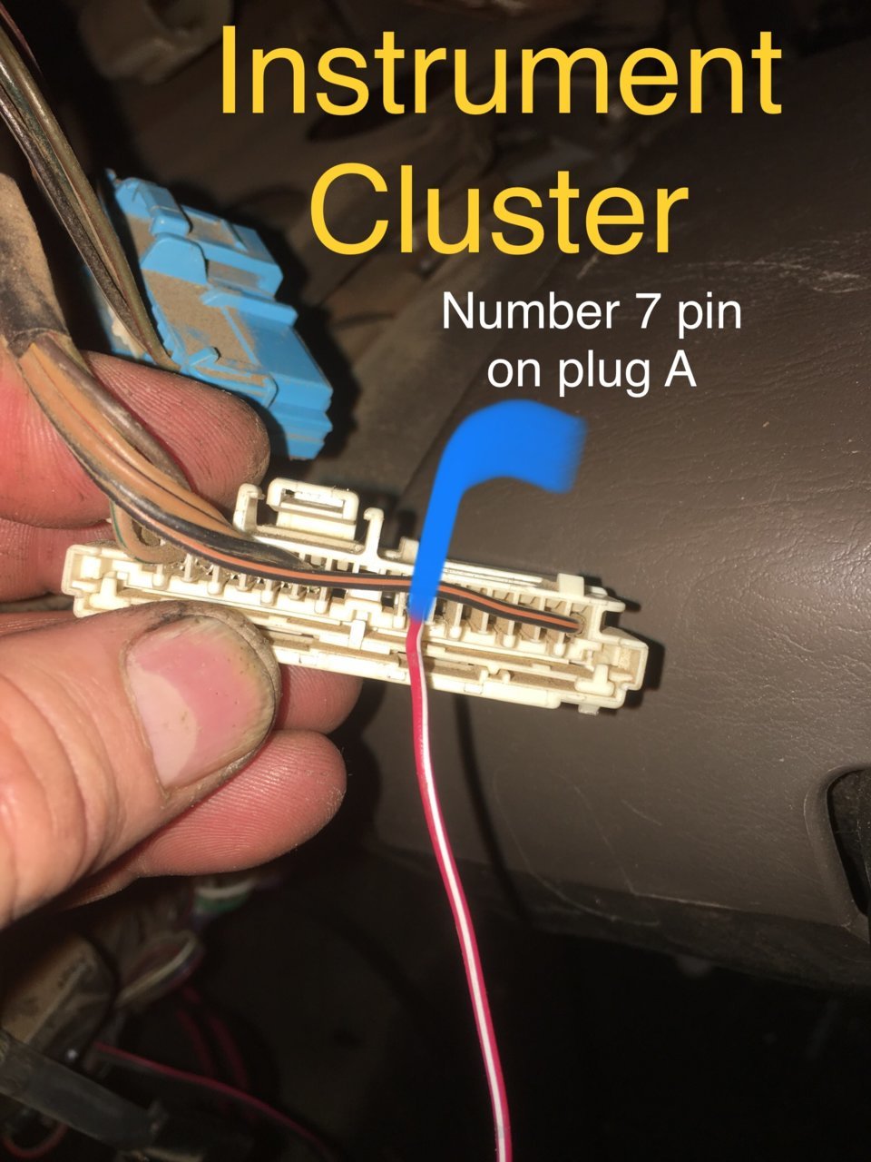

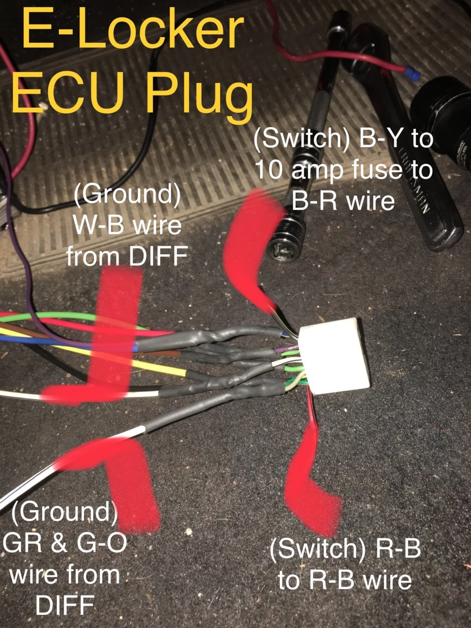

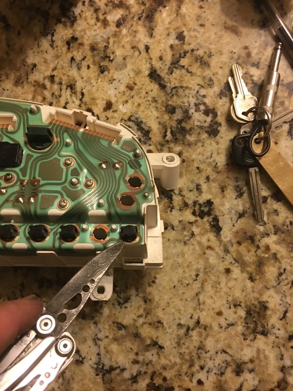

    After that I soldered up the other end of the harness going to the 4x4 ECU.

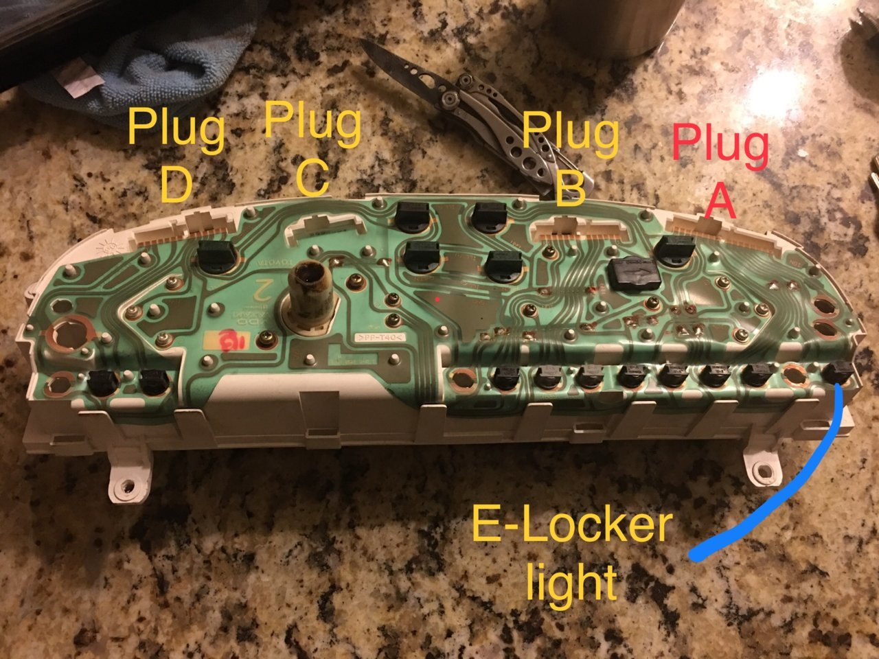

    The L-Y wire on this 4x4 ECU plug connects to the instrument cluster, 4x4 ECU, and the E-Locker. Just splice the wire in and run it to the cluster. You have to buy a replacement pin from the dealer. The new pin plugs into PIN 7 on Plug A.
    5BFB703D-8D2F-4318-B7D5-301EF7696327.jpg A536B76E-B0B9-4D7D-BE45-082BE520BD6A.jpg 2A01CC4D-A8D5-4611-8CFF-B80C74BCF887.jpg B04B04E6-2BE2-4B50-8C08-25196AF0CC6F.jpg

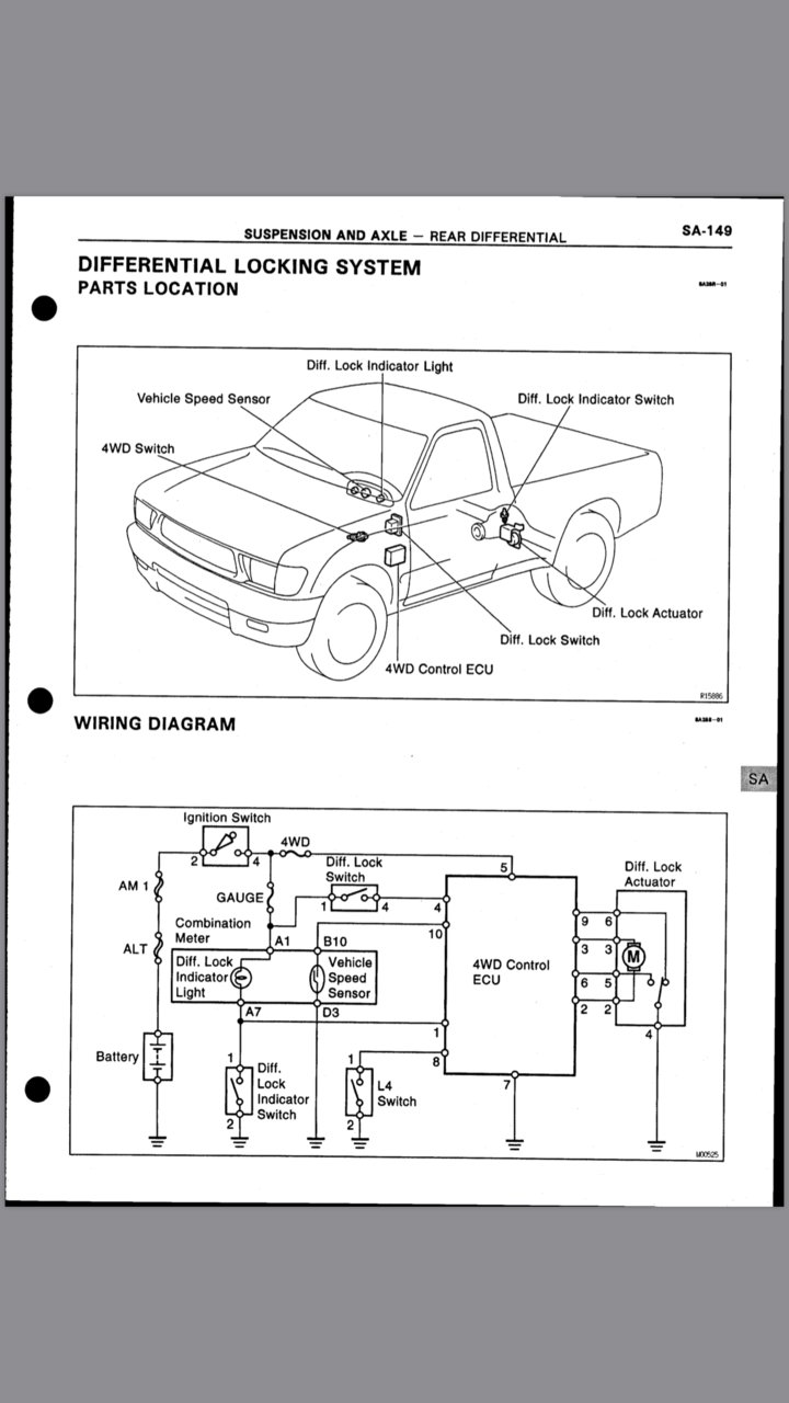

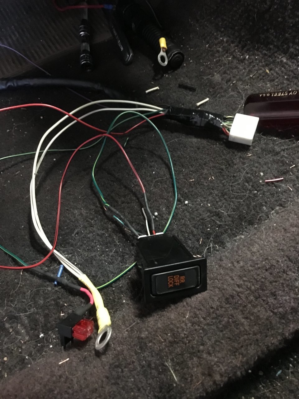

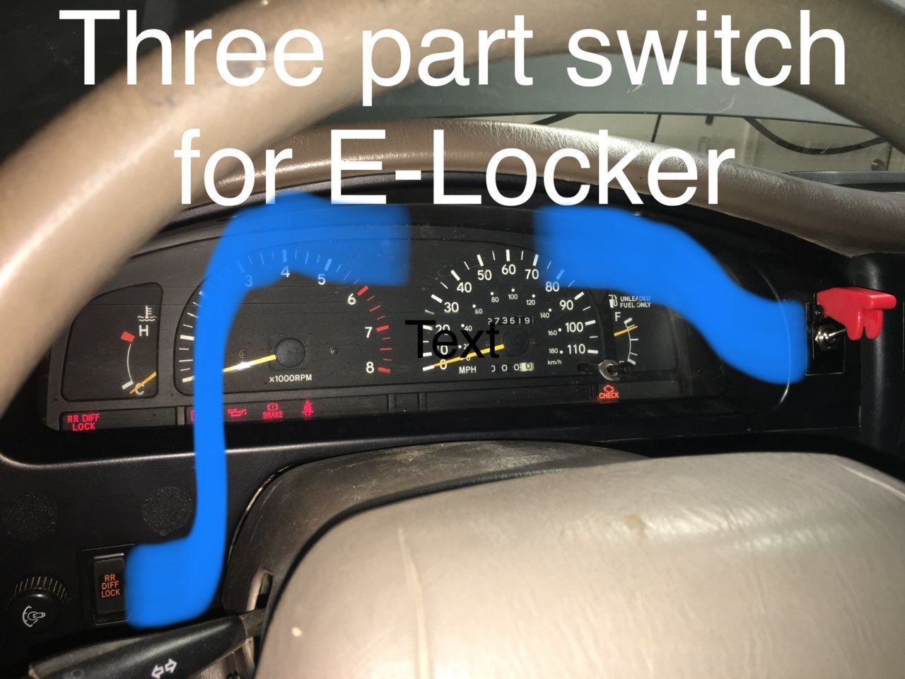

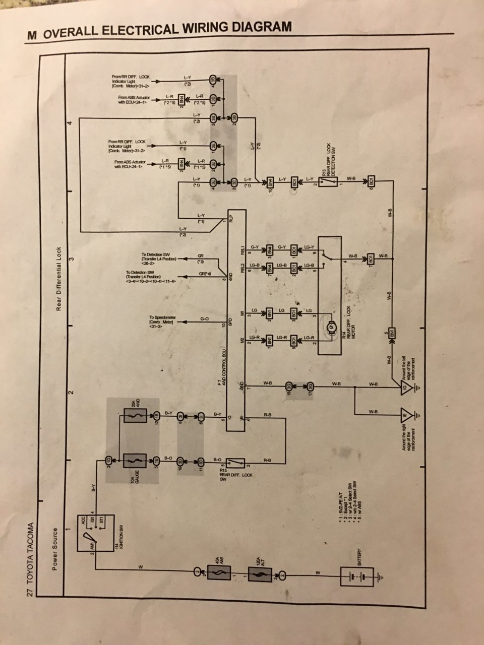

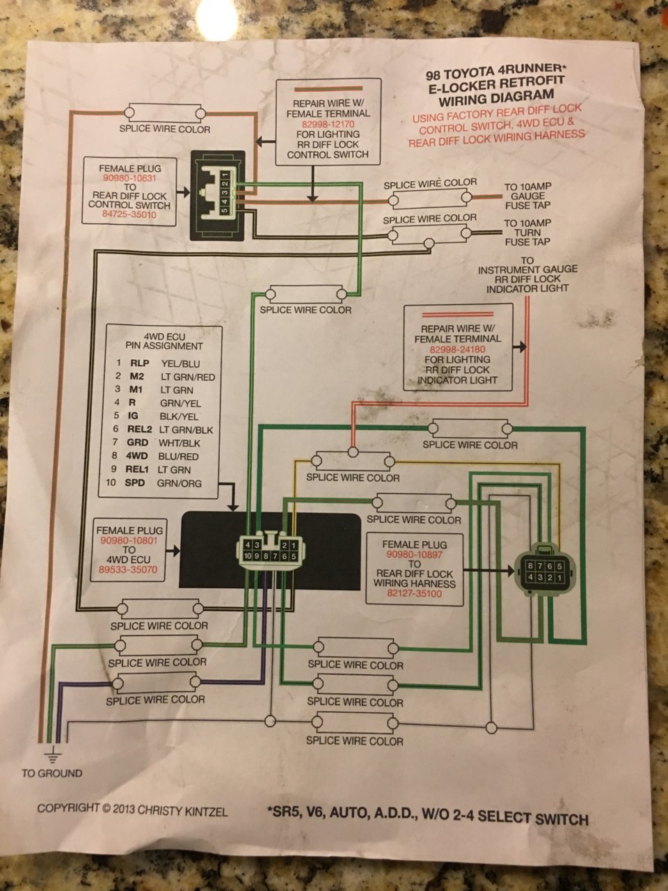

    For the oem E-Locker switch take another look at this picture.
    The GR wire, when connected, prohibits the e-locker from engaging in 2wd and 4 high, and the G-O wire is the 5mph safety feature. I grounded both wires.

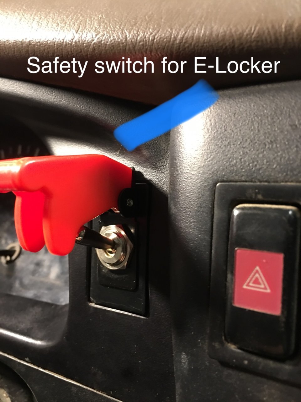

    I did want the 5mph safety feature but I couldn’t apply it to my truck, so I made a safety switch.
    I just interrupted the oem switch and put this guy in! Now I have to flip the safety switch cover, flip the switch, and then press the oem switch!
    I might change the style of the safety switch because I fear when on a ruff dirt road the red cover might fall and disengage my e-locker prematurely.
    Here is all the info I gathered online for this job.
    16B7B5B9-C6AA-45E9-8B88-EF6FA81AE772.jpg E283AC2E-96C8-4A1E-836A-8376CF47261A.jpg EBEA9DD0-CEE1-424B-AF66-8BB1528924CE.jpg EFFFEB6B-3071-487D-90A1-9753EF583EFA.jpg

    Honestly, I couldn’t tell you. My 95 Tacoma didn’t have the ECU or switch. I had to acquire those from a junkyard and fabricate a wiring harness.
    Just a thought, look at the ECU and see if it has a missing plug. If there is nothing missing, trace the wires, from the ECU, to the rear of your truck. Check to see if there is a round plug, above the diff, that would plug into the e-locker. If there is an empty spot, on the ECU for a plug, you’ll have to fabricate a harness. Or try and find a harness at a junkyard.
    Give the video I posted a watch and get a wiring diagram for your truck. Good luck!

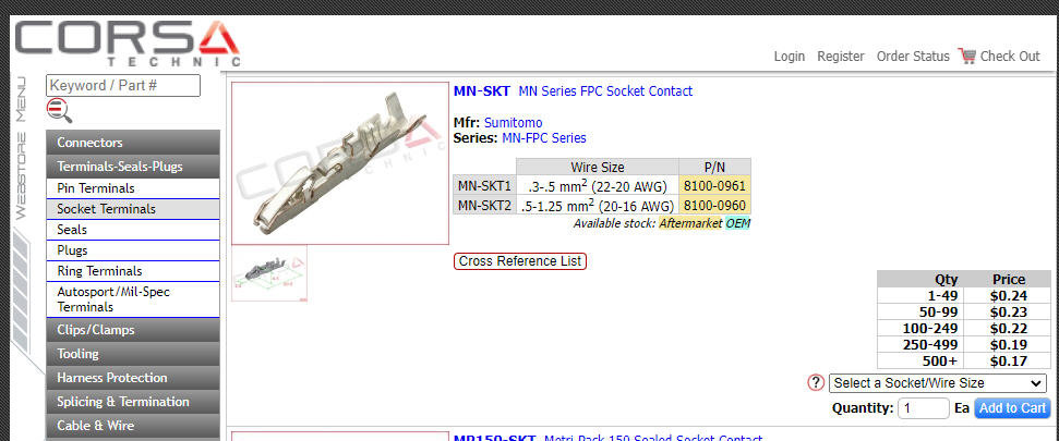

    I'm in the process of doing this job now. Thanks to the OP @Falkor1 for this post. It has been helpful as I'm learning my way through this swap on my '98 Tacoma.
    Rather than going to the dealership, I think you can order the terminal socket contact MN-SKT1 from Corsa Technic...at least that's what I've found should work to make the speedo L-Y wire connection on 7D. Then this wire should go to junction block 3E1, or I suppose directly to the 4WD ECU (which would also be spliced to the L-Y wire coming from the RR Diff Lock Detection Switch). If you don't have the right crimp tool like me, it can be tricky. But a basic crimp tool/needle nose pliers and some solder should do the job just fine.
    Best.

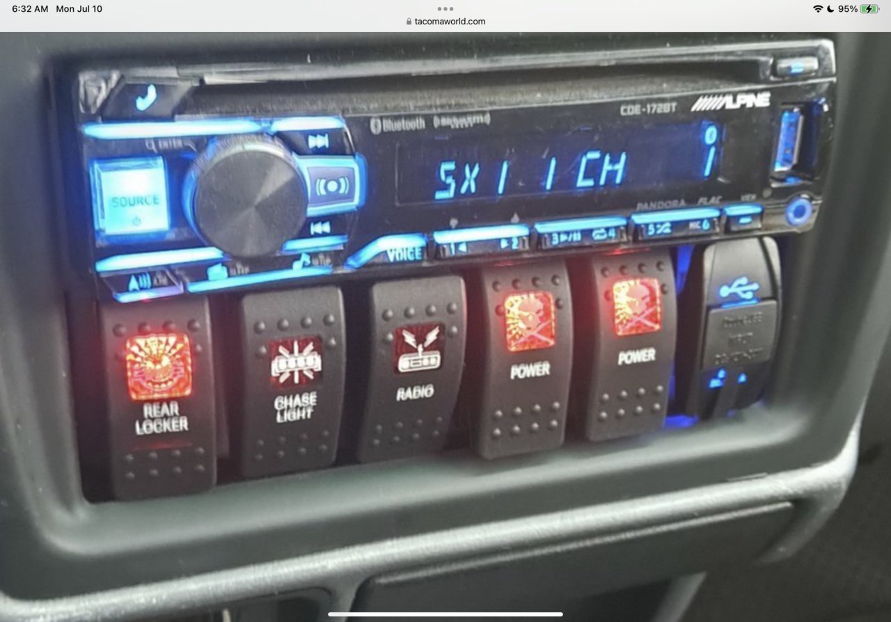

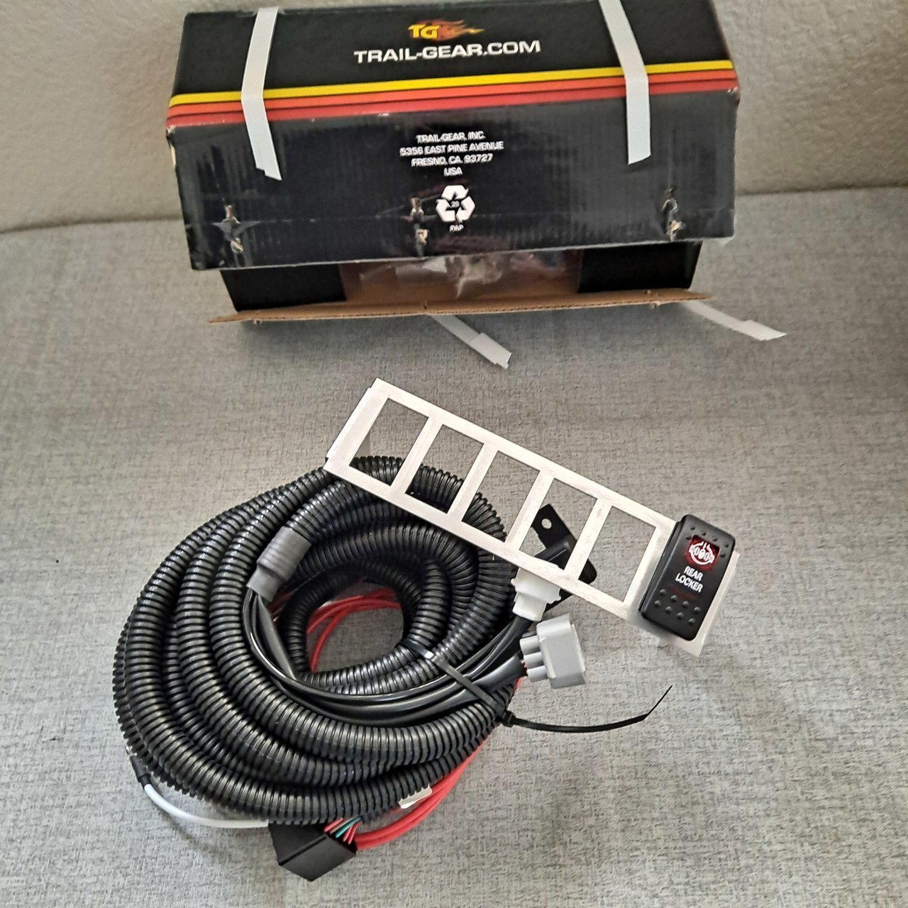

    Trail gear makes a wire harness with switch that’s plug a play that I used.
    Super simple and added the lower pocket switch holders.
    Badknees likes this.

    Nice! And I like your added control switches. I assume T.G. E-lock switch/harness is a direct connection and doesn't go through the Toyota 4WD control box with interlocks for low speed and 4x4 selection?

    Correct,
    Trail gear is stand alone,
    plug and play, very easy,
    Locker works in 4 HI, 4 LOW, 2 HIGH. Any speed
