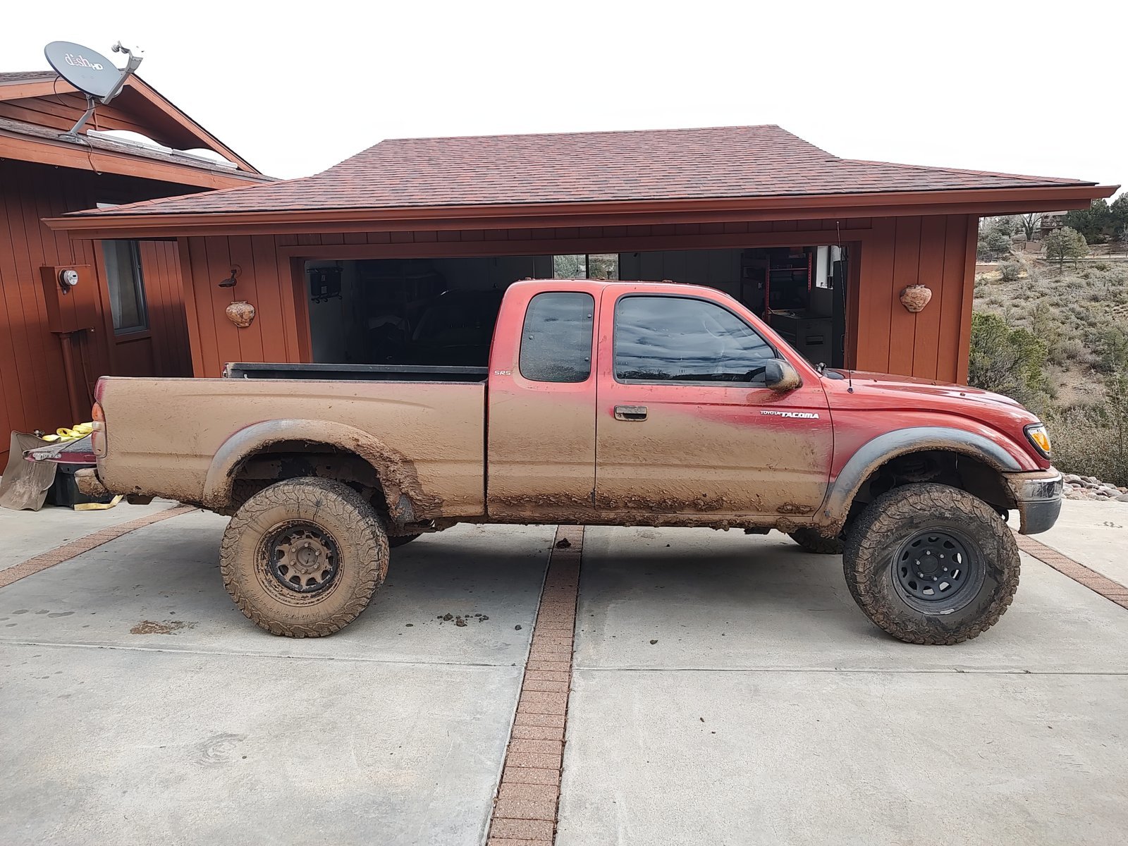

    Pic of "Dorothy" who's about to get just a little more bad to the bone :thumbsup::

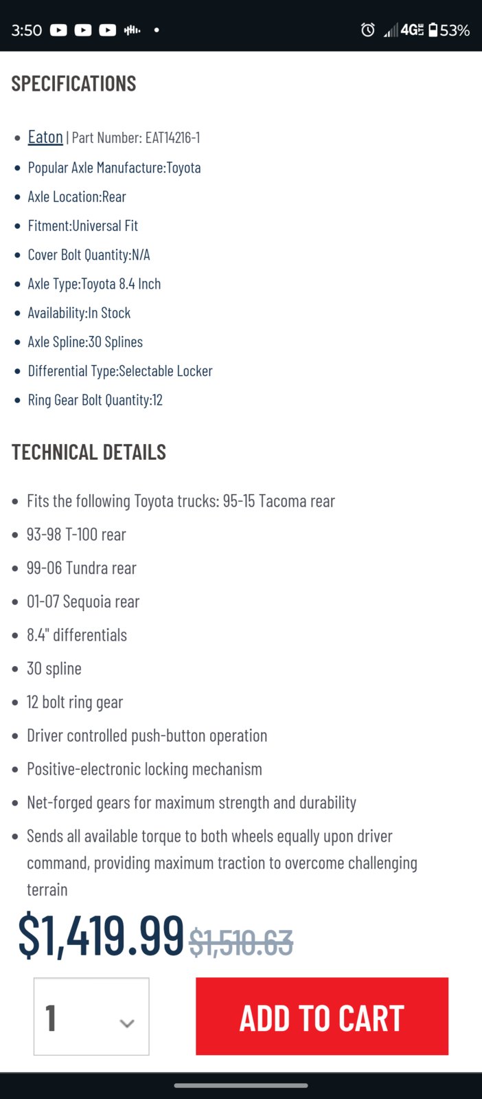

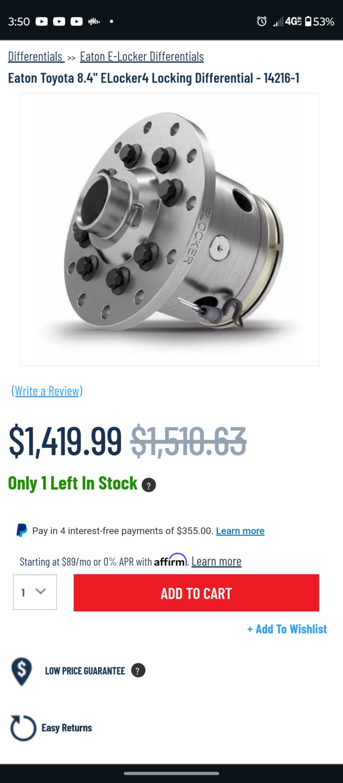

    So I'm looking at 4wheelparts.com, and this locker seems to be the one I'd want. Am I correct that this is the right locker for an 8.4", 4.10 Toyota rear axle?

    Yup that's the one. You're going to reuse your ring and pinion so you'll still have your 4.10 gearing.

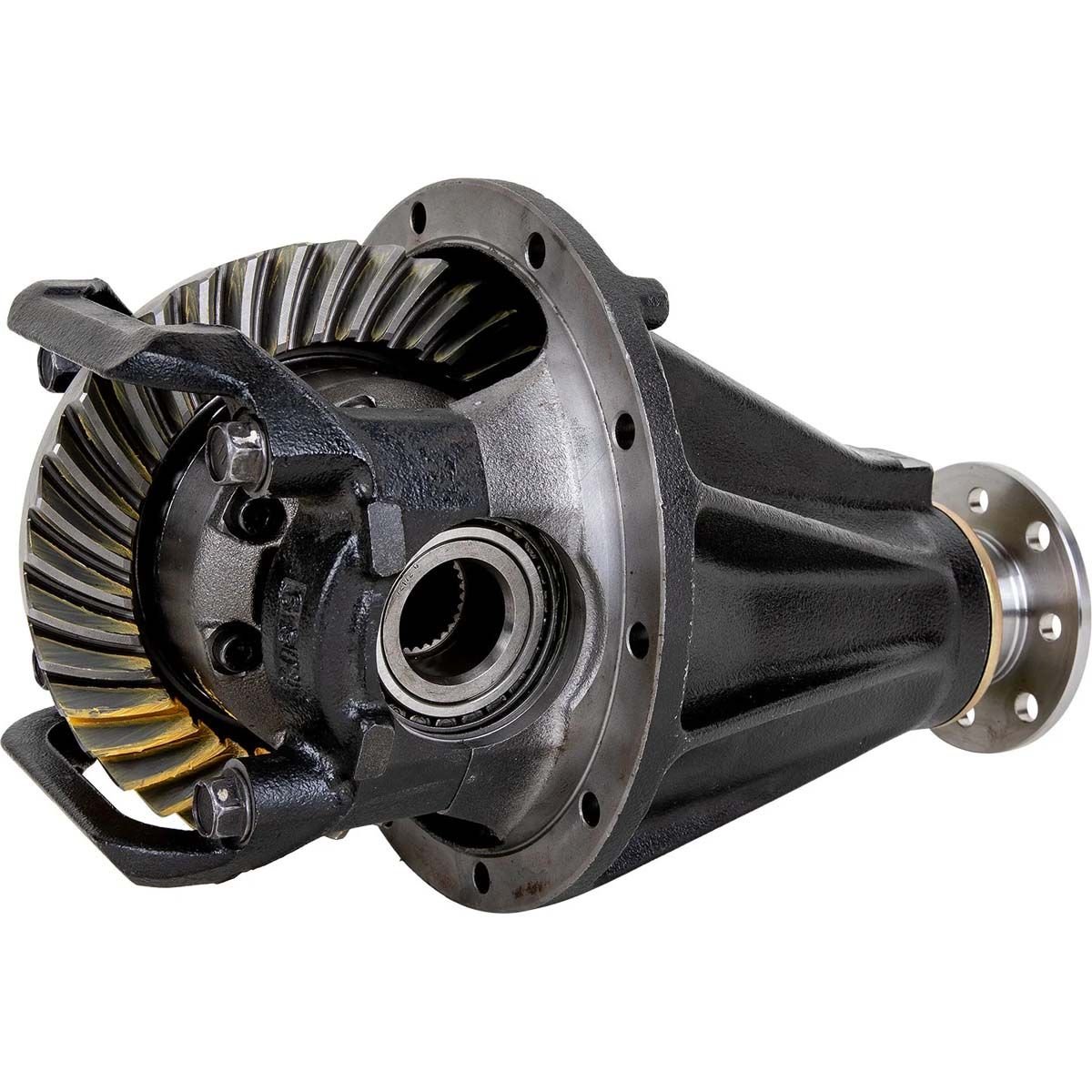

    Gear & Axle mechanic here. 100% go for the Eaton in your 8.4. The 8.4 is way stronger than that 8.0 OEM. One of the key benefits is that the caps on the differential are joined, kind of like a cradle. That reinforces the whole thing and I have personally seen these things go way further than the 8.0
