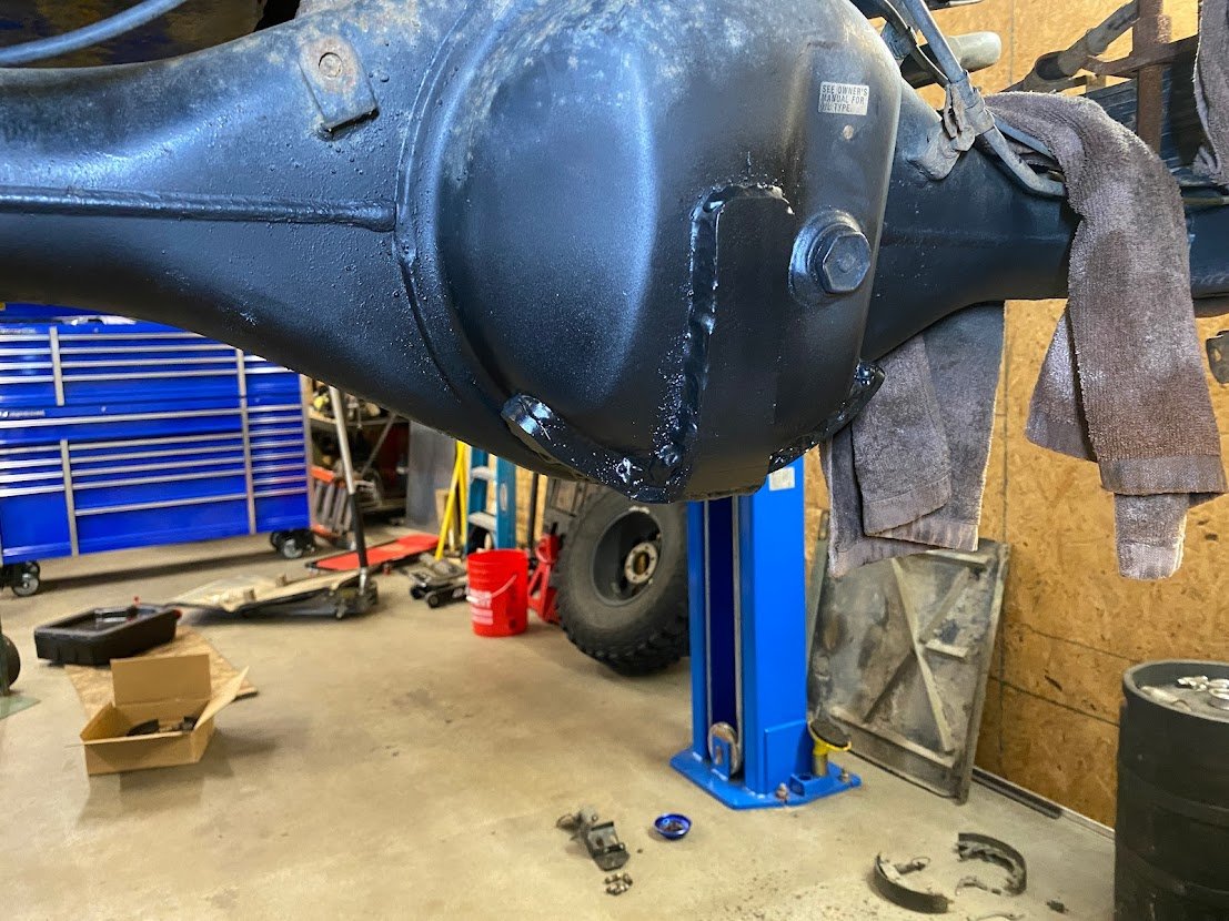

    Here is the guard I have, I think it's a Merlin one but not sure

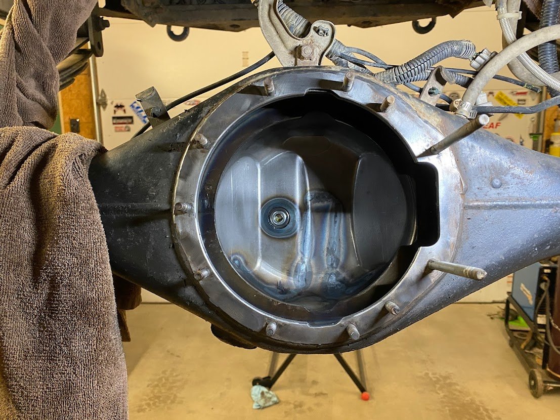

    Sometimes a line with a large rock is unavoidable. I like the strip on the back of the housing to prevent from backing up into a large boulder or something, that housing is pretty thin and if it gets dented the ring gear will hit it and destroy your gears.

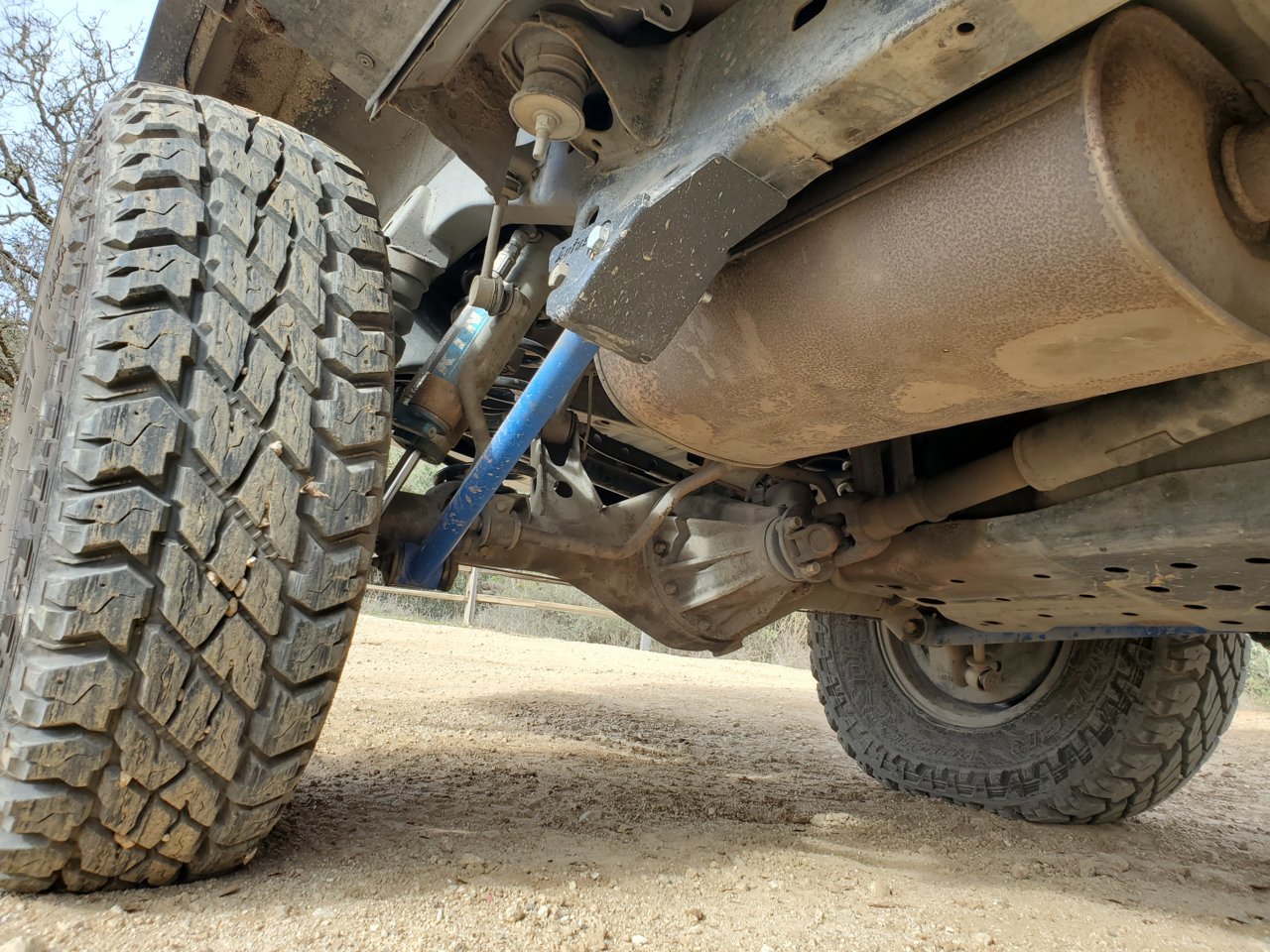

    I bang up my control arm skids when hitting some rocky trails/obstacles, but that's because I'm intentionally putting my wheels over a rock.
    The mounting points hang lower than the diff.

    The rear control arm mounts -
