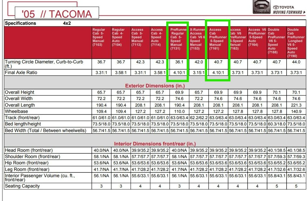

    I think we were both wrong:

    4.10 elocker from a 1st gen taco or 3rd gen 4runner will go in a second gen elocker axle housing is what i was saying.

    the 4.10's you circled are 5 speed manual, so from a 4cyl.
