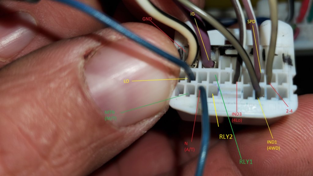

    Need to access the 4wd ECU and check RLY1 (Connector F12 Pin 13 (Pink)) and RLY2 (Connector F12 Pin 21 (Light Green/Black)).
    You will need to be back-probed and ready with your meter when you turn the key on as the circuits only stay active for a few seconds.
    With the actuator plugged in and in the unlocked position RLY1 should be 0v and RLY2 should be 5v.
    https://www.tacomaworld.com/threads/4wd-system-operation-help-thread.742420/

    Well if I did this right I have 11.35 on both wires and it stays 11.35 doesn't shut off.

    Grounded to the dash reinforcement bar and the green wire with black stripe and pink wire with blue stripe (only pink wire in there)

    Hold on after looking at your picture my colors are different I have another green and black but the pink is red

    I think you were on DL1 and ADD, RLY1 and RLY2 are on the other connector pictured above.

    Alright after testing the other green and black and red and blue(didn't see the blue) I get 11.45 on the red and blue and negative numbers (I would read that as zero on the green and black. This is the plug closest to the front of the truck.

    Your on Connector F13, you need to be on Connector F12. There is no Red/Blue wire on F12
